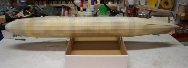

I have re-traced the vertical sections with a pencil.
Now I have dabbed and rubbed on some dry pastel chalk with a dry foam sponge.  I mixed some dark brown and olive green with traces of dark yellow.  Also dry fitted the vertical fins for a test fit.
port side
starboard side
Here is a shot of the bottom.  I used more heavier colors since it would be in a shadow.
I think the hull is mostly done.  I may do some more weathering and streaking with oils later.  Next will be fitting the fins and other details.

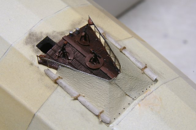

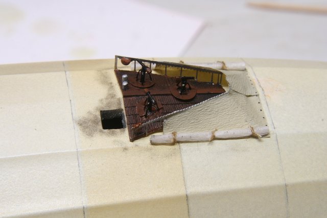

I have scratch built the gunner's platform for the top of the zep.  The platform is made from styrene and the planks were scratched in with a hobby knife.  Painted then an oil wash brought out the detail.  The railing and circular platforms are PE from the parts box and the canvas is tissue paper sprayed with lacquer to stiffen and strengthen it.
Now it's time move to the bottom for attachment of more parts.
Thanks for looking.
