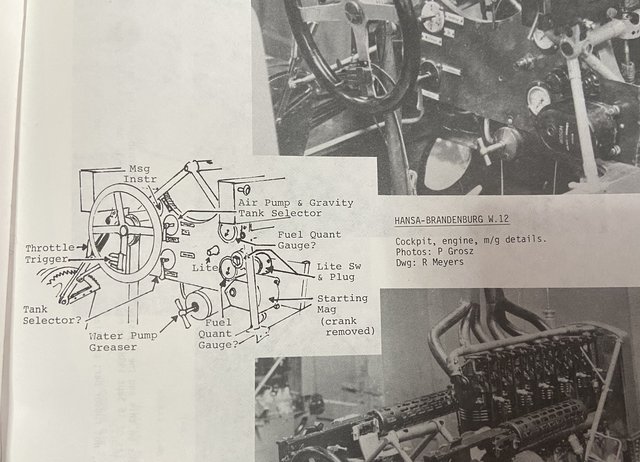

Back in 1991 Peter Grosz included the cockpit shot from the Datafile in the "Cockpits" section of WWI Aero No. 131, along with a hand-drawn sketch by Roy Meyers indicating what the various controls and instruments were. One is labeled "Air Pump and Gravity Tank Selector", while another is labeled "Tank Selector?" So one would assume there was a gravity-feed wing tank and an internal tank (pressurized? or why else an air pump on the same toggle?), at least on the later 2000-series machine the photo illustrates.

Hi Dave and Wmcgill,
Many thanks for the heads up.
1. That'll teach me to check the kit instructions more thoroughly.
2. The cockpit illustration is something I didn't have access to.
Here's a few shots I've found for the auxiliary fuel tank in the upper wing,
