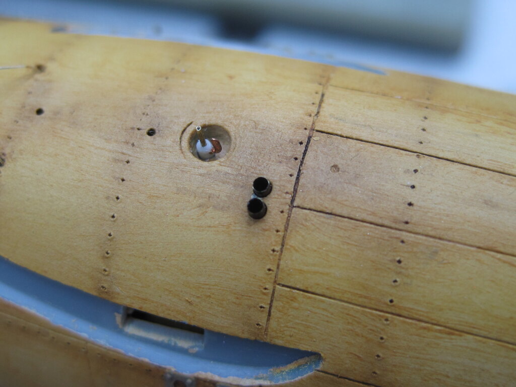

Offline Umlaufmotor
  • Posts: 1268
The empty cartridge cases were ejected through the two pipes that protrude from the bottom of the fuselage next to the drain cock.
On the model, these are just short stubs made of 1 mm brass tubing.
These are painted black.
Inside, kit part #F14 is slightly shortened and glued in place. The engine obscures these pipes.
Servus
Bertl
