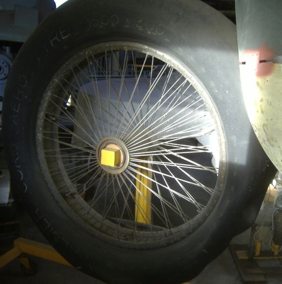

I would like to ask fellow forumites that master the craft of 3D-printing for help.
For my project of the Handley Page V/1500 I need to make 4 wheels with Palmer Cord tires, having an outer diameter 46,8 mm. The rims with covering (no spokes shown) and tires I could probably make myself, but the raised lettering “PALMER CORD AERO TYRE 1500 X 300” would be very hard to reproduce. This lettering really looks "layed on".
Anyone who can help in any way (I'm open to other options as well) please PM me.

As for the dimensions of the lettering, in 1/32 they are 3 mm high and they are lifted approximately 0.5mm.

Taking another look at some photographs, I realize that in scale, the lettering wouldn’t be raised that much.
So, as printing the lettering in 3d is almost impossible to do, would applying thick decals be an option?
Thoughts and suggestions are welcomed..

Nice reference picture!
I don't know where to find such thick decals, but I have another idea.
Masks would be nice, and then apply some coats with white primer until you reached the expected thickness.
The "only" problem is, that the letters are too small to for my cutting plotter because of the drag knife.
There is a new company in Belgium doing very small masks. I'm not sure, but I guess he uses a laser. Link to homepage in review.
https://www.themodellingnews.com/2021/10/hands-on-review-high-definition-stencil.html
You can ask, may be he can cut masks for you.
May be you can also draw such mask as vector graphic yourself (the great open source drawing program Inkscape http://www.inkscape.org, which I use for my cutter, would be able to do this. Or Scribus too, with drawing along path) and find a local laser graving shop or a Fablab Maker community to let this lasered into Tamiya masking tape.

In case it helps, here's a 1914 magazine advertisement from Palmer, showing what their lettering looked like then for standard-size planes.  I remember purchasing a sheet of 1/72-scale Palmer Tyre decals directly from someone on the old WWI Modeling page.  Bob Pearson maybe?  Don't know if he's still around, but I think it was him.  But sounds like the huge Handley Page tires would look different.
