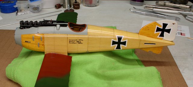

Just a small update before I go on a vacation for a couple of weeks.

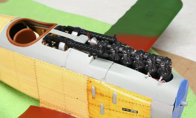

I've put on the last of the decals, added the rudder, and the second machine gun.
I didn't want to risk masking and then pulling up the decaling on the fuse to paint the crosses on, so I used the decal crosses from my Meng Tripe kit.
Nice Gaspatch MGs.
The Meng decals were quite stiff and brittle and didn't soften much when Microsol was applied.
