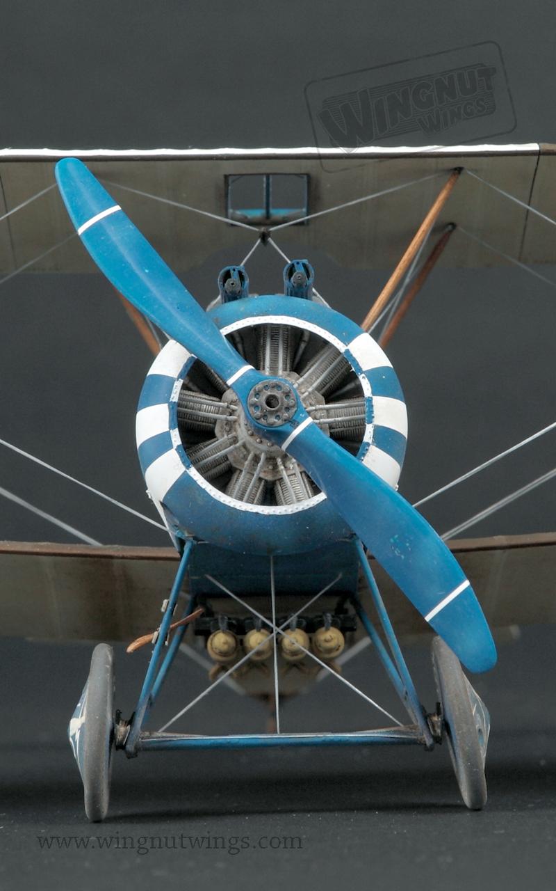

Interesting that the cowling inner ring (near the opening) is sometimes depicted white, and sometimes with revered blue/white (so white line = blue end, blue line = white end)
It can be seen here on the WNW build:
I remember there was an issue of Cross&Cockade about this and other aircraft, and although I'm great at remembering useless details I would not know in this case!
Jeroen
I have a picture from front/left of this Camel and it shows clearly a complete white ring. That is also the same in the Eduard manual as there is a own drawing in front view (and one of the right side, btw). The WNW manual do not show both drawings or an original picture, so that detail is not explained and builders artist freedom.
