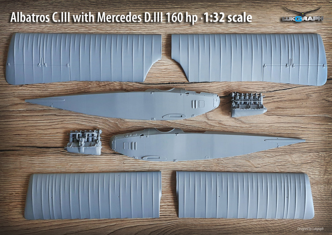

« Reply #11 on: September 02, 2021, 10:56:20 AM »
Lukgraph has uploaded an image of the main components for its Albatros C.III.
Preorders will start in mid-September. They say there will also be a Premium version with canvas and wood decals.

« Reply #14 on: September 12, 2021, 08:03:42 PM »
Hi all,
'Lukgraph' have said that development of the Albatros C.III is complete.
They will start taking pre-orders for this model on Friday the the 17th of September (next week),
