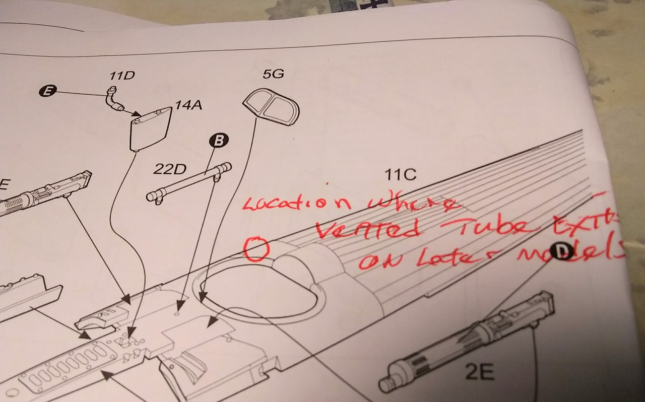

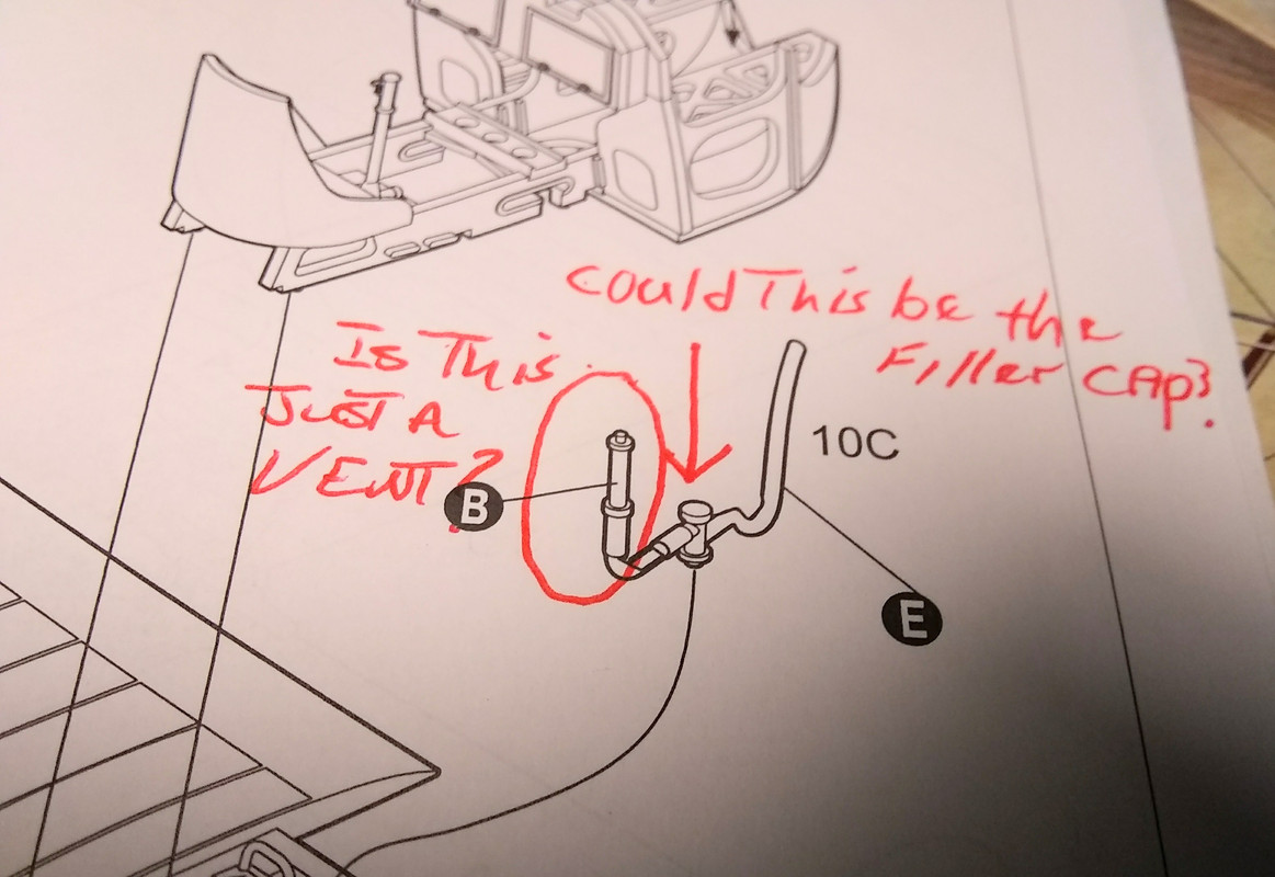

Looking through the Roden directions I noticed that they do not have the Modeler open the hole for the vented "filler" cap on the right fuselage side near the cockpit. The cap is very prominent and easily seen on late models protruding through the fuselage. Looking at photos of Early SPADs' I see no evidence of the cap. So My guess is that the tank was filled inside the cockpit , at least on early models? If so then there seems to be No Need for the pipe fitting leading from the tank to the upper fuselage on early models.
Any thoughts?? Wild Guesses??
PS: Photos on page 5, 6, 7 and 10 in the Data File show good shots of the right side and lack of the protruding cap.

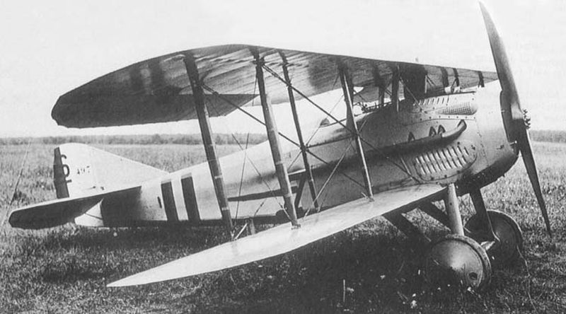

I pulled this from Bing Images so if any copyright is violated I will remove.
Further illustration of the Lack of the Protruding cap mentioned.

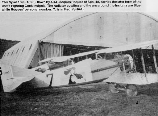

One More same thing about source and copyright:
 With No protruding cap is the pipe from the tank to the upper fuselage even there? My WAG is Not!
PS: The second photo is the only one I have seen with the Louvered side panel not in place on an early SPAD XIII

Thanks Mike but we are looking at photos and instructions of Early SPAD XIII's Not SPAD VIIs. I greatly appreciate your time, effort,  and answer,  but the issue and question remain as to why this vented filler is not seen on the Early SPAD XIII.
PS: Is it "possible" that the early XIII used the same set up as the VII and that tank wasn't present at all?
« Last Edit: July 19, 2021, 07:36:31 AM by RAGIII »

Hi Rick. Sorry for the delay, just seen your post. Yes, you are correct. I just dug through all I have on Spads and it would appear the early 13's had the same filler system as the 7. As you know, the fuel tank forms the lower curved section of the fuselage between the rear U/C legs. The tank was filled from within the cockpit, at the cap you have arrowed. This was rather inconvenient, so the designers eventually came to their senses and installed an extension tube to the fuselage surface. A design office guy was probably told to fill one up and so had to actually use his own design and realised how stupid he was.So, for a 7 or early 13, cut off the section you have circled flush with the central cap tube and you will be good. Sorry, but I could not find a switch over date/production number for the change over.  Regards, Pete in RI
« Last Edit: July 19, 2021, 08:47:42 AM by Europapete »

Due to the size of the tank this vent/filler goes to, I suspect it is an oil tank.  The fuel tank is on the bottom of the fuse and another in the top wing with a water tank for the cooling system.  I have read that the back of the engine has pumps for all three liquids - the fuel was pumped from the bottom tank to the top tank, then drains to the engine.  It appears there is an oil line from the bottom of the oil tank to the pump on the back of the engine, with a return line back to the top of the oil tank if the engine can't take all the oil.  A second line returns from the engine back to the bottom of the oil tank.  The oil tank would have to be vented in order for it to drain out properly.
At least, this is how I interpret the main pipelines visible in the cockpit.  Regardless of what the lines were for, I am just replicating what I can see in photos found from various sources.

Hi Kensar, the oil fill cap and tank vent cap are in the front of the engine bay. The two caps can be seen in front of, and between, the machine gun muzzles. Regards, Pete in RI.
« Last Edit: July 19, 2021, 09:40:55 AM by Europapete »

The small fuel tank in the top wing was a gravity feed tank for the engine in case the main tank system was damaged and lost pressure. It had it's own filler cap above the wing. The other one was, as Kensar said,  the header tank for the radiator. It too had a filler cap and vent above the wing.

Ths oil tank is in the engine bay I believe. Will recheck to confirm.
Re: Early SPAD XIII Question
« Reply #13 on: July 19, 2021, 11:44:46 AM »
Pete,
Thanks for your input and research. I think I will do as you suggest and just cut off the pipe at the source. It is interesting that Roden seems to have caught some details all other companies missed yet missed on some very obvious things like the "Photo" panel on the left side. Swallow an Elephant and Choke on a Flea  8)
« Last Edit: July 19, 2021, 12:29:28 PM by RAGIII »
