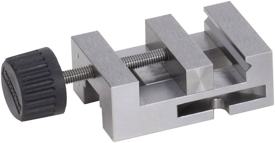

The undercarriage of our beloved WWI aircraft are very simple (in comparison to a modern jet for example) so they can easily replaced (or at least the fragile parts of it) by brass and nickel silver micro tubing and wires. Albion Alloys has sold a tool to squeeze the tubes but a little vice with flat jaws will also help.
Have that done recently in 1/48 on some models, in 1/32 it should be much easier.

What in this moment is lacking is some material like the good old Strutz or contrail struts.
It is true that Albion Alloys makes a took to squeeze the tubing, but it is not easily available and anyway, it offers just one profile.
The same is true for the 3D printed squeezing tool designed by Bo.
AFAIK, this tool is not available any more, at all.

Yes, it was on 'Albion Alloy's' web site for modellers, but that site went down some time ago.
They had other tools available as well and they're no longer available either.
It's a shame as although it can't create a perfect aerofoil, it can be used for any size of tube and support rod, so any size of strut can be made.
WD
I don't think it offers any particular profile, it just squashes the tube. It's the wire inside that governs the amount of squash
I do the same job with a good quality, smooth jawed vice
The Albion tool is not really needed, I use a vice from Proxxon:
Any other vice will do it also, but it NEED flat vice jaw!
  • Posts: 1460
Thanks Bughunter!
