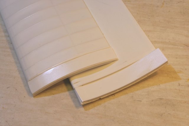

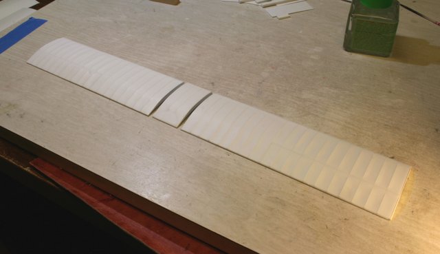

A small update - still working on the wings.
Top wing with center section roughed out.
Both wings in progress.  I think they are turning out quite nicely.
The tips are built up from laminates of styrene strips.

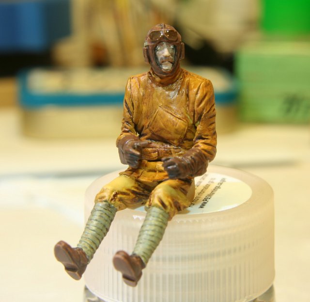

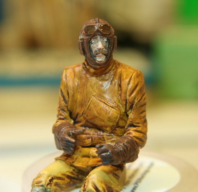

Reginald has made an appearance.  Claims his zombie-like appearance is due to the effects of high altitude.
I'm not buying it.

As for Reginald, I think he's saying, "Are you sure it's safe to fly?".

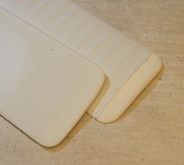

I went ahead with the tail surfaces.  They are constructed by laminating a 0.020" card on both sides with 0.010" embossed skins for subtle rib detail that will match the wing pattern to tie everything together.
Here is the core with the two skins.  The drawn rib pattern is a guide for the embossing.

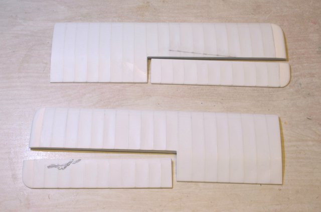

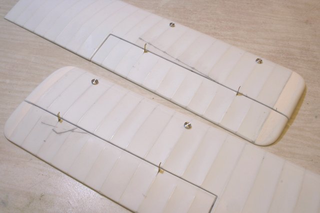

I have cut the ailerons from the wing.  The gray marks on the wing are scratches being filled in by primer/surfacer.  It's not unusual for the knife to slip.  >:(
The ailerons have many small hinges (7 each) I simulated with wire that I used to mount the ailerons.

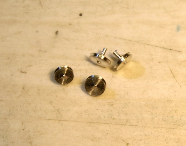

The ailerons are activated by exposed cables, so pulleys are on the top of the top wing and bottom of the bottom wing.  Here I am parting off one of the pulleys (0.100" diameter).
One pair are pulleys for single cables and the other pair are for two cables.
Here are the wings mocked up with hardware.
