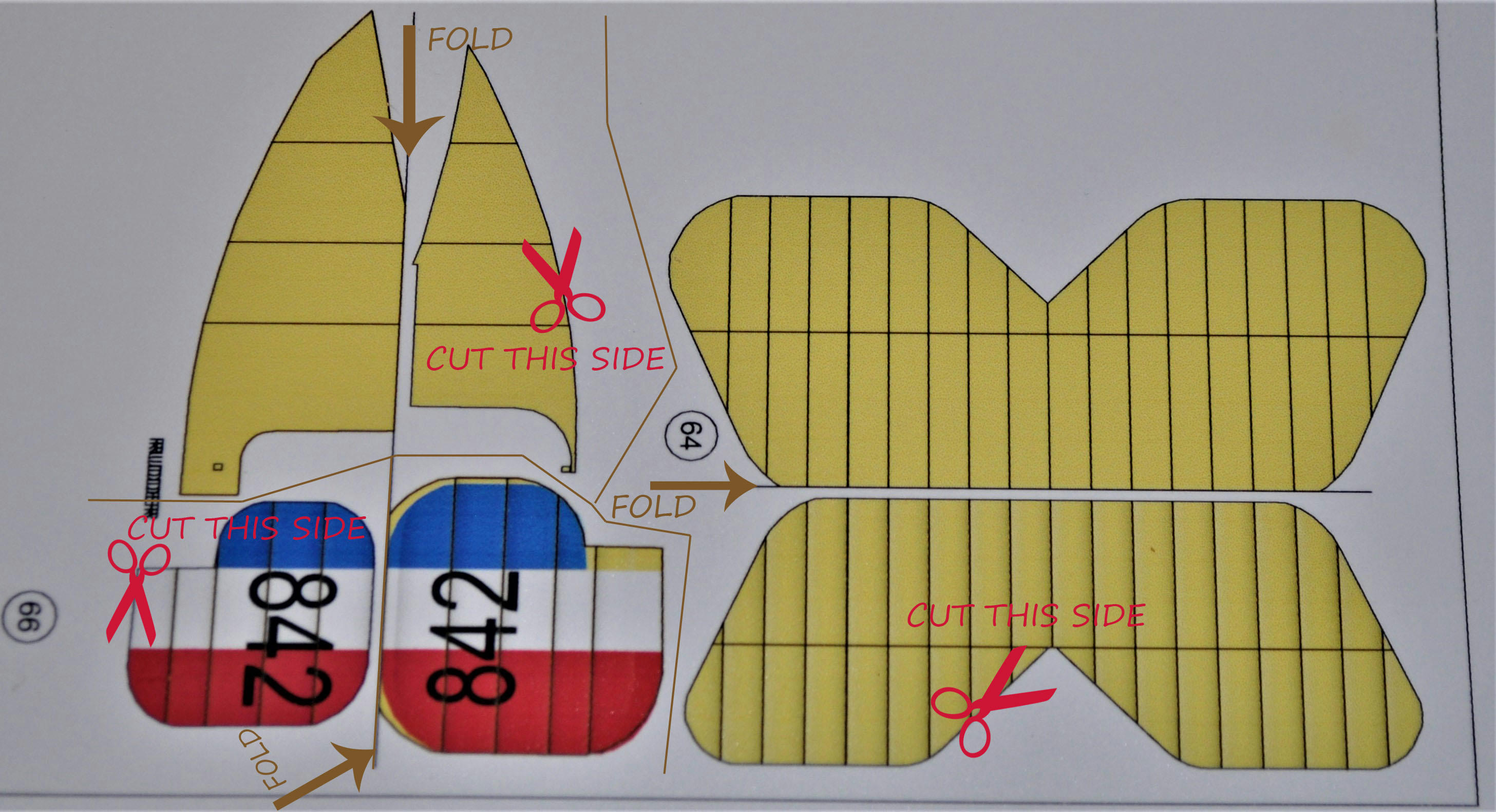

I am in need of some help here.
The tailfeathers have me totally confused. I have carefully re-read the written instructions and looked hard at all the drawings and cannot find a hint as to how to assemble the two sides of the fin & rudder and the stab & elevator. Below is a photo of the parts as printed.
The two sides to each piece are different sizes which I take to be for making an airfoil cross section. There is nothing in either the written instructions or drawings indicating how they go together and there are no "ribs" to go between.
I am thinking to roll the larger Horizontal tailplane piece into an airfoil shape, Glue the LE and when dry, match up the TE and ends.
The fin and rudder are another story altogether. Are they printed out of register? Pretty sure not as the rest of the sheet is good. What is that line from the bottom of one fin to the top of the opposite side rudder? and what about the CDL edges to the larger rudder? Leading edges??
Am I missing a subtle hint from the way they are printed? If not I am inclined to glue the parts together and trim to the outline of the smaller part and color the edges.
sp

« Reply #39 on: July 31, 2020, 06:06:14 AM »
The first step is to separate the parts.
The second step is to fold along the line.
Lastly, cut the side where the designs are smaller.
 ;) matt77

« Reply #40 on: July 31, 2020, 06:56:06 AM »
Thanks Matt. I am slowly learning to read the cut, score and fold information included on the parts layouts. I did as you showed and the parts came out fine. That one piece larger than the other is a neat trick for getting a match up when you have to fold to make a two sided part. All part of the learning curve.
