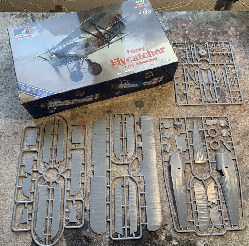

Armory models, not tried them before, it was released last year and I bought it at Scale Model World. The CAD drawings they released were awesome.

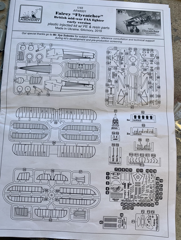

Comes in a sturdy box but - But on opening, I have to say it has a distinctly limited run feeling about it.  Lots of flash and every part will need cleaning up. No numbered parts on the sprues (a separate diagram in the instructions). Not an issue, but a slight inconvenience.

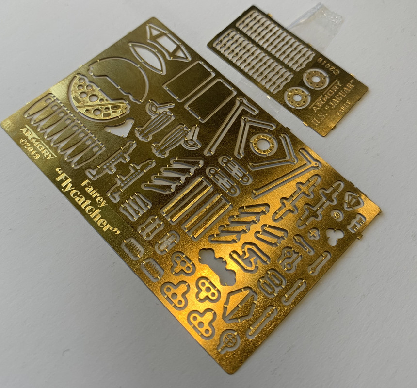

2 PE sheets.
Quite a bit of resin for the engine, and this looks nicely tooled (by a company called Jaguar I think).

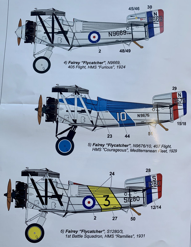

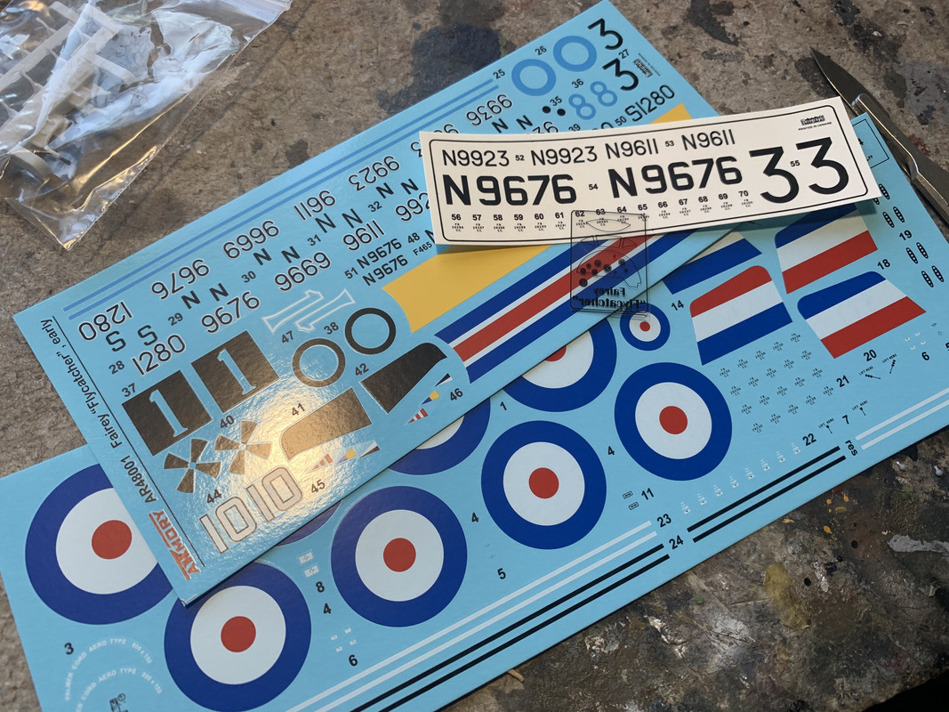

6 colour schemes - decals look ok.
A mini clear acetate sheet for the windshield.

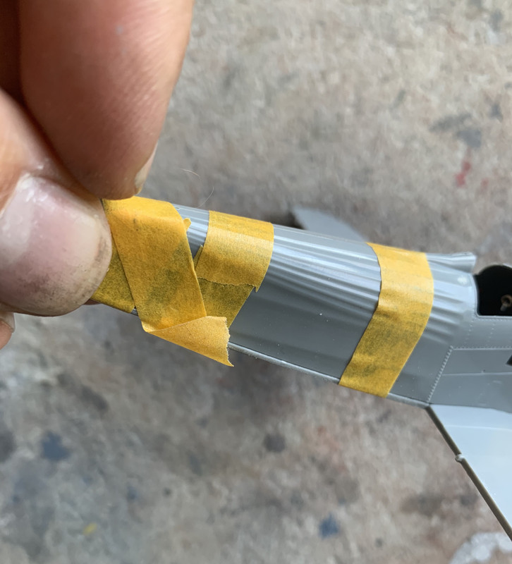

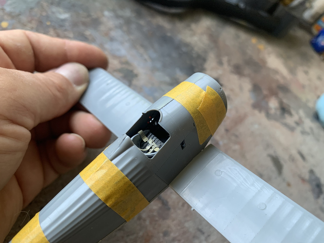

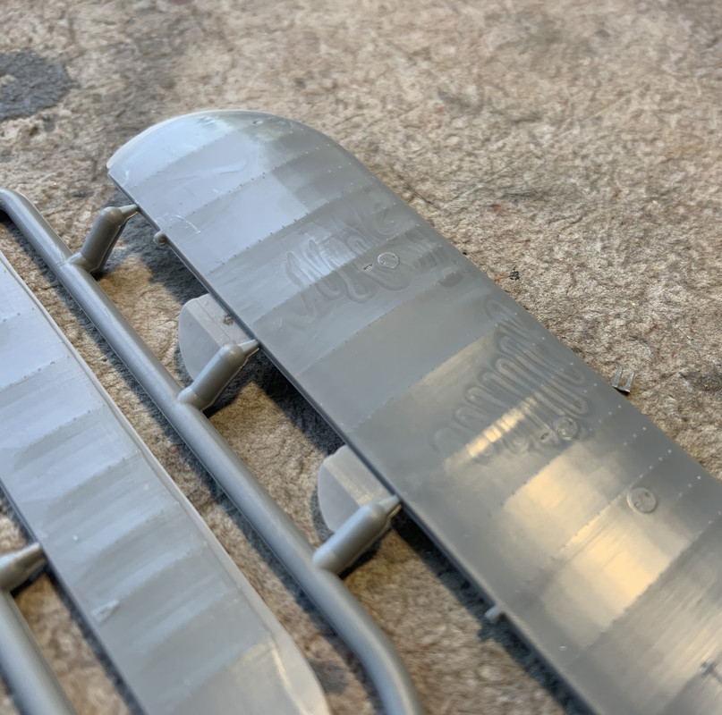

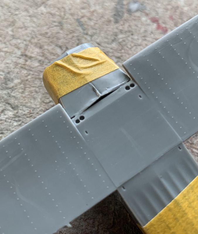

Surface detail is ok - but there are some curious wavy moulding marks across the wings (see photos). I’m hoping these don’t show through the paintwork.

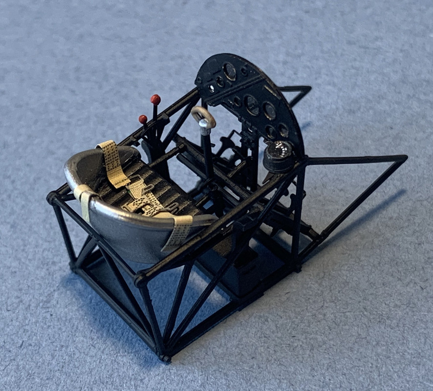

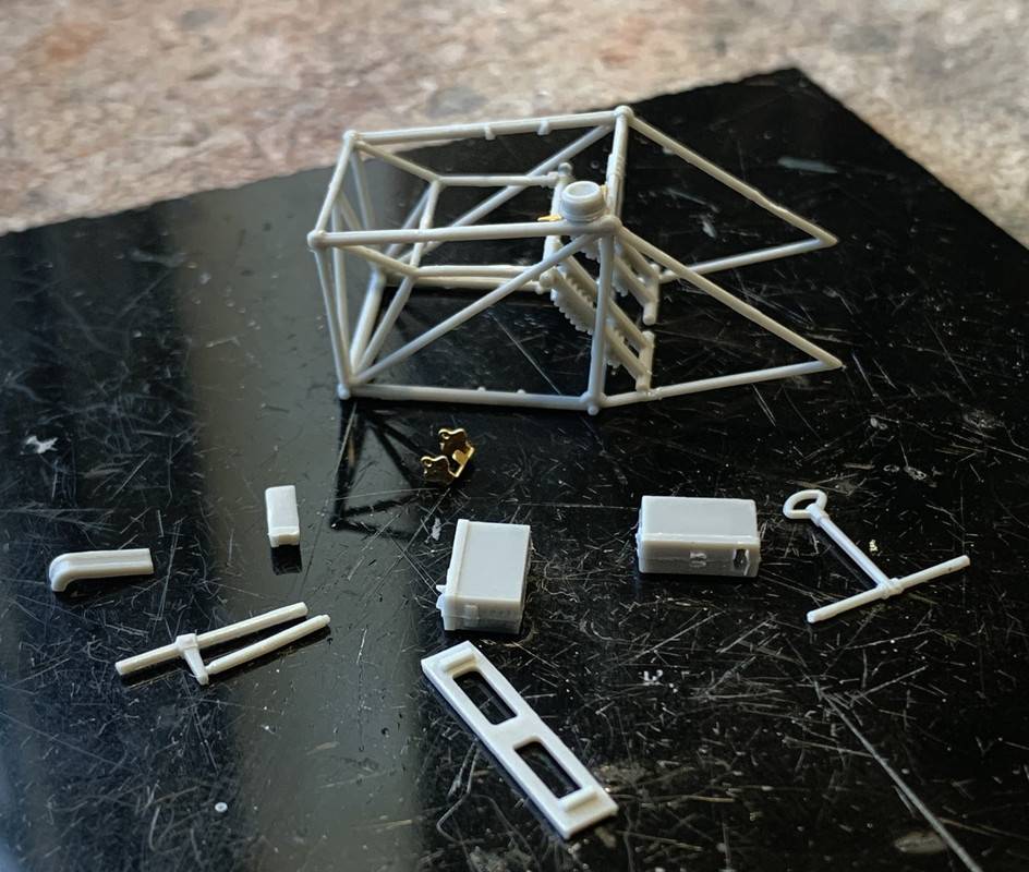

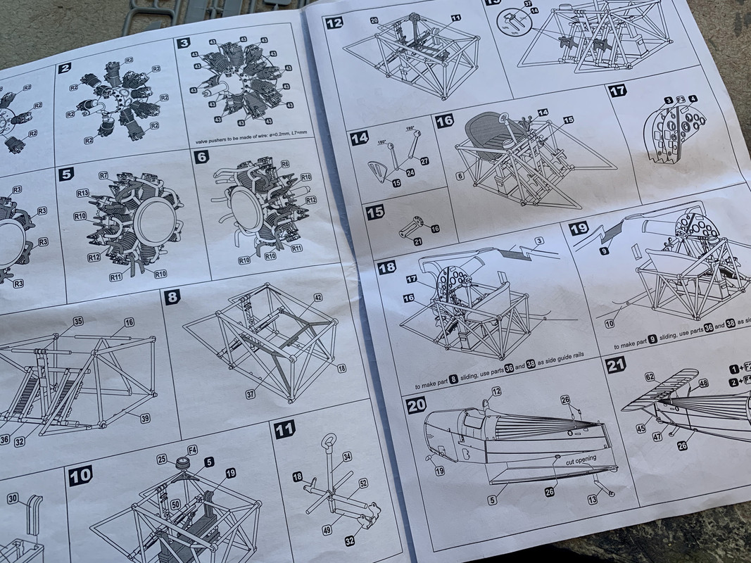

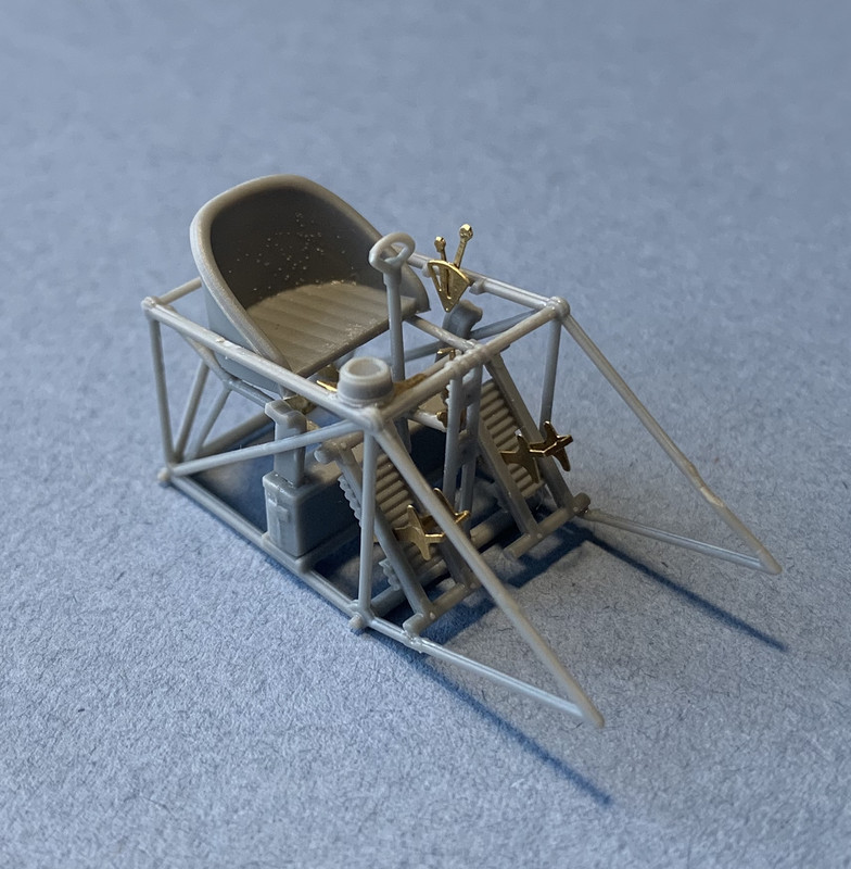

I’ve started the cockpit and it’s not for the faint hearted! Tubular frame with numerous parts that are not a click fit! Requires a bit of patience to align it all. Also these very small, thin parts are a PITA to sand without breaking.

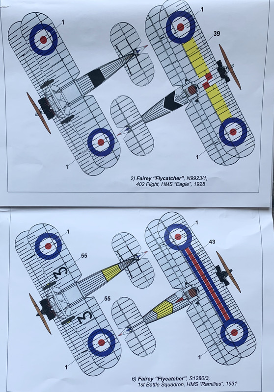

No colour call outs on the cockpit at all! Any guidance here welcome?

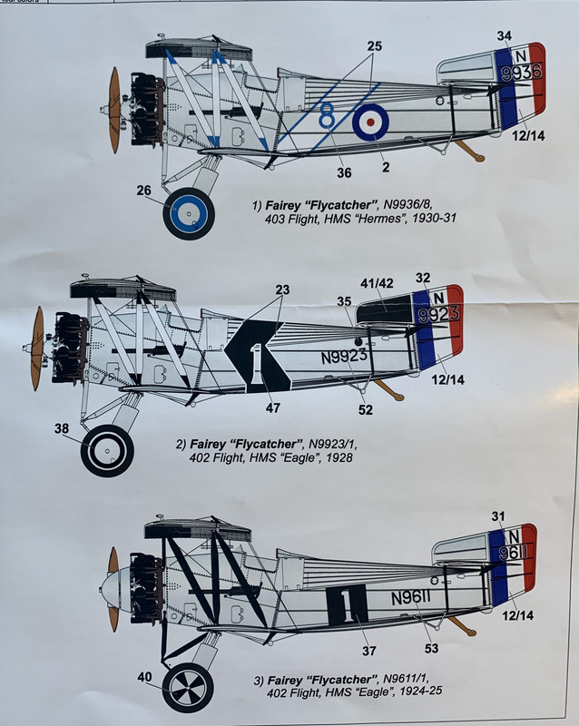

There really are a lot of strange aircraft out there... It's got a fairly peculiar look, don't you think? If those are the schemes you're choosing between I'd go for #5 or #6. Looking forward to more pictures!

Here you go Guy,from the Silver Wings site:http://www.silverwings.pl/edc_media/Structure/Item-0139/File1/Flycatcher-instruction.pdf
Hope this is helpful,
Dave.

Hi Fredrik, Yes, I guess it is odd, but I’ve always liked it for some inexplicable reason! That’s odd re colours as I was leaning towards those two too. I haven’t looked outside the kit options yet... On the top wing there’s a bit of a ‘flying circus’ feel about all the schemes. I’ll post a pic later.

Here’s the colourful top wings on two of the colour schemes...
And I just about made it out the other side with the framed cockpit...

Tidy assembly Guy.
As far as the cure for perfection, you seem to have found it.

I’ve just finished another 1/700 ship - HMS Penelope. I put a huge effort in, but again, fell out of love with it after close photos. Got the Flycatcher box out and accidentally chucked the box lid onto HMS P - broke the rigging and masks, and I really didn’t even care. Perhaps I ought to see a shrink...
Anyway, got the ‘pit painted up and tbh she looks a lot better than I perhaps gave the kit credit for initially:
Ps thanks to Dave for the colour call outs! Great save, I probably would have done it green. Looks quite Art Deco to me!
Not that you can see much of the black interior! The belts are just from the bottom of the spares box, no idea where they’re from but look ok I think.
Fits a bit clunky! Not exactly Wingnut Wings, but then even Wingnut Wings aren’t Wingnut Wings these days!

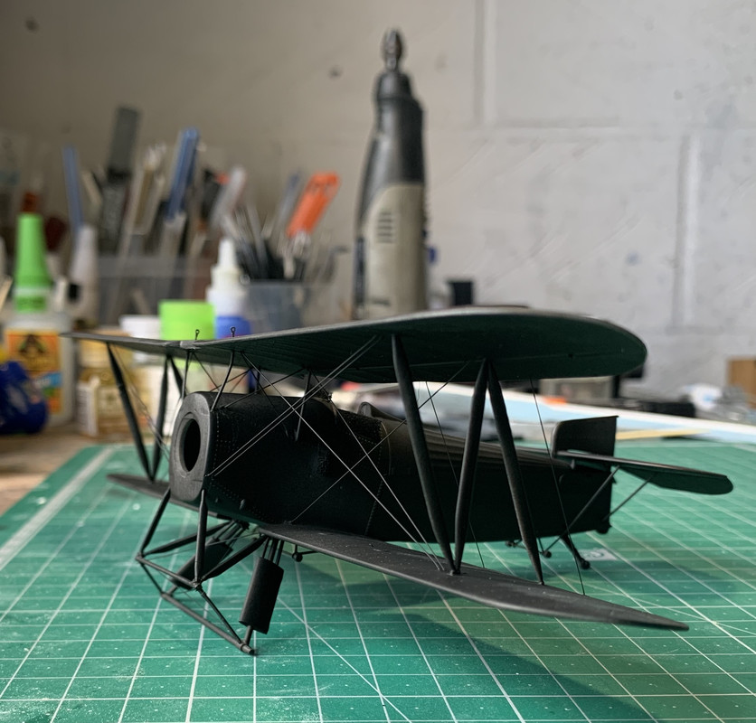

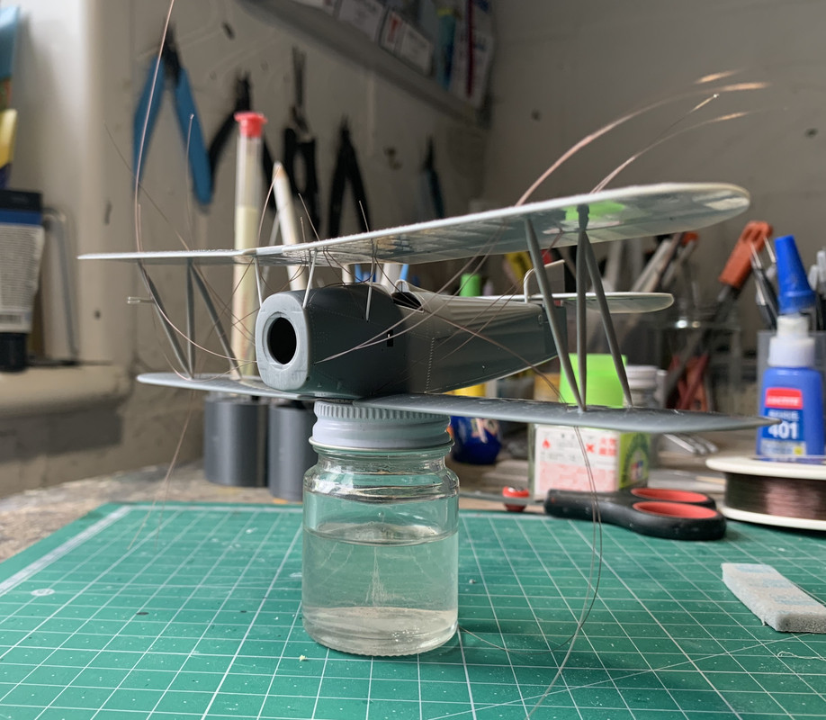

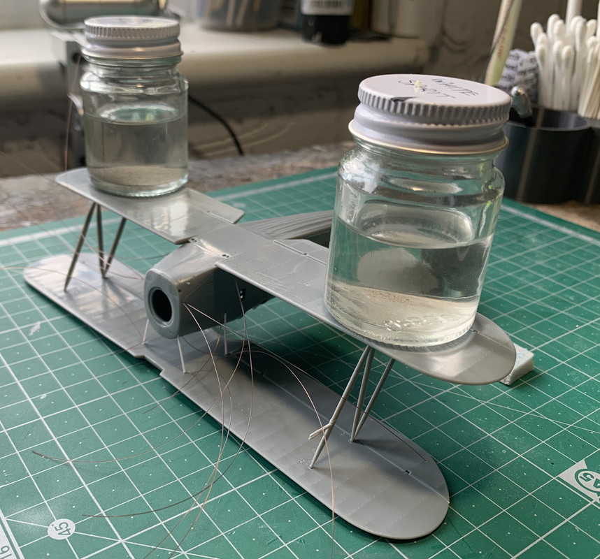

I’ve decided to take the same approach as the Gladiator build and construct & rig before painting. Not quite as straightforward this time as the metal cowlings should differ from the painted fabric, haven’t quite worked out how I get round that, but it’s a delicate little bird and I couldn’t quite face rigging post paint & build.
I’m using my mark 1 patent applied for bottle jig...

Construction mainly complete, rigged and primed.
I have to say, this isn’t an easy kit. I’ve found it quite challenging.

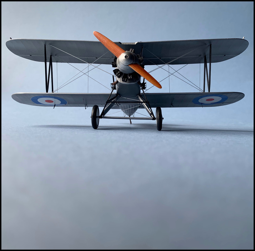

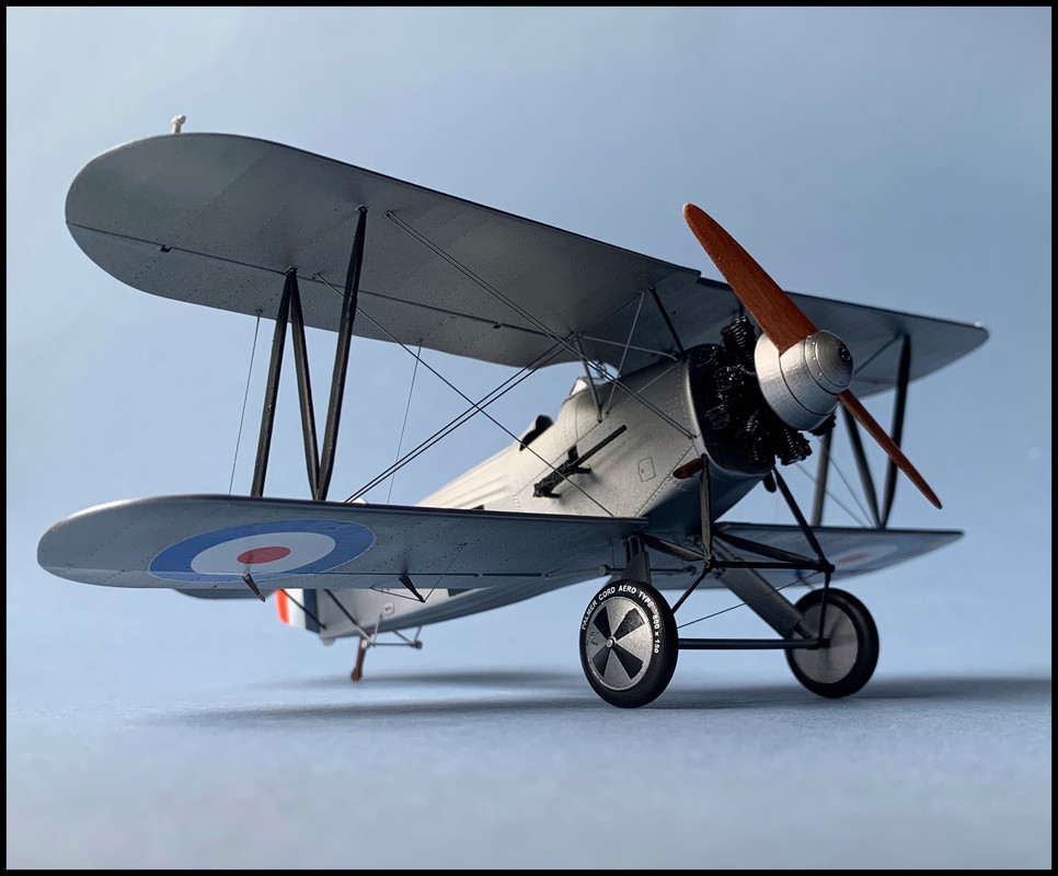

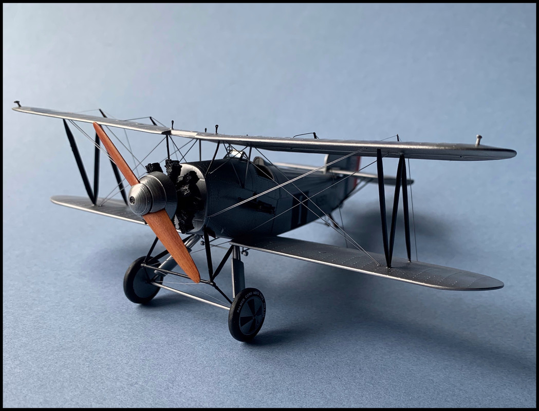

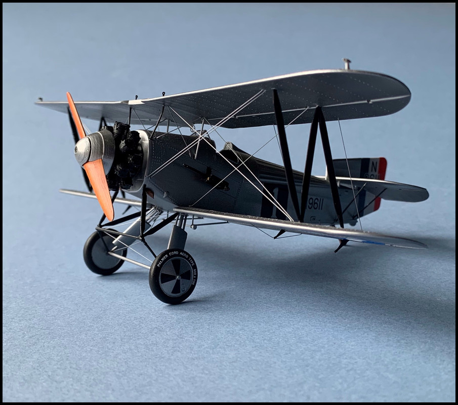

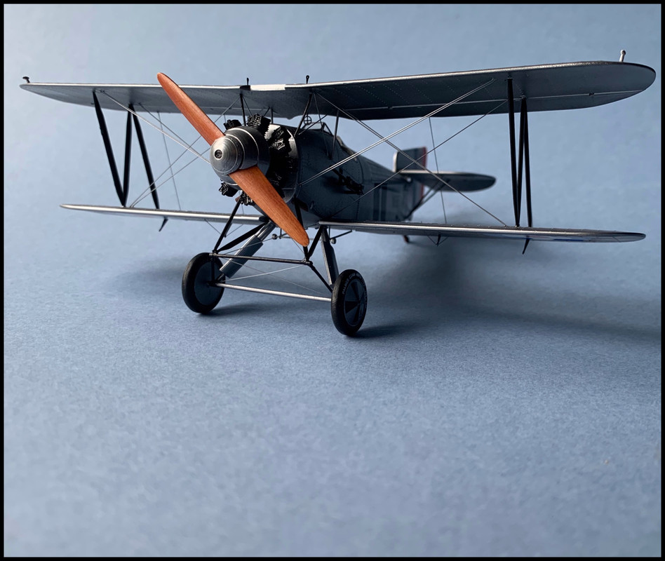

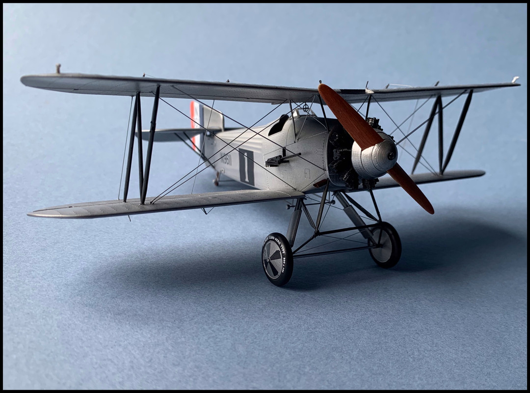

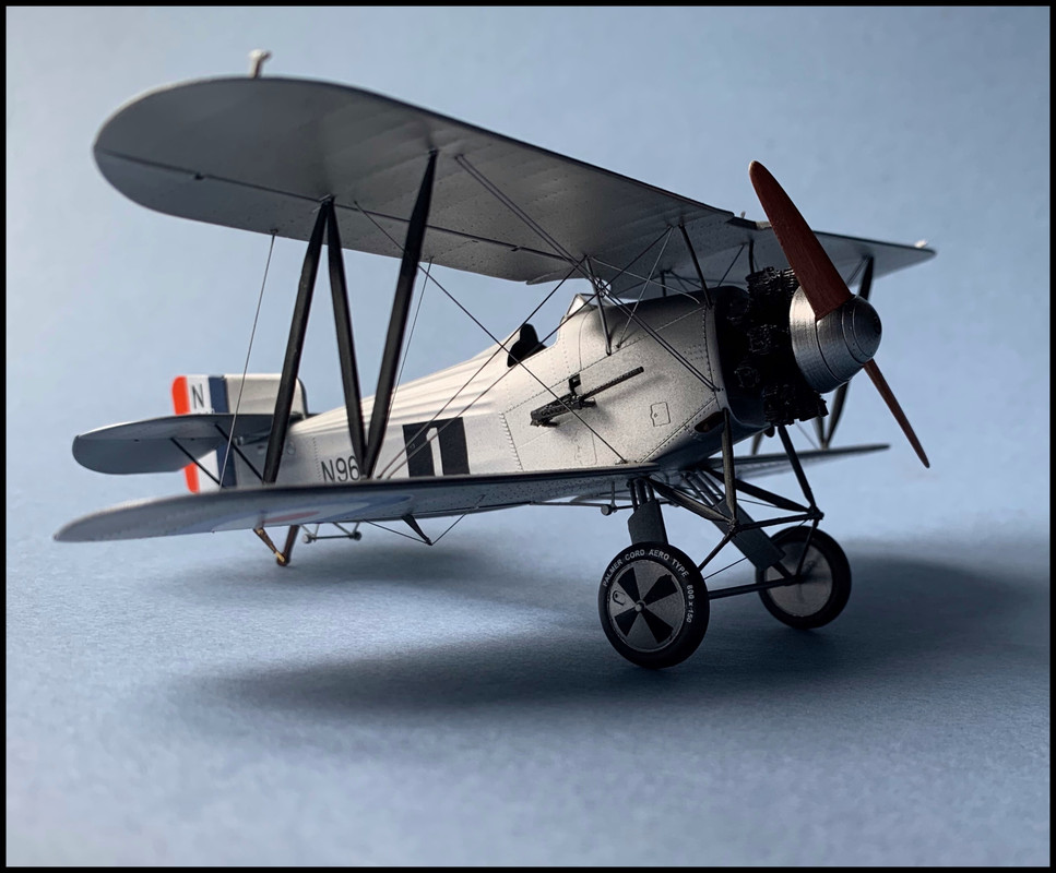

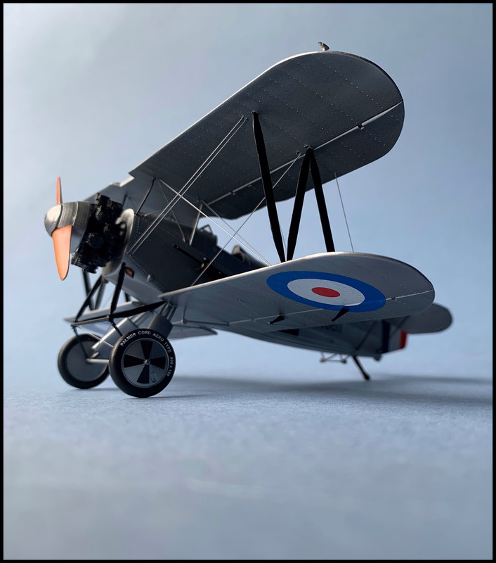

Finished.
A little rough round the edges. It’s a tricky little kit - but it does have great potential. I rushed through it to be honest. If you took your time with it, it could be really awesome. The resin engine is really nice.
I’d love to see Frank (Bughunter) do this. I reckon he’d love it.
What a lovely aircraft though. This one is from HMS Eagle, 1924
« Last Edit: June 07, 2020, 12:46:09 AM by Gisbod »
Re: 1/48 Fairey Flycatcher *Finished*
« Reply #14 on: June 07, 2020, 12:35:39 AM »
I would be thrilled with one of your "rush" jobs any day, Guy!  That model looks simply gorgeous to my eyes, and you have photographed it very well.  A very clean and sharp presentation of an interesting aircraft.  Outstanding modeling!
