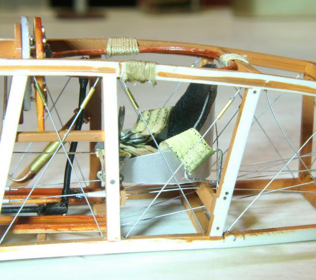

« Reply #33 on: December 21, 2019, 11:34:38 PM »
A small update.  added the seat and belts.  The cushion is Miliput, the leather seat back covering is masking tape, as are the seat belts.
Still waiting for a Taurus pulseometer and now working on developing a vacuum former and a process for using it.

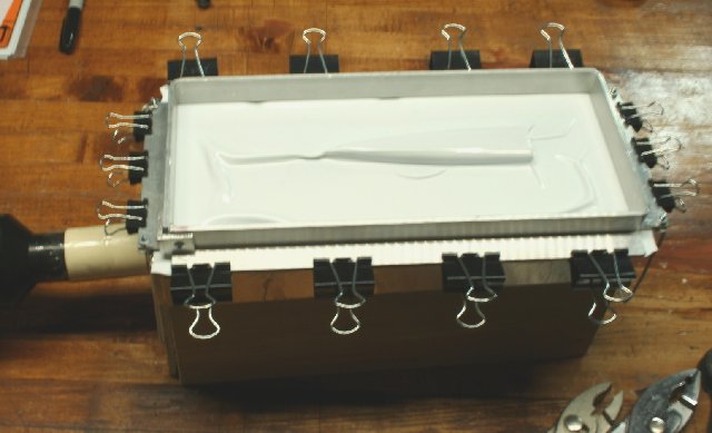

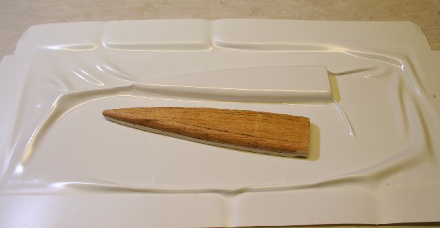

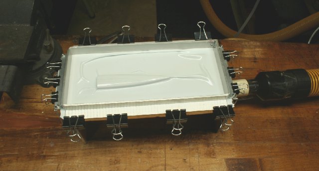

Finally getting back to this one after the holidays and family commitments.
I've been learning the ins and outs of vacuum forming and its still not completely to my liking, but many times you learn by doing.  I just don't like wasting a lot of styrene sheets trying to figure things out.
In my first attempt I made a smooth part for the bottom of the fuse.  After some trials, I was able to make a useable part from 0.020" stryene.

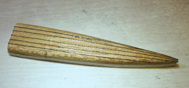

Having gotten this far, I added wire to the mold to simulate longerons.
And formed another useable part from 0.020" styrene.
I used a lot of 0.010" sheets trying to get a good part, but concluded this is too thin to vacuum form well.

« Reply #41 on: January 20, 2020, 03:32:51 AM »
A couple of things
No, 0.010" doesn't work - I found out the hard way too
If you don't release the sheet from it's frame, you can take a poorly formed vac, reheat it and it will relax into a flat sheet again. I have done this, usually when I didn't get the styrene hot enough in the first place
Richard

Re: The Tommy
« Reply #44 on: January 21, 2020, 03:39:10 AM »
Richard - thanks for relating your experience with the 0.010" sheet.  It validates my conclusion.  Reheating poorly formed sheet should save me some plastic also.  When I don't get a good forming sheet, I think its due to the large amount of sag in the plastic sheet.  It ends up making alot of wrinkles.  Not enough sag, and it doesn't form well around the mould (or is that mold?).
