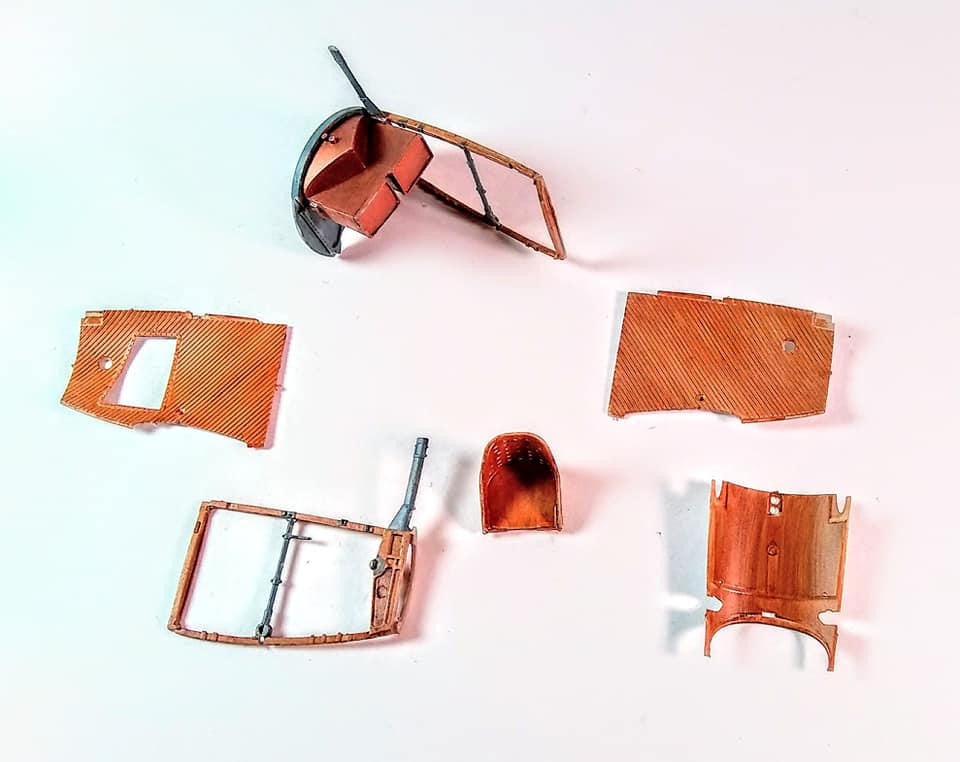

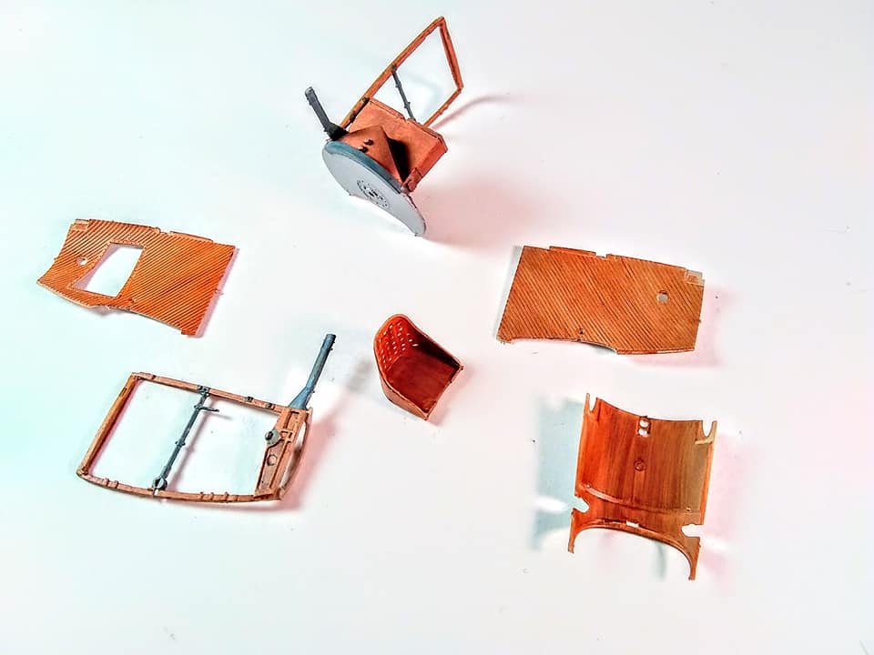

So began to move forward today. I did most of the wood grain using Acrylic Oils. The tank is copper and just a small amount of assembly is done.
Offline ondra
  • Posts: 954
Re: CSM 1/32nd Scale Nieuport 17 Early
« Reply #22 on: March 20, 2019, 03:14:54 PM »
Very nice work on the woodgrain, Rick! How long do the Acrylic Oils take to cure?
Ondra
Thanks Ondra. Depending on how thick the application is they are dry to the touch in an hour or two. (I really spread mine out over the base coat to the point they are almost a stain) Not sure about fully cured but would guess 24 hrs.

Spectacular woodgrain, I must try these acrilic oils as lineseed oils are really slow drying.

Very nice effect Rick  8) I notice that you painted the underside of the top decking wood , Wasn't this alum ?
Thanks Giuseppe! The Acrylic oils I use are Windsor Newton Griffin Alkyd. I am sure there are others available.
Thanks T!. As for the upper cowl panel...I don't know  ::) I will have to check references. I looked through all of the builds here and this is the one part no one seems to show before it is installed. Funny thing is I don't even remember how I painted mine on my Late 17 build  :o

The Jury is still out as to the forward decking. Edgar has confirmed with a blueprint  drawing that the Nieuport 27 was 4mm ply. As I see no reason they would make a change from the 17 to the 27 I am going with wood. Hell it wont be seen anyway  ;D
PS: I am getting some outside confirmation for ply, just for the record.
