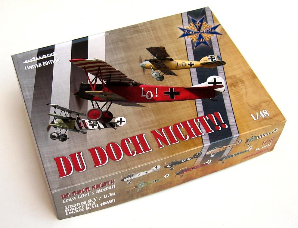

I do not quibble with your views on rigging. I think the techniques argued for by Des are sound - and if done correctly I don't think they'd be an addition to almost any model. This one .... if I had been more experienced in biplanes I might very well have done things differently. Had I made my own turnbuckles they would have been smaller and would have installed cleaner but those big C type buckles are simply very prominent in all the photos and I simply didn't have the confidence to ignore them. I've done several ships and it's common to use white glue and paint to emulate all kinds of fittings and that would have been an option here.I know WNW takes the minimalist approach to rigging, but I'm not sure if it's because they are right or want to sell more model biplanes. I'll post that question and see if some people here would chime in - the bar is very high on this board - it reminds me a lot of Model Warship. For what it's worth, I've bought a couple of Eduard 1/48s. (Not that I had much choice - WNW doesn't seem to exist at this moment.) On those I'll use EZ line and glue/paint to emulate sleeves. Am curious there to see how easy it will be to stick EZ line into a hole containing CA - could be a well hidden eyelet would still help. We'll see. Thanks for your opinion.
