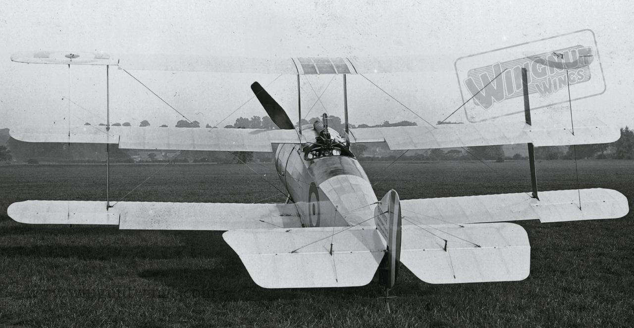

About the surface being too dark - we'll have to see. There is a lot more weathering to come and that will include fading. However, I really don't have a clue on how to properly emulate the effect of sunlight passing through doped fabric and showing the ribs. Here are 3 pics - two of the same replica and one original:
wingribs by Eric Bergerud, on Flickr
MS-g by Eric Bergerud, on Flickr
1916-morane-saulnier by Eric Bergerud, on Flickr
I don't see how one is going to make an opaque object like a plastic wing look translucent. (Tamiya has done at least two kits - one was their Swordfish I - in clear plastic to show the full interior. I wonder what you could do with that? But I doubt we'll be seeing clear styrene wings anytime soon.) Ultimately you have to evoke the look - but no modeling technique I know will reproduce the effect. (If wiser heads see things I'm missing, please comment.) The third picture above shows an opaque wing with dark ribs. That's only appearance of course - it looks that way because the light is going through the fabric. You can also see from the last photo how prominent the tape or wooden slats on top of the wing are. It's passed my mind that I should have trimmed the chart tape more carefully and left it on the wings. As far as the mottled wing - which causes the irregular light/dark patterns - it's not done to evoke sunlight going through the wing - hopefully it will be step one to creating that patina of castor oil + dust + mud + other fluids + wear from ground crew that I think would have appeared on a well flown service aircraft. We'll see.

One trick is to note is that the spar does not touch the fabric. so what you paint the spar has to be lighter than what you paint the ribs. Look at it as pre shading narrow lines with hard edges. If you can raise the mask for the spars a few thou and get a slightly softer edge to go with the lighter color, then you are a master masker. I have done it before, white primer darker spars, even darker ribs, then mist on the CDL until you get the translucent, 3d effect you want.
