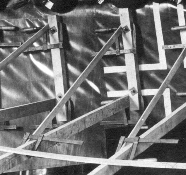

« Reply #6 on: February 09, 2019, 12:54:58 AM »
This is a cropped version of the photo that finally convinced me that there were two colors on the undersurface on at least some EV/DVIII wings.
and my build:
https://forum.ww1aircraftmodels.com/index.php?topic=9032.0
On the other hand, I agree with Lance. No one can totally prove any color info on this one.
