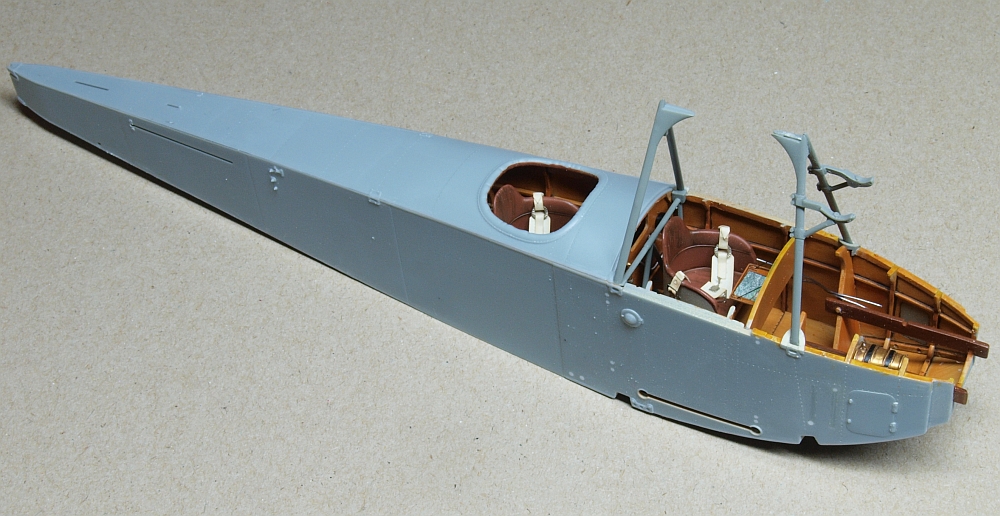

Going on...

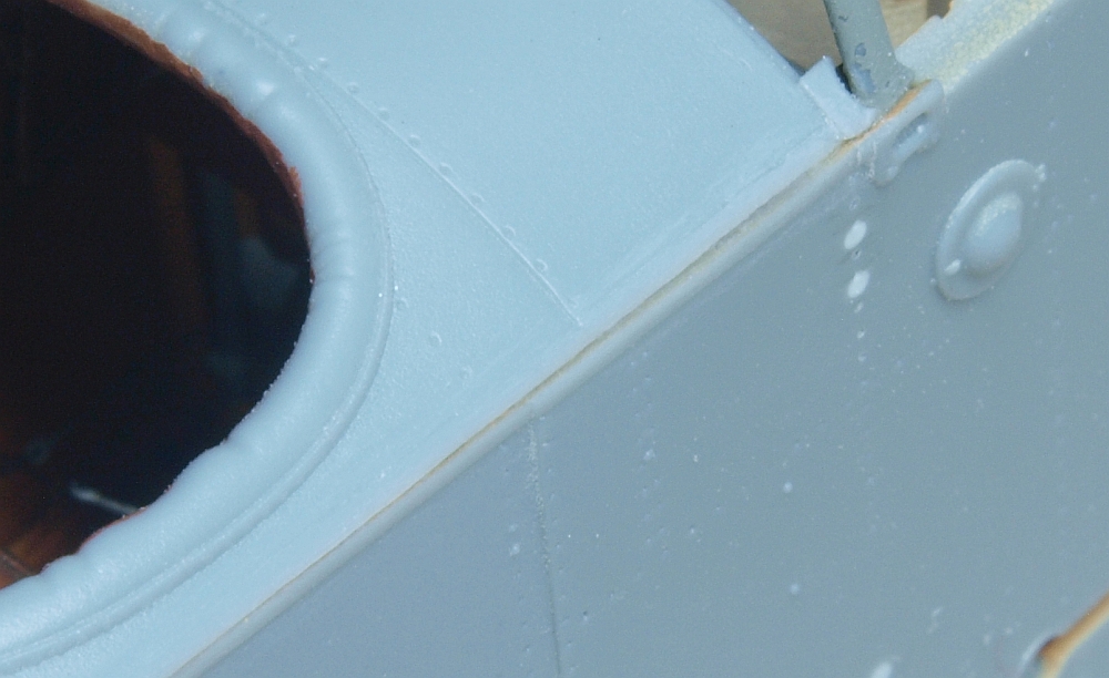

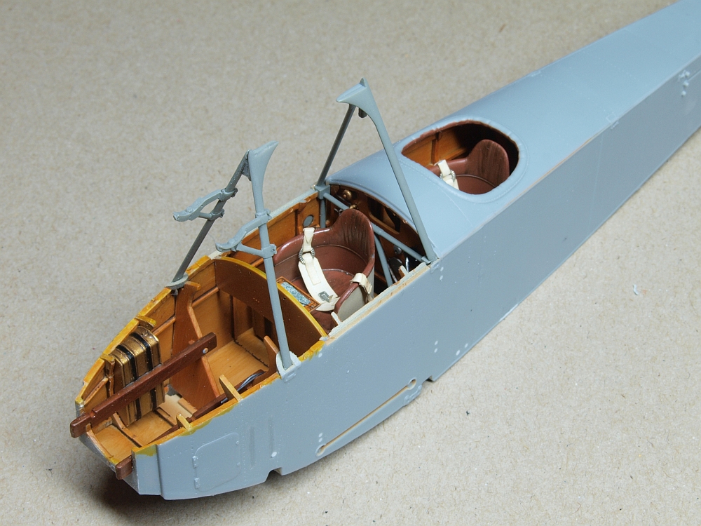

The fuselage is closed except for the observer cockpit metal panel.

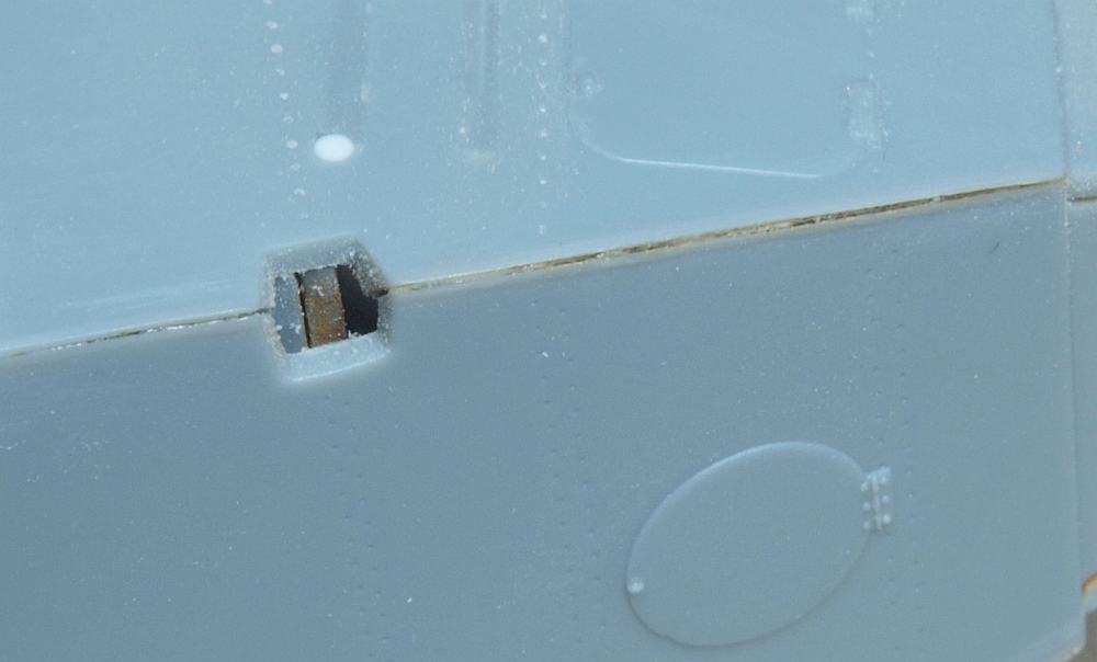

Am I the only one who has problems with gaps along the seam lines in this kit? Filling and sanding is quite a task here because of the fine longerons detail along the edges. Luckily, the majority of this work is now completed.

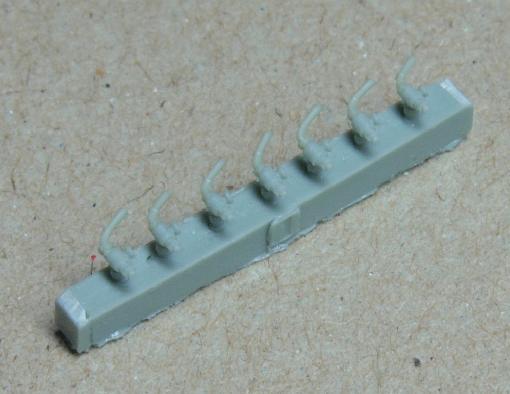

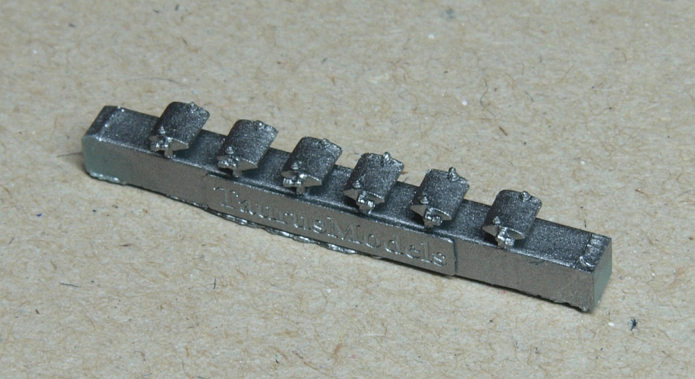

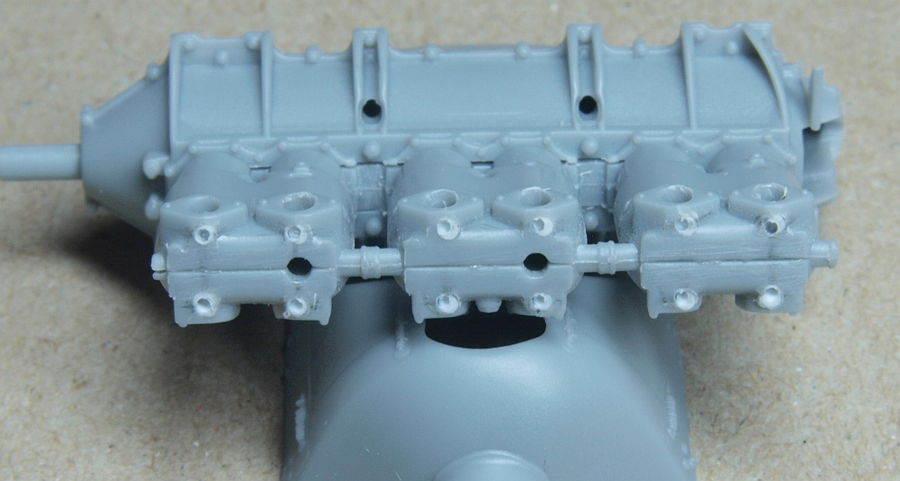

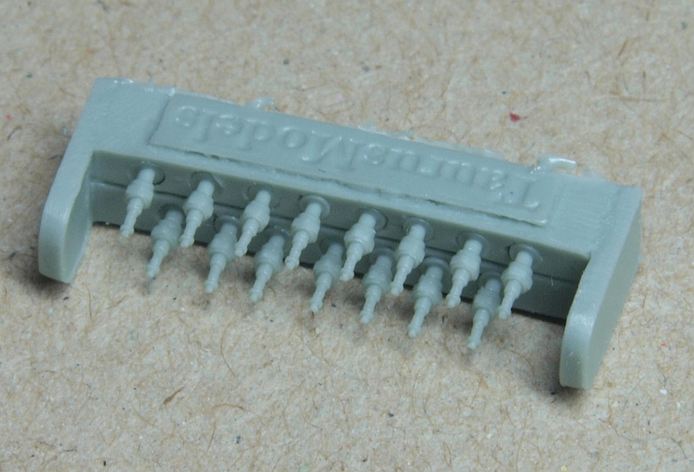

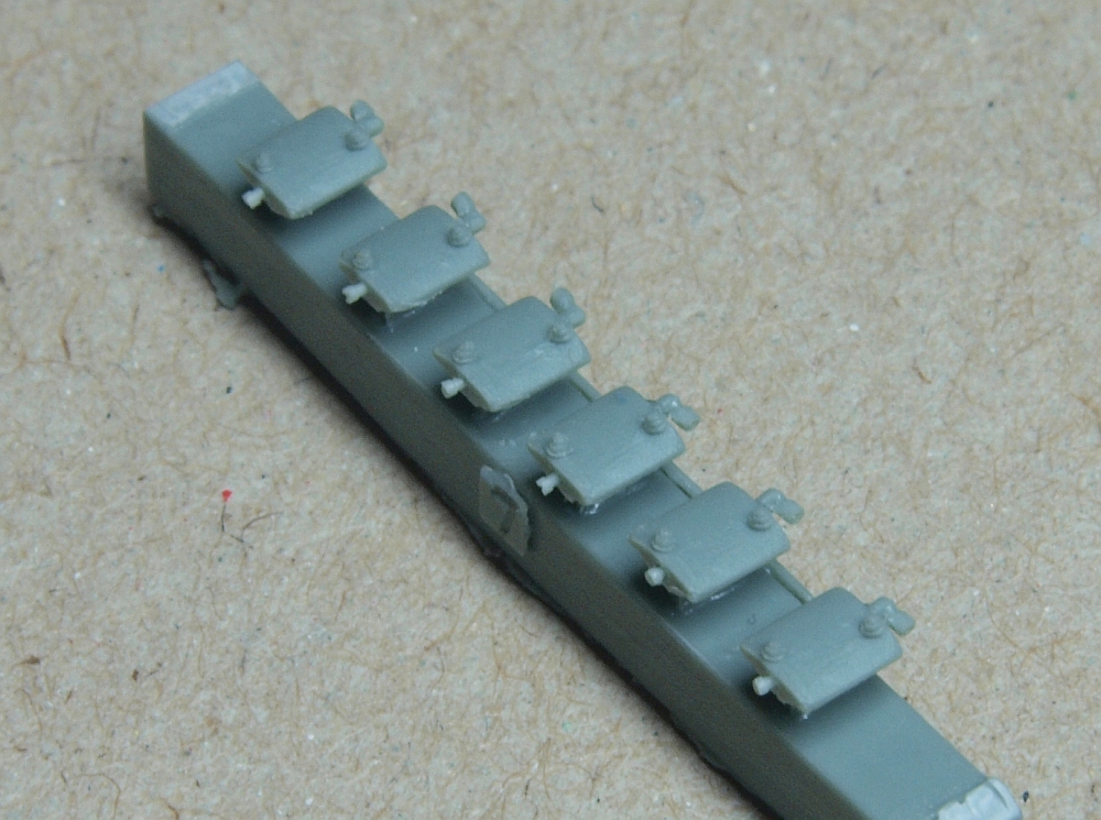

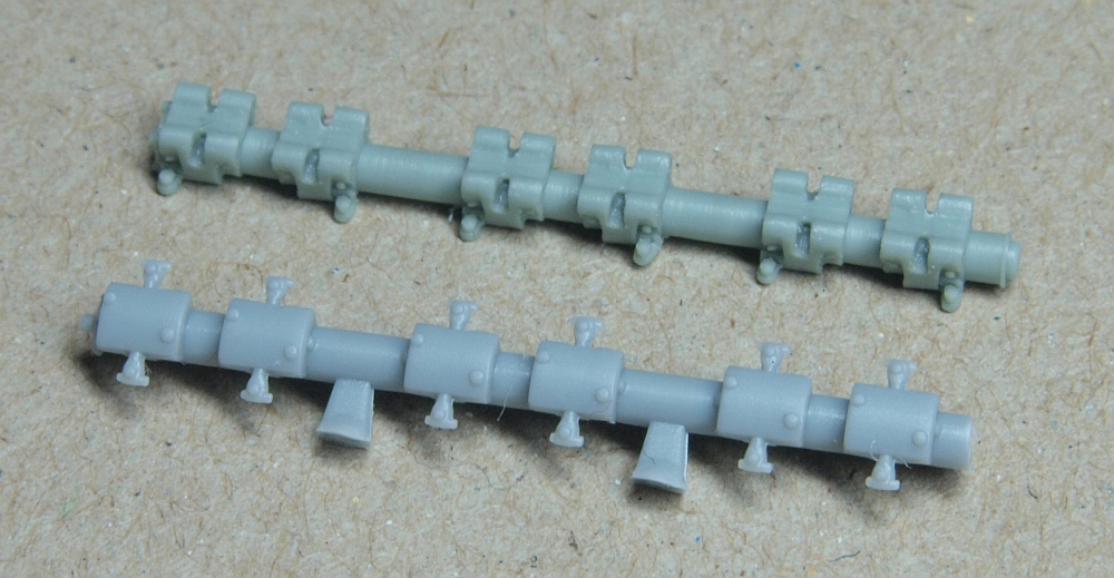

I have started working on the Mercedes D.II engine. All possible Taurus Models resin goodies will be used. Priming cups, timing gear in the separated-elements version, the spark plugs. At the moment all of them are basically ready for airbrushing, The holes in the cylinder block for the valve springs were drilled at correct spots only on the second attempt.
PS. And good news are that my resolution to start this model made Melius Manu to speed up the work on the promised conversion set. I am to get the proper decals next week. We will see...

I don't know what your filler of choice is but I have converted to Vallejo plastic putty which can be shaped and smoothed out with a water-dampened cotton bud. This means no sanding needed if you smooth it down while wet.

Dave, I am filling with liquid CA glue. It is especially handy when thin gaps are involved.

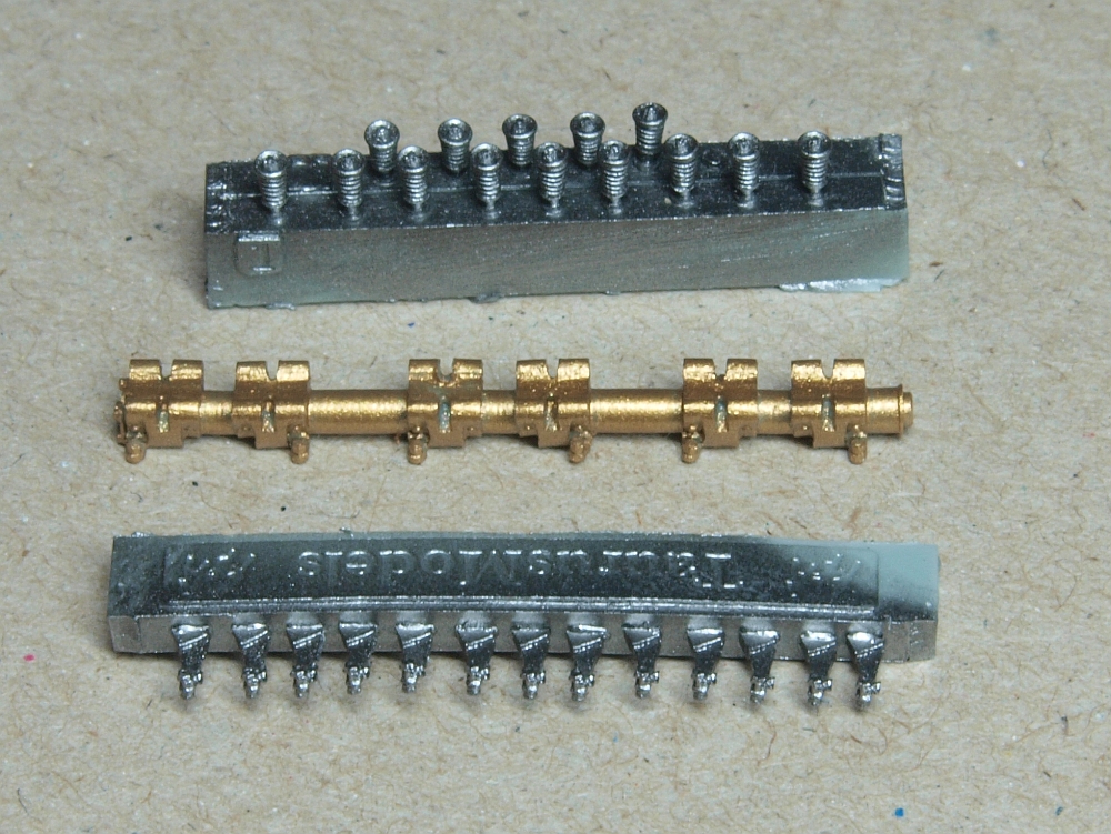

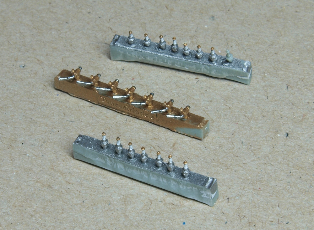

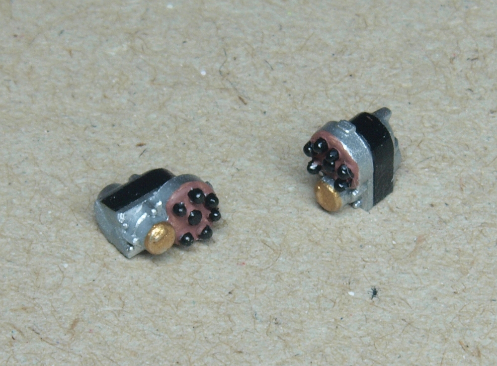

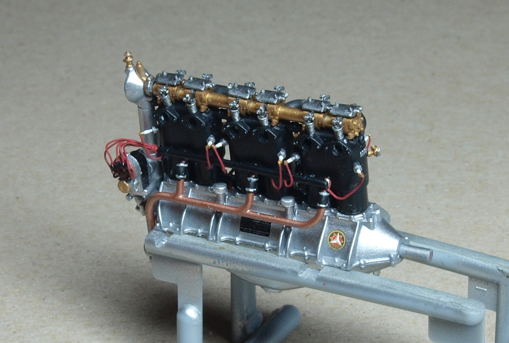

Weekend is gone but some colours were added to the engine bits...

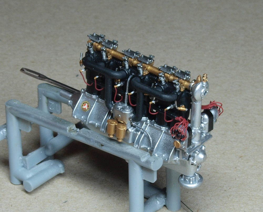

« Reply #29 on: December 12, 2018, 09:55:48 AM »

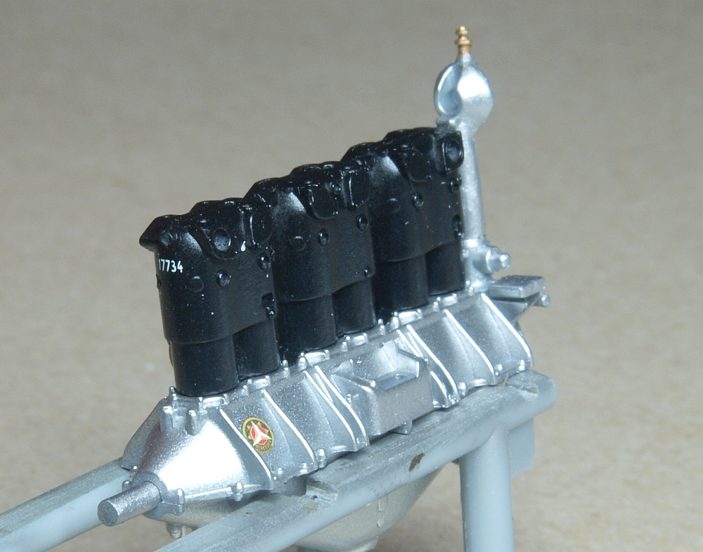

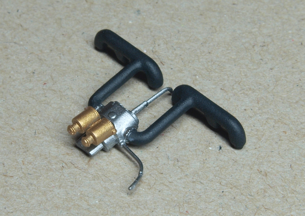

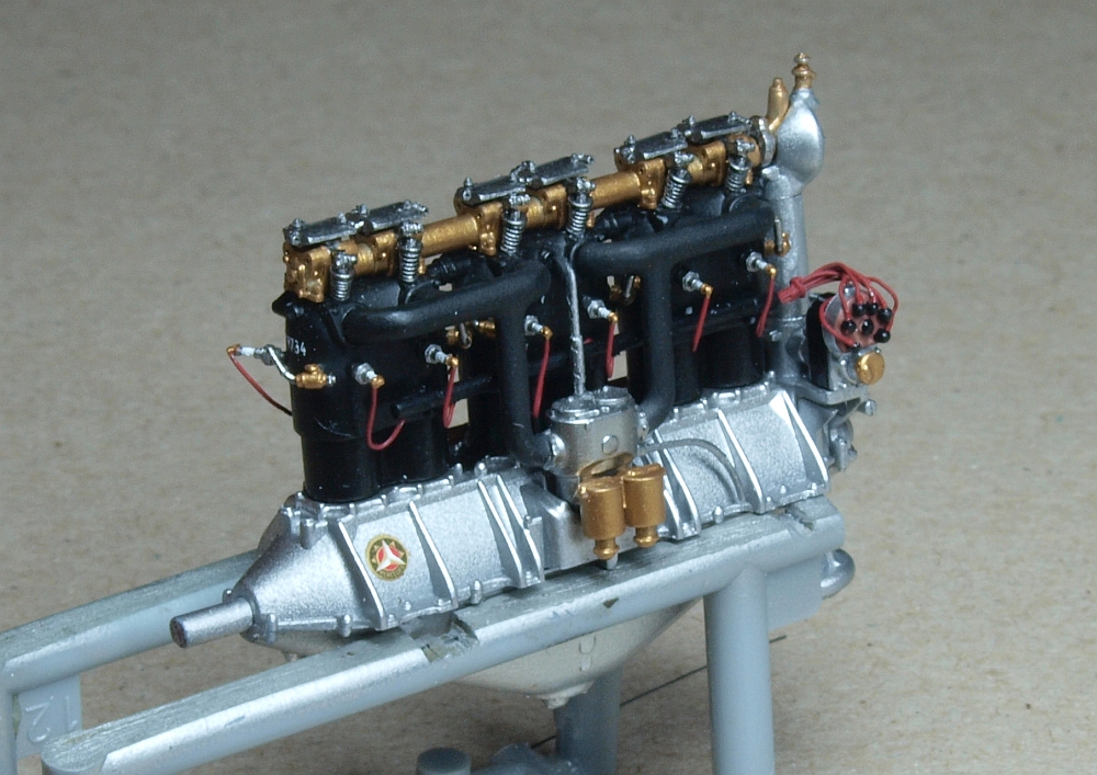

And some more fun with Mercedes D.II engine
