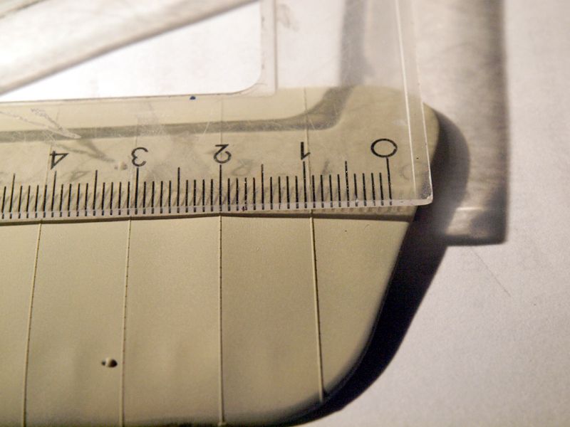

here is the wing:
as you can see, the ribs are very very thin... how to preshade those?  ???

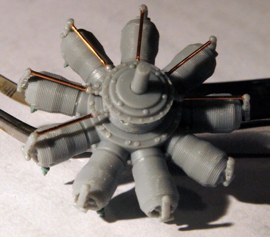

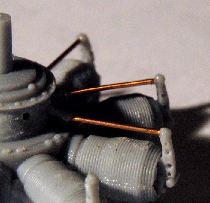

Here is the engine:
As you can see, I drilled out the holes in the rocker arms and substituted the....     ::)  don't have a clue how to call the 'stick' with copper wire but I mantained the bottom part.

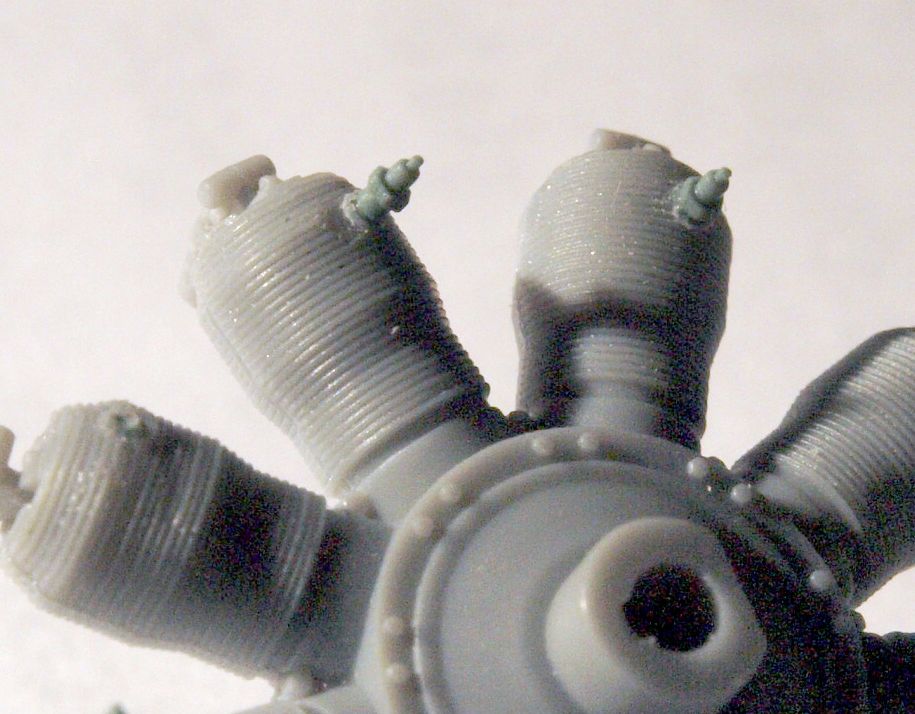

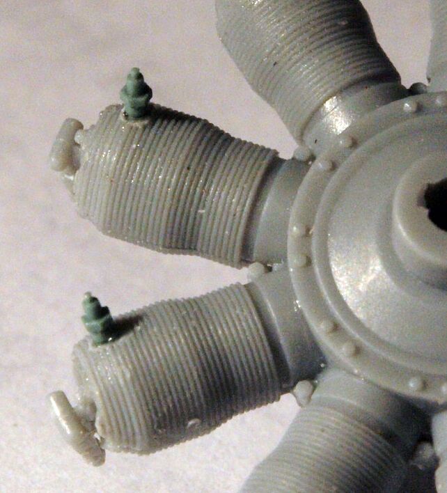

This is the reverse of the engine where I added Taurs Model sparks. They are very good, but I installed them BEFORE the rocker arms, which turned out to be a mistake as some broke off (resin is of course very fragile).
Any comment is very appreciated!

As you can see, I drilled out the holes in the rocker arms and substituted the....       don't have a clue how to call the 'stick' with copper wire but I mantained the bottom part.
Hi Edo.
Pushrod is the word you are looking for

As to preshading the ribs a tip I picked up from a magazine a while back would be to prime the entire surface, preshade the ribs with a black (you decide the thickness of the line), then gently sand back the raised rib to the lighter primer colour and hey presto you have your light and dark shading.

Preshading,I'm not sure how or even to attempt this, Apparently overpainted with opaque finish dopes the eindeckers may look okay drybrushed or using pastels/filters instead.  Looking forwards to dirtying mine up though  ::)

here is the wing:
Aizu has 0.4 mm wide masking tape. I use it for postshading in 72nd scale. And I suppose it would be just fine here, too.
BTW, how do you find the engine cylinders built from two halves. Is the joint very much evident? (I see it surely at the photos, but how it is in reality?) I am contemplating the option to replace the entire star with resin from Vector.

Interesting observations Edo.  Those are called pushrods.  If I get this kit, I will follow your blog.  As it is I have a stash of other WNW kits that beckon as well.  Your engine looks great so far and I see what you mean about the ribs being thin.  Des Uses a pencil maybe that technique would serve you better rather than pre-shading.  I prefer to preshade, but; in some circumstances like the present, it may not be the best.
