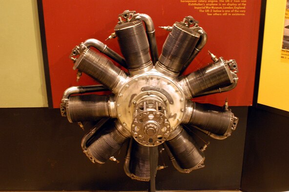

Hiya - just curious about this engine - the intake pipes seem to traditionally be depicted in a copper or burnt color on models and a few examples of the real thing I can find pics of, yet others, like the one on the TVAL Fok DVIII, the pipes are "silver" (aluminum?) color. Just wondered if there was any rhyme-or-reason to what is accurate for a 1918 engine? Maybe can be either? Thoughts?
Thankya!

Take your pick:
http://www.nationalmuseum.af.mil/Visit/Museum-Exhibits/Fact-Sheets/Display/Article/197463/oberursel-ur-2-rotary/
http://www.enginehistory.org/Museums/LeBourget/leborget.shtml
Looks like there is some research to be done here. Are they both actually the same engine type?
Richard

I remember "Hearing/reading" that one had copper and one steel?. I don't remember for sure but I think the Lehrone was the copper piped one. I am sure I will be corrected if I am incorrect.

As far as I know there were two types:
- early types has curved pipes made from copper
- later they run out of copper, so there are straight one (easier to manufacture), made from steel
Here are the intake pipes of the Small Stuff kit, you will see the difference:
The picture above shown by RLWP shows the steel one, used in later Dr.I and in E.V ( so I used also steel for my model).
The copper variant can be found one the rotary of the Richthofen Dr.I in London:
Source:  https://de.wikipedia.org/wiki/Datei:Iwm_Oberursel_engine.jpg
