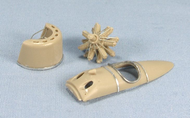

With work being so busy the last few months, and a move of house recently, I haven't been at the modelling bench since the end of May when I finished a Roden DH-9.  Now that I have the modelling bench set up at the new house, I have finally gotten the smell of plastic cement back into the nostrils. I wanted a relatively simple build to get back into the swing of things, so I pulled the 1:72 Eduard Fokker E.IV (non-profipack) out of the stash (I figured a simple small scale monoplane would be some nice simple fun).  I got in a good couple of hours this afternoon, and though I wanted a nice simple build, I couldn't resist the urge to "tweak" things a little - as a result, progress hasn't been great but at least it's some progress!

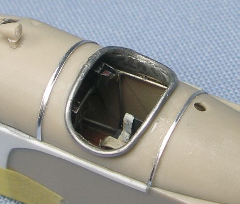

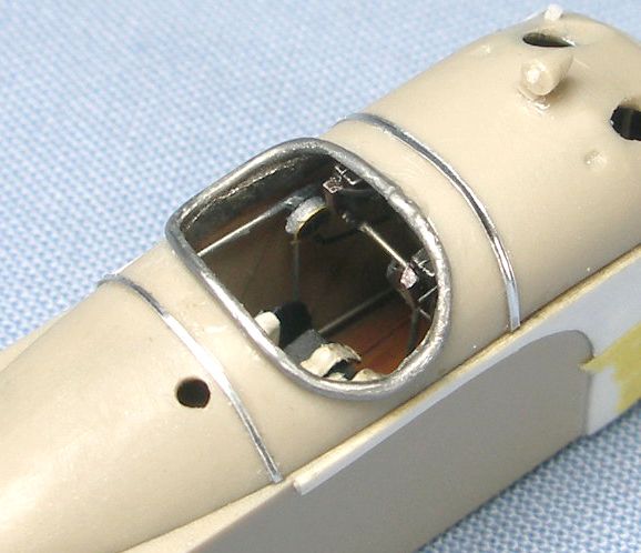

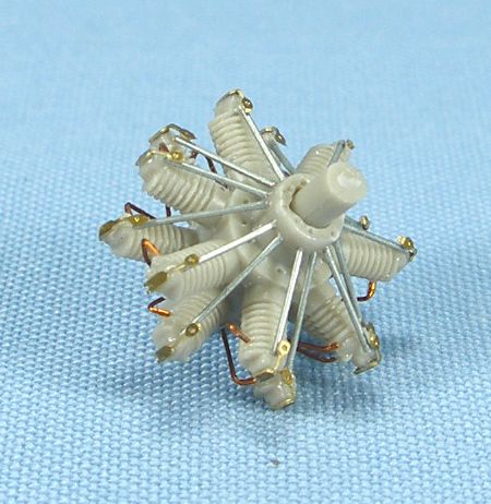

So far, I have added some pushrods to the engine, and made some additions to the cowl and upper decking. I also sanded off the softly moulded thick cockpit coaming and replaced it with fine solder, whilst widening the opening a little too.

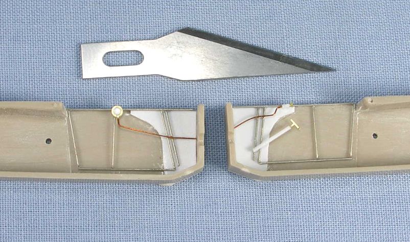

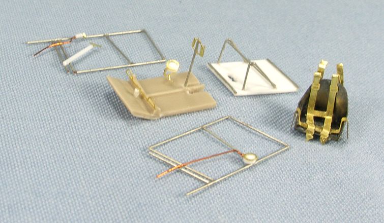

I then got to work on the cockpit. I sanded off all of the interior detail, and made up some framing from fine wire (I had to keep the frames a little short so the modified floorboards would fit). I also made up the seat frame from fine wire as well. The seat came from an Eduard etched seat set I had in the spares box. Other details came from a "Tom's Modelworks" German Interior etched set, or scratched from sheet and rod plastic (and yes, I now realise the compass is surplus to requirements :) ).  I didn't go particularly overboard but I think it's an improvement over the basic kit contents.
Next I will put together the tiny machine guns, then can work on painting up the interior.

Beautiful work so far Brad, your attention to detail is incredible and to do it in 1:72 scale is even more amazing, your engine is superb.

Brad, on your first pic, what have you used around the cockpit, and over the top of the fuselage piece?

Excellent attention to detail. I'm guessing that the actual engine is at least 5 times smaller than the photographic image of the engine in the 2nd photo.

Warren - the fine metal strips over the top of the fuselage piece is foil - I use the foil you find sometimes on the inside of coffee containers used to seal the coffee - this foil is quite fine and able to be cut and glued easily with superglue.  The coaming around the cockpit opening is a fine solder, again, easy to bend and to glue with superglue.

BTW..... Great idea using solder. I have various sizes of fine electronic  solder but, I never thought  of using it for models.
I will definately  keep this in mind for future builds for  whatever. :)

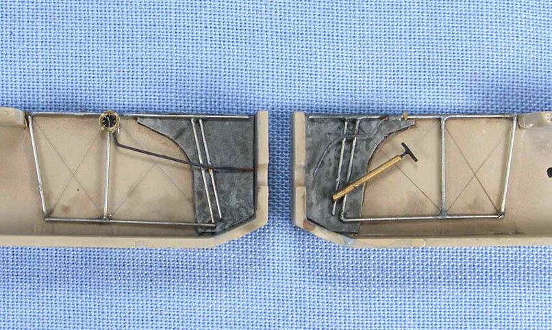

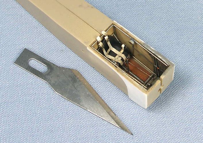

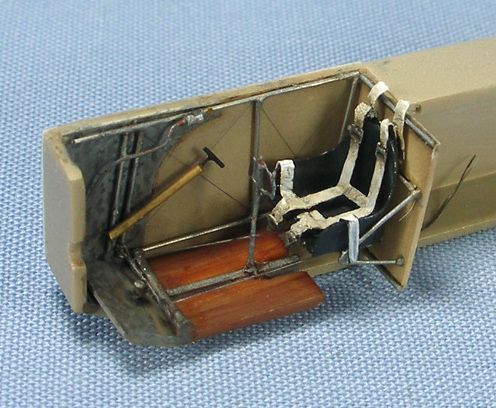

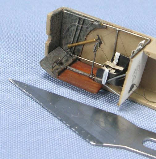

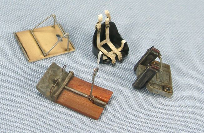

Cockpit has some paint on it now:
And the engine:
Time to button up the fuselage!
BC

Cockpit and engine  looks fantastic.

Amazing work, Brad.  Looks like 1/48 scale.
