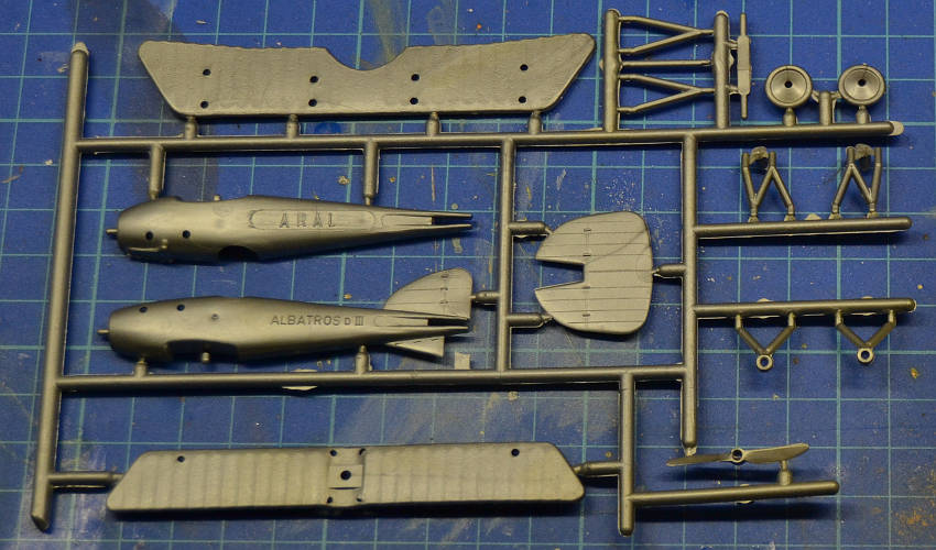

The kit is terrible and is in 1/96 scale! Half of my favourite scale 1/48.

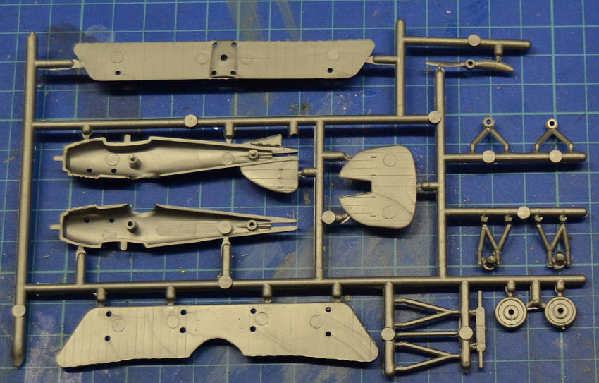

Here are the pictures of the sprues:

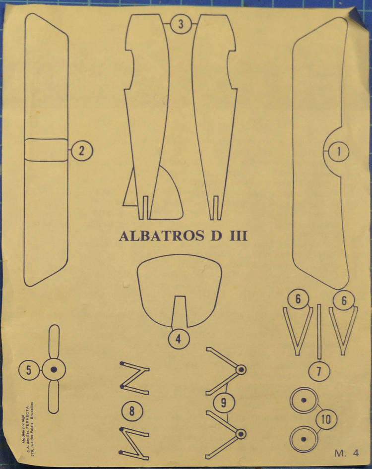

here are the "instructions"

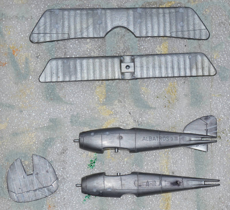

Yes Rick, it is fair enough, but it lacks the panlelines, the tail planes both vertical and horizontal have wrong separation lines for the moving parts, the top wing has no ailerons traced.
I spent all my modeling time today in sanding off the ejectors marks and I begun tracing some lines.
Soon some pictures.

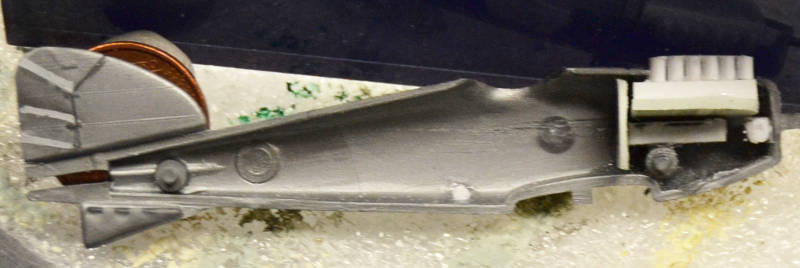

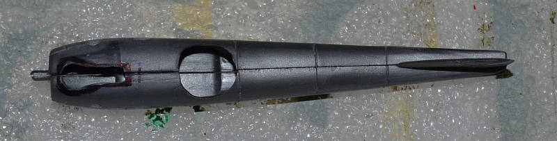

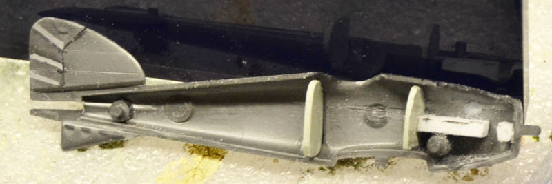

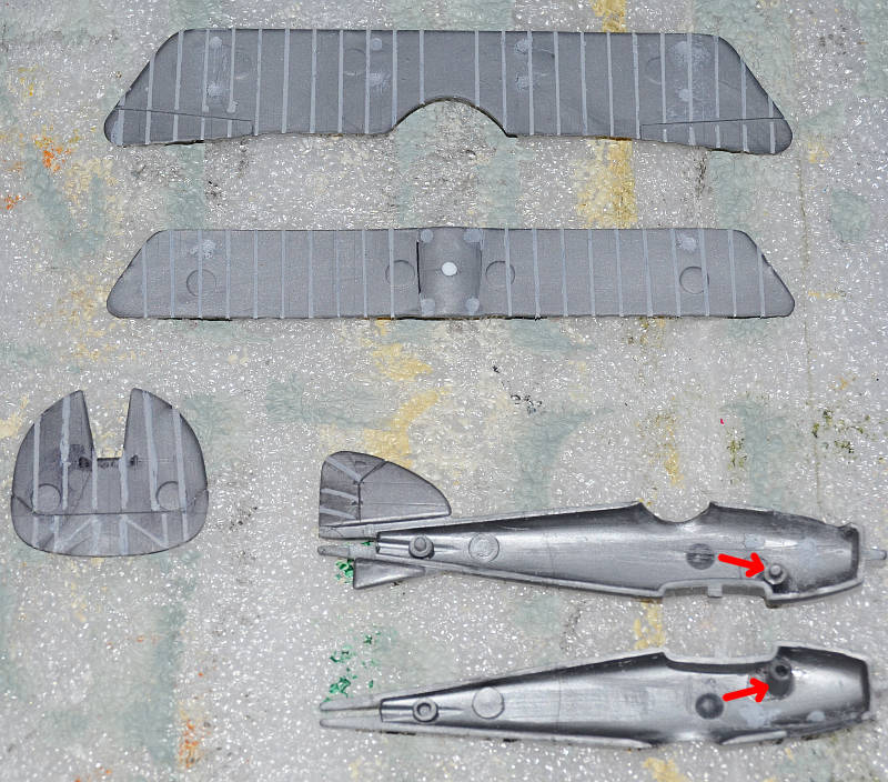

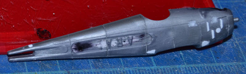

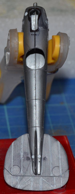

here are a few steps ahead:
I used MR.SURFACER 500 to give the ribs a little thickness
The forward pin to close the fuselage was in the cockpit, so I moved it forward to leave space for some "furniture" ... (see red arrows)

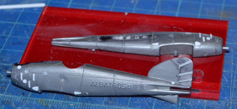

All the holes were filled with putty, I will re-open those I'll need. For example the undercarriage position was totally wrong
I sanded away all the ejection marks and writings on the side of the fuselage, although they appear still there I have coloured the parts with a black marker and they disappeared. Then I sanded away the colour again.
Let's cross our fingers!!!
I traced the panel lines on the fuselage and retraced the rudder and the elevators
Pannellature sulla fusoliera e tracciamento degli alettoni, del timone verticale e dei timoni di profondità

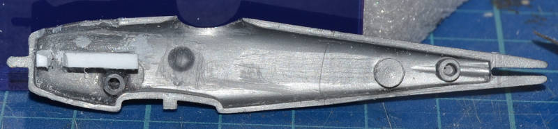

I made a slot to put the engine that I should build from scratch...
And I decreased a lot the thickness of the plastic on the edge of the slot and of the cockpit opening.
Ciao!
Antonio

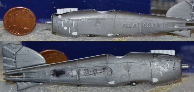

Hallo here are the progresses of this weekend:
Details added to the fuselage (in white):
I made a rough approximation of the Mercedes engine, here are just the 6 cylinders to start...
Some details for the cockpit:
