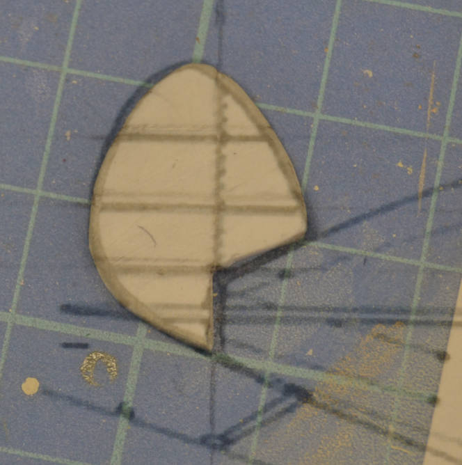

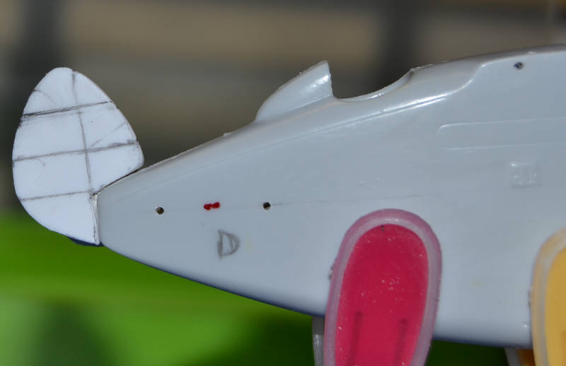

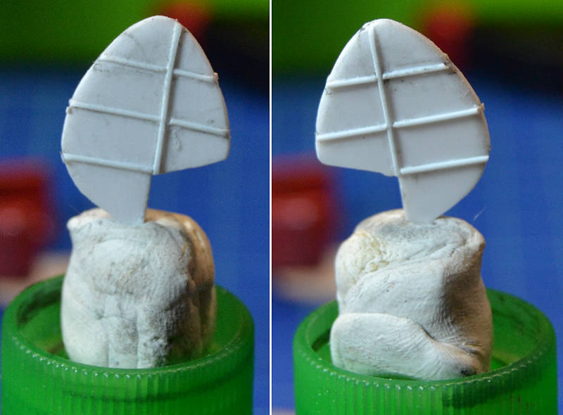

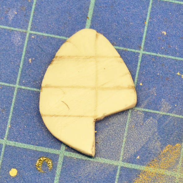

Hallo, during the weekend I was able to work a bit scratchbuilding the rudder:

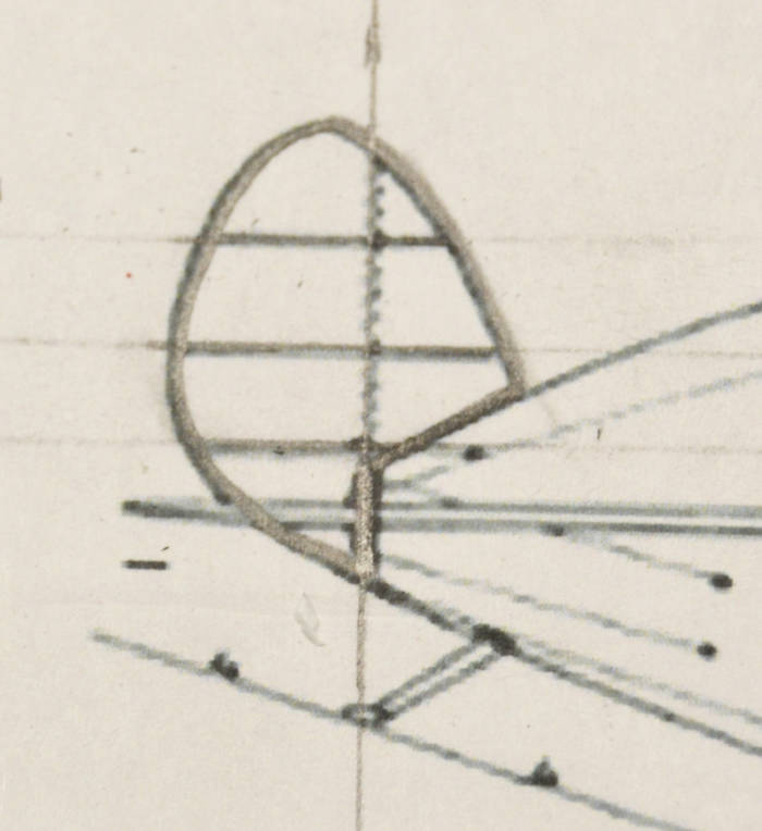

I took the three view plan quoted above and traced the rudder with a pencil using copy paper onto the plasticard sheet (1.5 mm thickness).
Then I cut the piece from plasticard sheet
It seems fair enough...
(the transparence was done using GIMP overlaying the two images above)

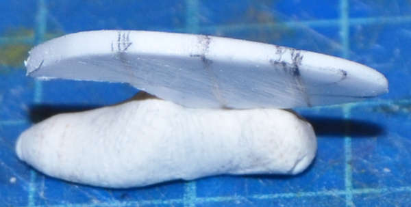

Here the rudder is temporarily stuck with low tack plasticine

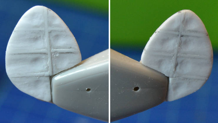

I made it thinner towards the top

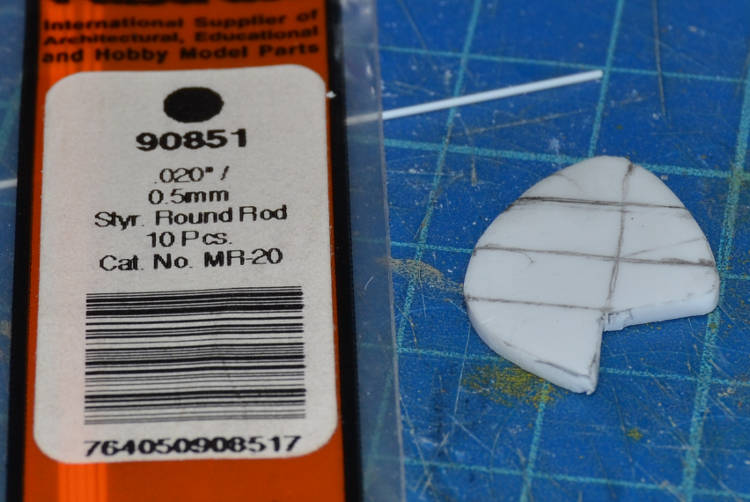

Then I scribed small grooves over the framing traces and glued some plasticard rod (diam. 0.5 mm) with the geen cap glue
That's how the piece looked like after this operation
I sanded evrything off and milled the surface to give the impression of the linen. I used a spherical head, it's OK but after seeing this photo I went on milling a bit more to avoid this evident spherical hole (but I did not take any further photo, will do later)

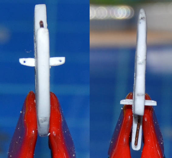

Last operation was to insert into the rudder the control horns and the pin (made with copper wire 0.4 mm diam.) to be inserted in the fuselage
Thanks for the attention!

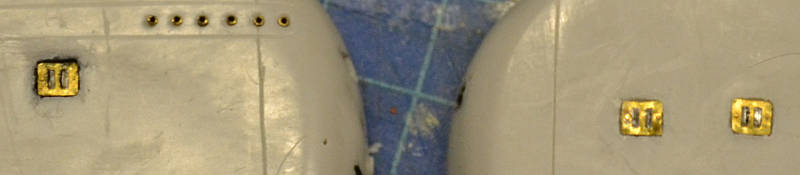

Hallo everybody,
some work done on the fuselage

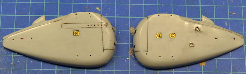

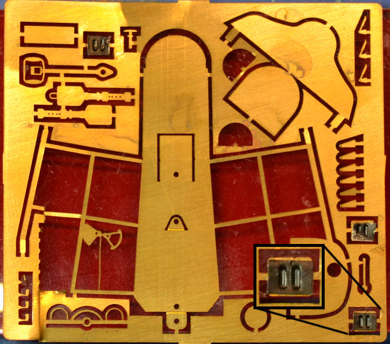

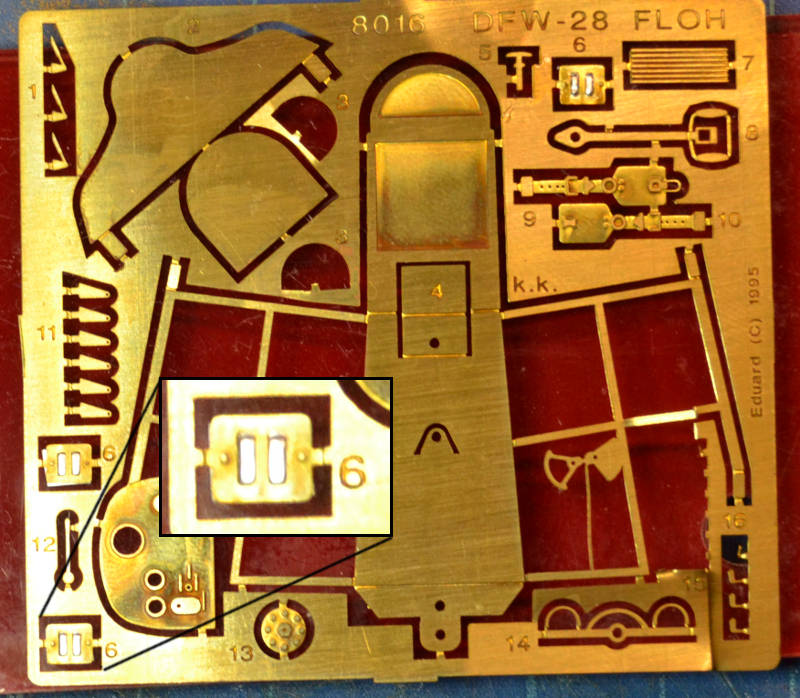

I wanted to reproduce the louvres on the two sides, which are represented by piece no.6 in the PE fret.
I glued squares of "lead" cut from wine capsules behind each piece no.6:
then I pushed the lead into the holes with a tootpick, and in the end I cut the back side of each louvre with a scalpel.
Here are the pieces glued in their position.
Here I tried to photograph (with horrible result) the louvres from the back to show the final effect.
I hope the final result after painting will be better.

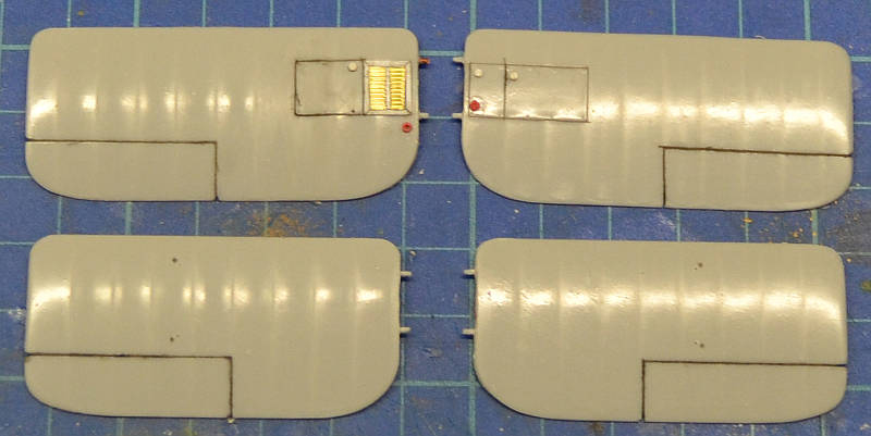

This is the current state of the two halves, I scribed the front panel (used to remove the engine for operations... really uncomfortable I guess)
Both on the fuselage and on the wings I experimented tamiya panel line accent black.
The result is good, I'll probably use it again after painting if necessary.

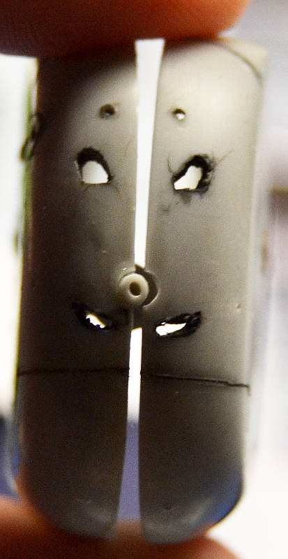

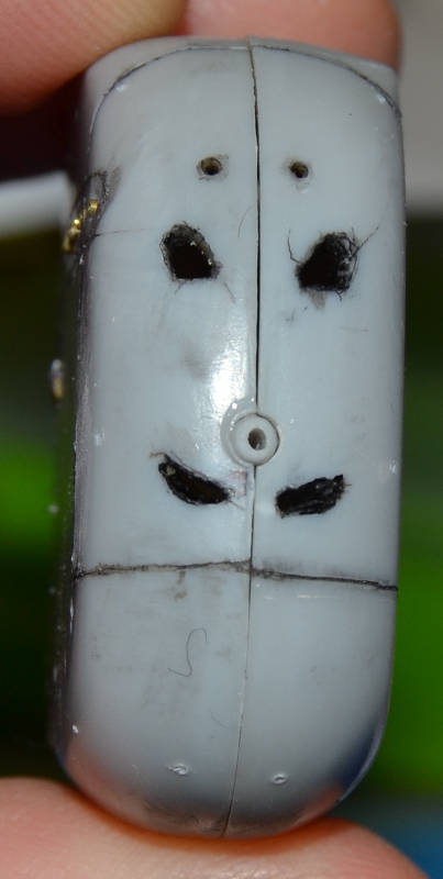

The openings on the plane "face" are supplied as decals, I don't like that solution so I carved them in the plastic and painted black inside.

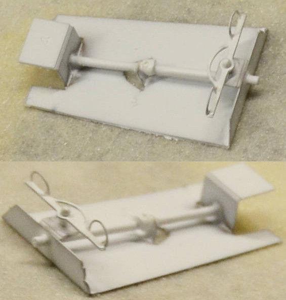

with the help of some days off duty I have made some progresses on the work:

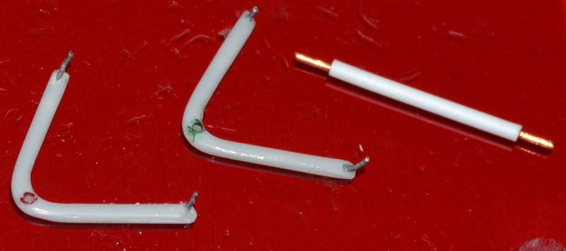

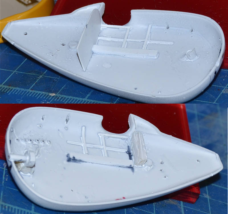

I decided not to use the photo etched "flat" struts and created an inner structure with 0.75 mm square plasticard rods.

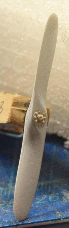

In the meantime I sprayed all the pieces with white tamiya primer, here is shown the propeller with a fokker boss...

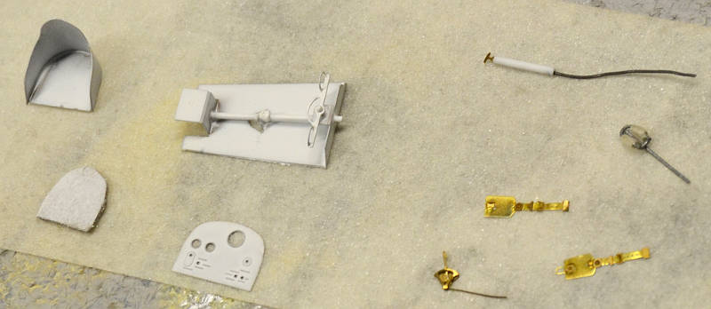

in this picture some photoetched pieces I worked on ready to be painted:
- seat + cushion
- cockpit foloor with some elements added
- control column totally scraatrch built with some zinc thread
- fuel pump made from plasticard and lead wire, with the handle coming from the PE fret
- seat belts from the PE fret wait to be painted
- dashboard was primerized and is waiting for some work
In these 2 pictures the cockpit floor, the longitudinal bar and the pin for the pedals were put by me. The step on one side is where the seat will be placed.
I'll start painting later this afternoon.

Looking at the holes in the plane nose, I would say that they would deserve a slight touch up with a round file. Their placement will be quite prominent on the finished model.
Ondra
« Last Edit: December 28, 2016, 05:39:05 AM by ondra »
Re: DFW T.28 Floh (1/48 Eduard - 1995)
« Reply #43 on: December 28, 2016, 01:50:51 AM »
Thank you Ondra, I will see how to improve the front holes, actually the lower right one is out of alignment, now they appear as black blobs, I think theyll look betteronce the whole nose will be painted.
Antonio
