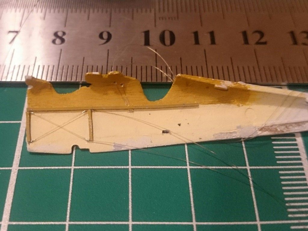

Thank you all so much for the very kind words and encouragement. At the moment it feels like one step forward and12 steps back! I wasn't happy with how some of the fuselage frames lined up with each other across the two sides and in trying to fix it ended up making a terrible mess and having to start over. So here is where I am right now. I've also tried to add a little graining detail into the wood and something I forgot last time which was the wires for the cabane struts.

Been there and done that! You are recovering quite well! Looks terrific .

Thanks! I am trying to use it as an opportunity to practice patience as I came very close to throwing the whole thing in the bin!
I am also using Plastic Weld for the first time and so far I'm quite impressed. It has allowed me to get the evergreen strip on much more neatly than the superglue I had used previously which was just too quick and allowed for zero adjustment once the strip was down.
I was very worried that the plastic weld would melt the strip but it hasn't (yet!)

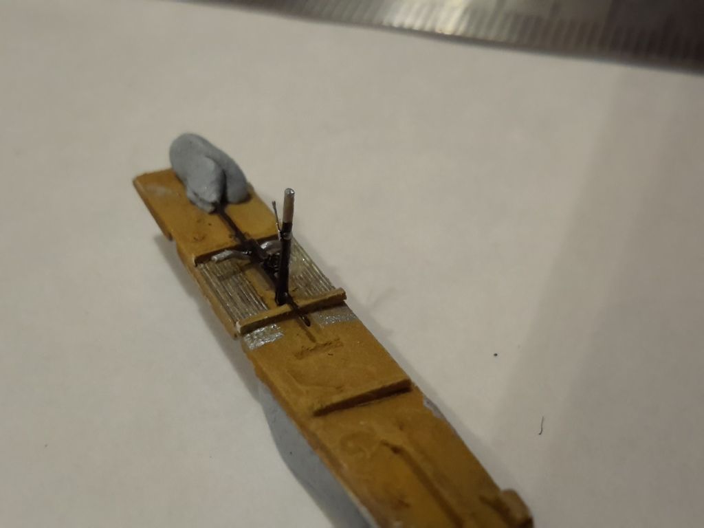

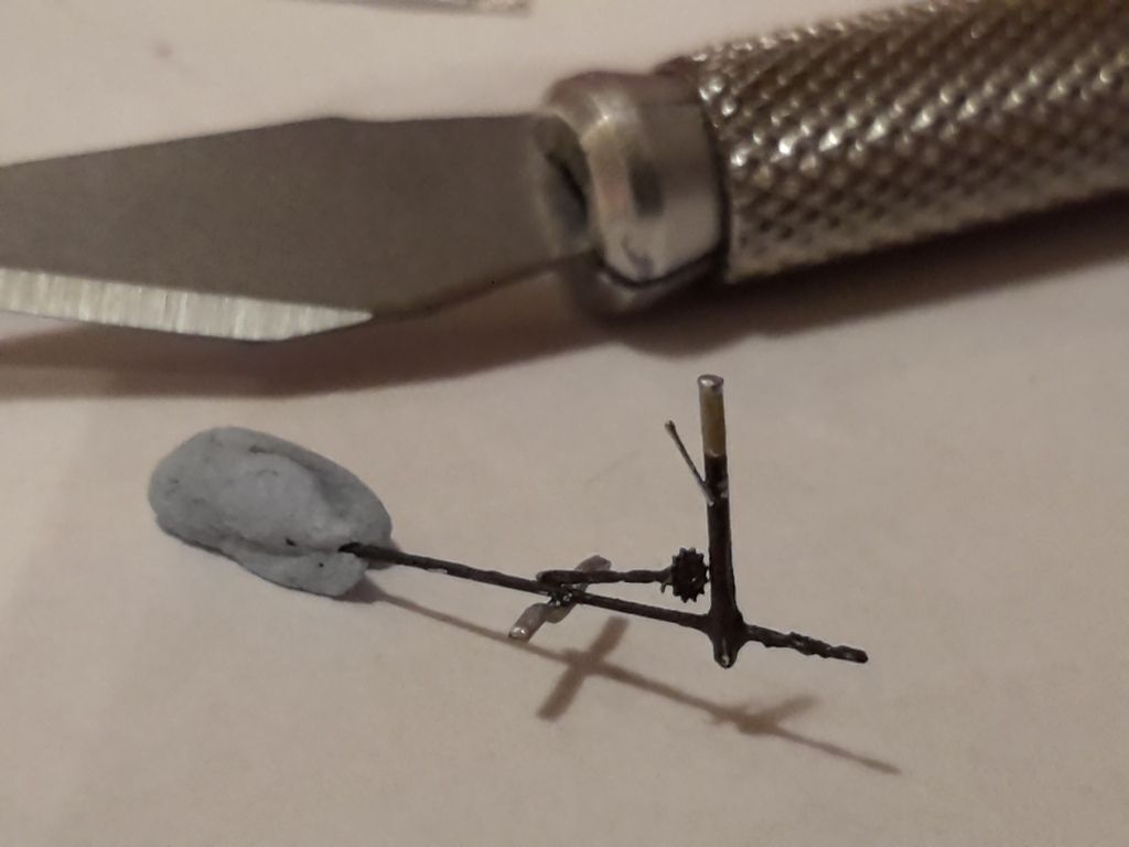

A tiny (literally!) update: after spending much of yesterday evening feeding the carpet monster with early attempts I have more or less finished the control stick and rudder pedals.
The control stick itself is a fine sewing needle which I cut down after putting a tiny drill bit through the eye and glung in place. The rudder pedals are just a piece of wire bent into shape and the angled part is another micro drill bit topped with a spare bit of photoetch.

Of course close up it all looks a bit messy but hopefully should look OK once everything is put together.

If that is supposed to be messy then all that I can hope is that the person looking at the completed model has a microscope on their nose to see it! That is incredibly detailed and fine work in this scale - it would not disgrace on of the much larger scales.
