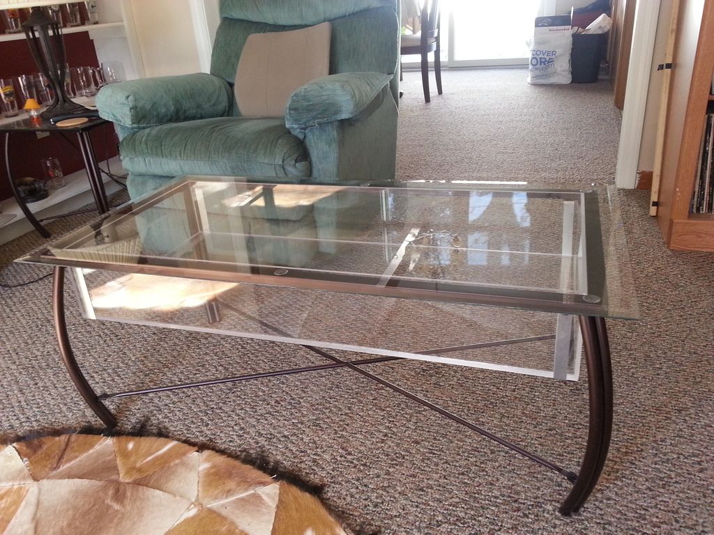

I'm sure most of us have a problem with a lack of space, especially for those big models. I needed a new coffee table recently and spent quite a while online trying to find one with a display case under it, just for that purpose. No luck, so I bought one with a glass top with the intention of making my own.
 I measured it up and ordered the perspex from TAP Plastics in the US. They have a whole series of helpful videos on how to glue, build a box, finish the edges and much, much more so I went for it. After emailing them for their recommendations, I went for 1/4" thick sides and 3/8" thick bottom. The bottom is just over 17" x 37", and it has a depth of 5 1/2" - big enough for a Staaken and a few others!
 It wasn't cheap: the perspex, glue (actually a plastic weld solution), and applicator, came to $160 including UPS delivery in the US. Another $7 or so for some aluminium strip to make straps to attach it to the table.
 I glued it all together yesterday, then today I routed the corners to round them off, and made up the straps. I still need to heat treat the edges to tidy them up but that can wait for now...
 Very pleased with my new custom display case!

Excellent job just the place to store some models but how do you open it to put the models in?  Remove the straps and lower it down? or does the end come off?

Dave...just lift the glass top off!

Nigel, I took a few bits out of boxes to get a rough idea of what might fit. It should take a 1:72 Staaken, Felixstowe, and Ilya Muromets. (Surprisingly, the Felixstowe is the smallest of the 3!). I could replace the Staaken with a couple of Gothas. So not too bad!

Many years ago my late father and I constructed some wood framed perspex boxes with bases - basically they are large enough for one large model each (HP 0/400, Vimy, etc, but can take two/three single seaters. They also stack (two) easily because they are slightly different sizes. The big advantage is it keeps the dust off!
