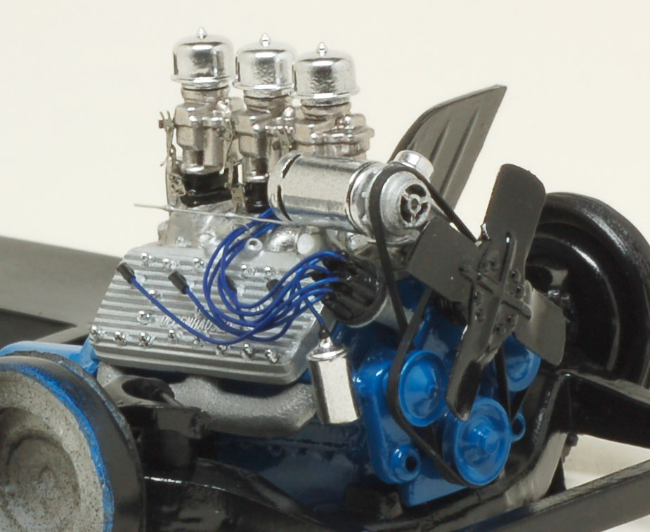

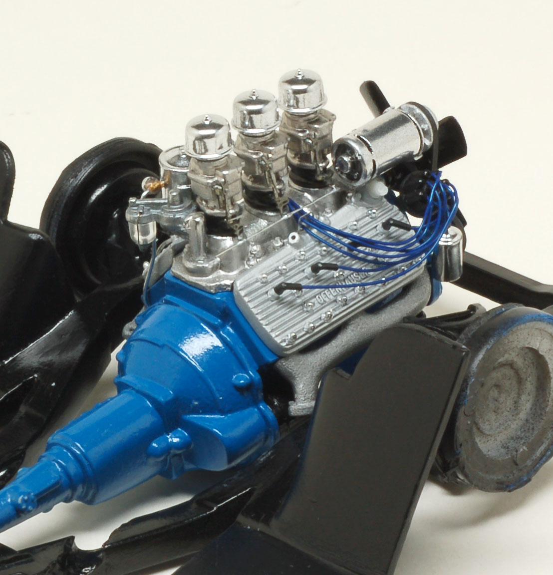

I've made a few 1/25 automotive carburetor linkage parts by making 2 sided artwork & printing it on Press-n-Peel Blue film. http://www.techniks.com/how_to.htm
Print the artwork onto the film using a laser printer, & then iron the artwork onto the brass sheet. Registration can be a pain, & too much pressure on the iron can make the resist lines wider than scale, but it's a relatively cheap experiment if you have access to a CAD or vector program & a laser printer. I poured Ferric Chloride into a film canister & submerged the brass. While the results were not as clean as commercial etchers, I still came out with some one off, usable pieces.
