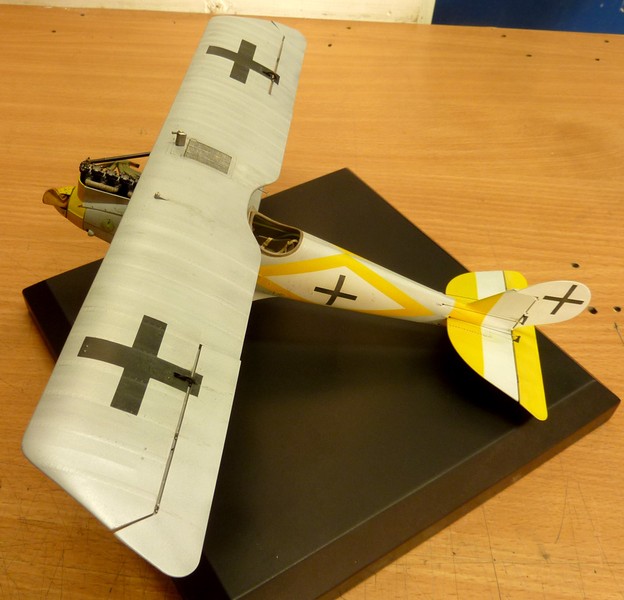

Rick,
    My personal choice is "more aluminum then grey". I found a mix in an article by Steve Hustad years back and really like the finish it provides: 2/3 ModelMaster Flat Aluminum and 1/3 their Medium Blue Grey #2055. This of course is the old enamel line, I'm not sure if it's still available. The finish appears like a very "flat" aluminum with a definite metallic appearance. I'd think you could mix similar colours of other products or mediums and get the same results with a little experimentation. Here's the results:
    Hope this helps, it's just one of many options I'm sure.
