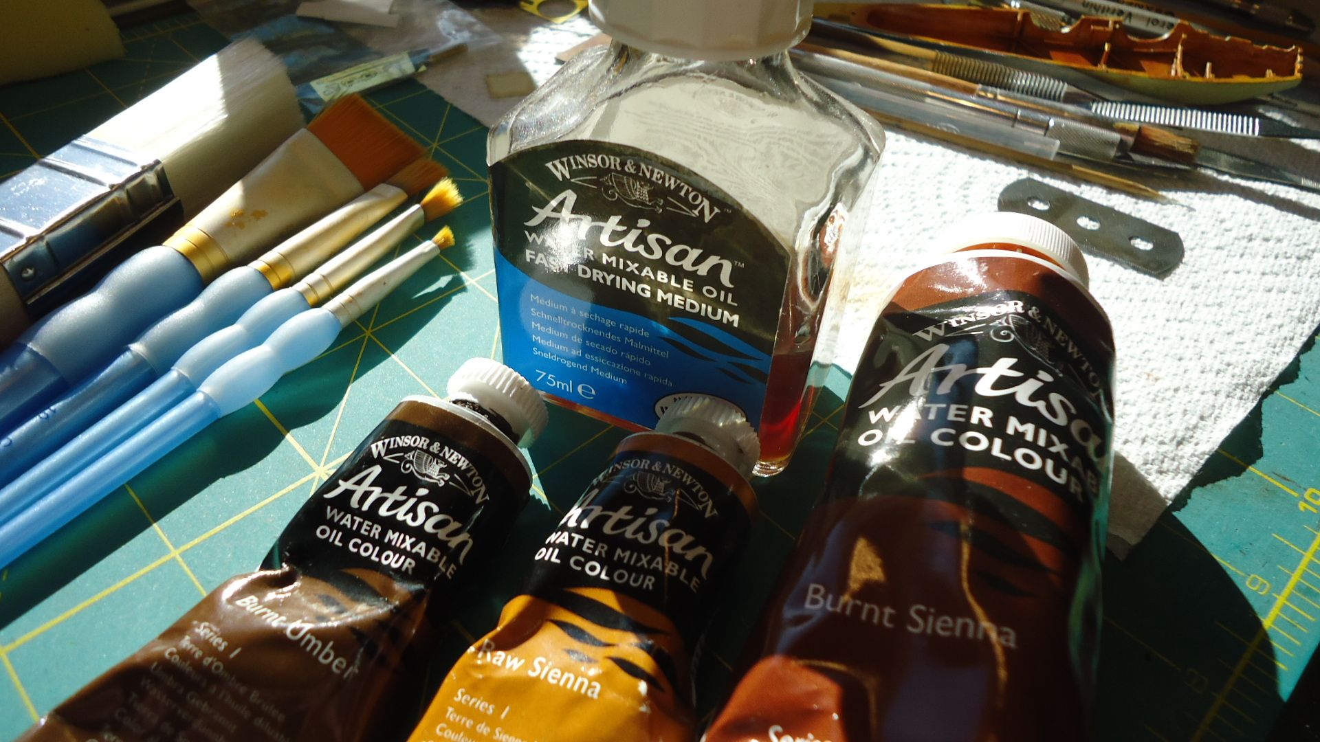

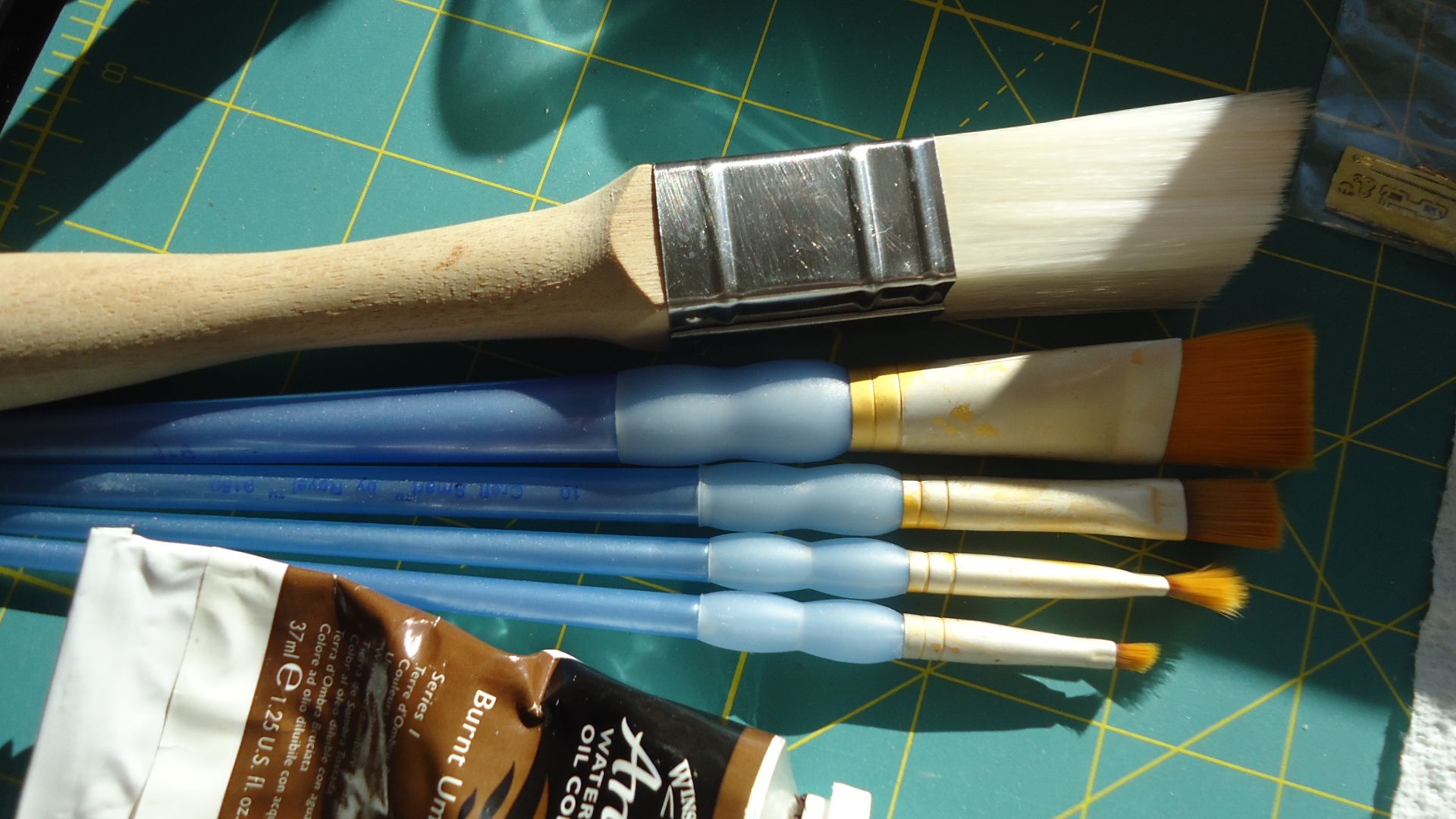

Thanks, guys!  First off, let me address the questions regarding my wood grain technique.  It's nothing special, really.  Pretty much what everybody else does.

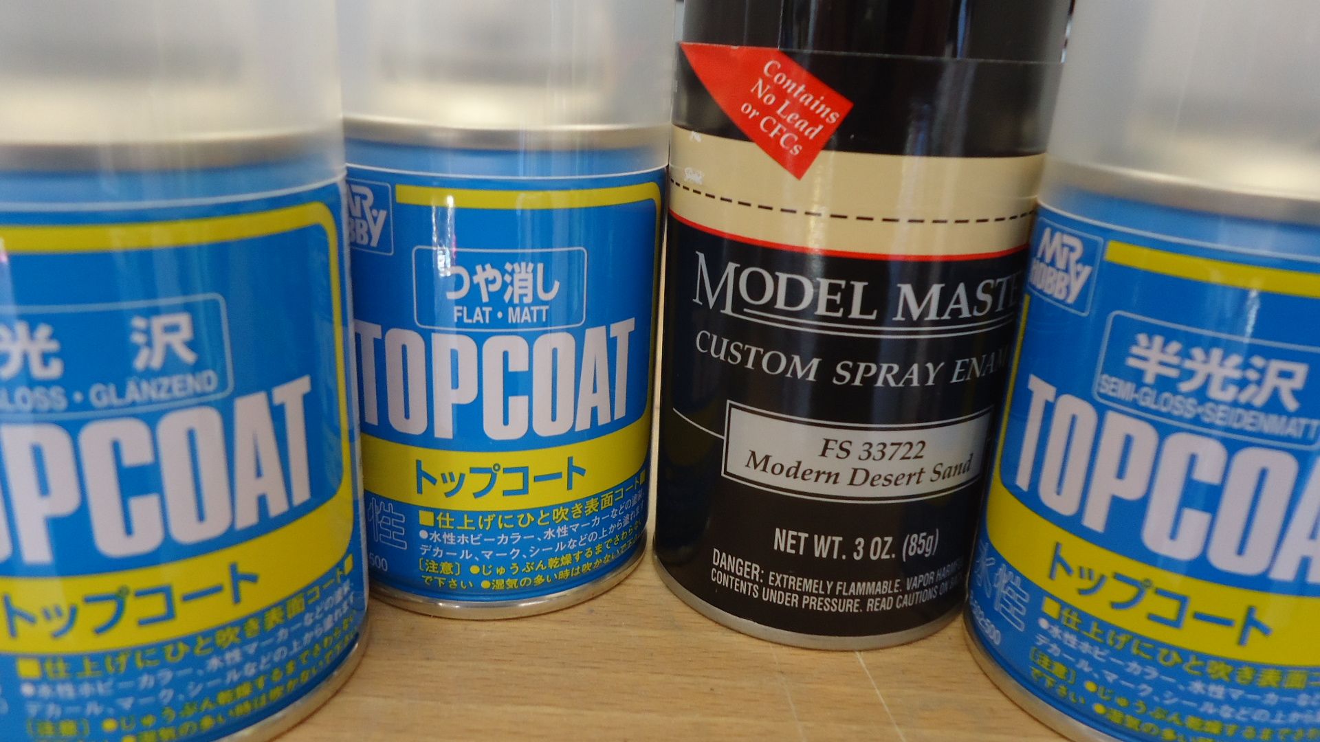

I start off with Model Master Modern Desert Sand in a rattle can.  Yeah, I know, it's sorta cheating and it's bad for me and the environment.  Whatever.   ::) Once that's good 'n dry, I spray a coat of clear gloss to enable me to work the oils more easily.
After the clear gloss has dried, I mix burnt sienna, raw sienna and burnt umber together, varying the proportions according to the finish I'm trying to achieve (for this application, about 50-50 burnt and raw sienna with just a touch of umber; for an Albatros, about 30% more raw sienna: for darker aircraft, like my Phoenix or Macchi, I used more burnt sienna and just a tad more burnt umber), and apply it with a very soft, medium sized brush, mixing in just a tiny bit of Fast Drying Medium.  Oh, I forgot to mention, I pre-shaded the framework with brown pastels before spraying the clear gloss.
Once I've got the oils on, I work the various panels with larger or smaller brushes according to panel size and shape.  While it's still a little damp, I smooth it out with increasingly larger soft brushes.
With the use of fast drying medium, it only takes about a day to dry and when it is, I spray clear flat and weather high wear areas with black and brown pastels.  I finish it off with clear semi-gloss.  That's about it.  Of course, I vary it all depending on the subject, but basics are about the same.
Hope that was somewhat clear.  I lost track.

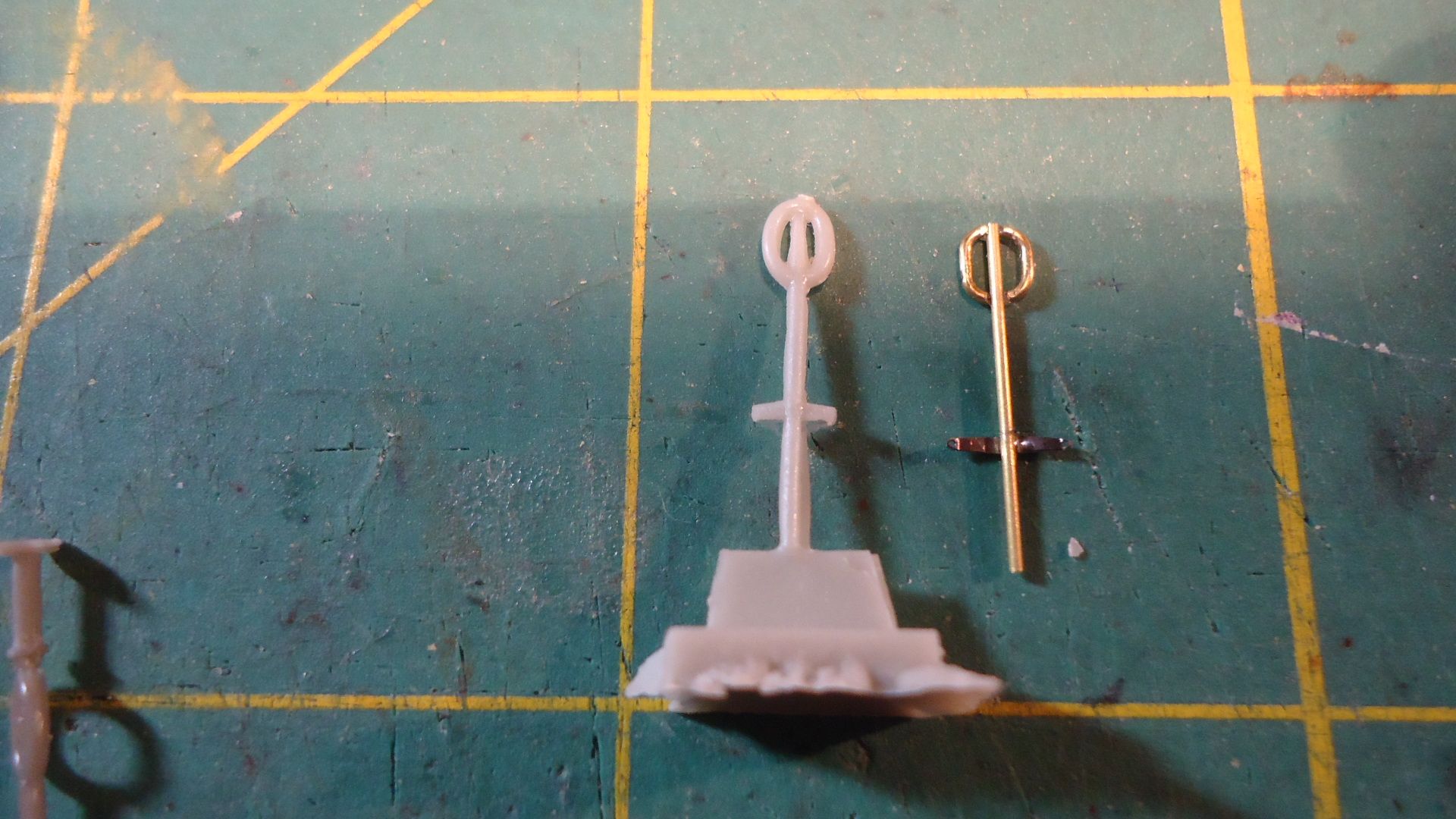

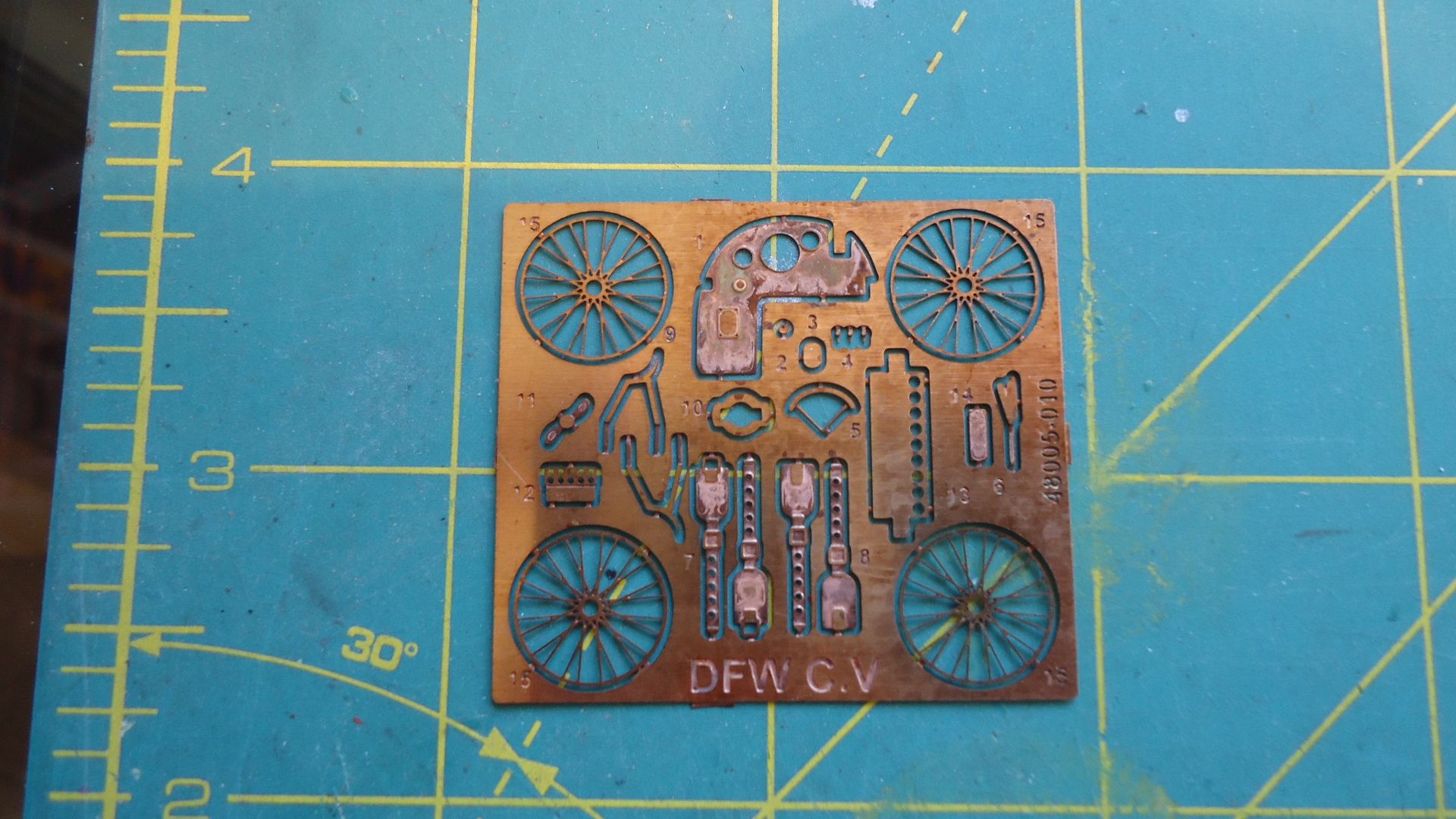

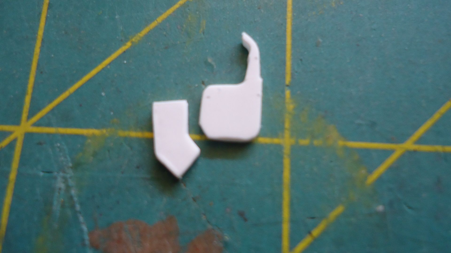

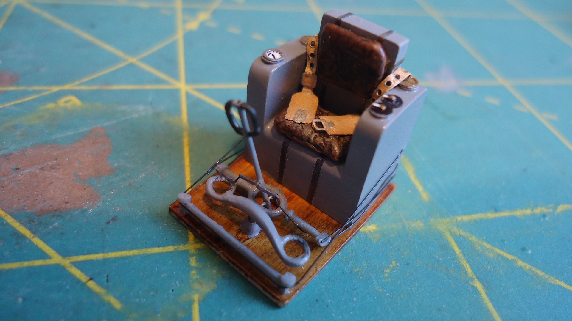

I've completed most of the components for the front office.  I felt the control column was kinda clunky, so I made a new one.

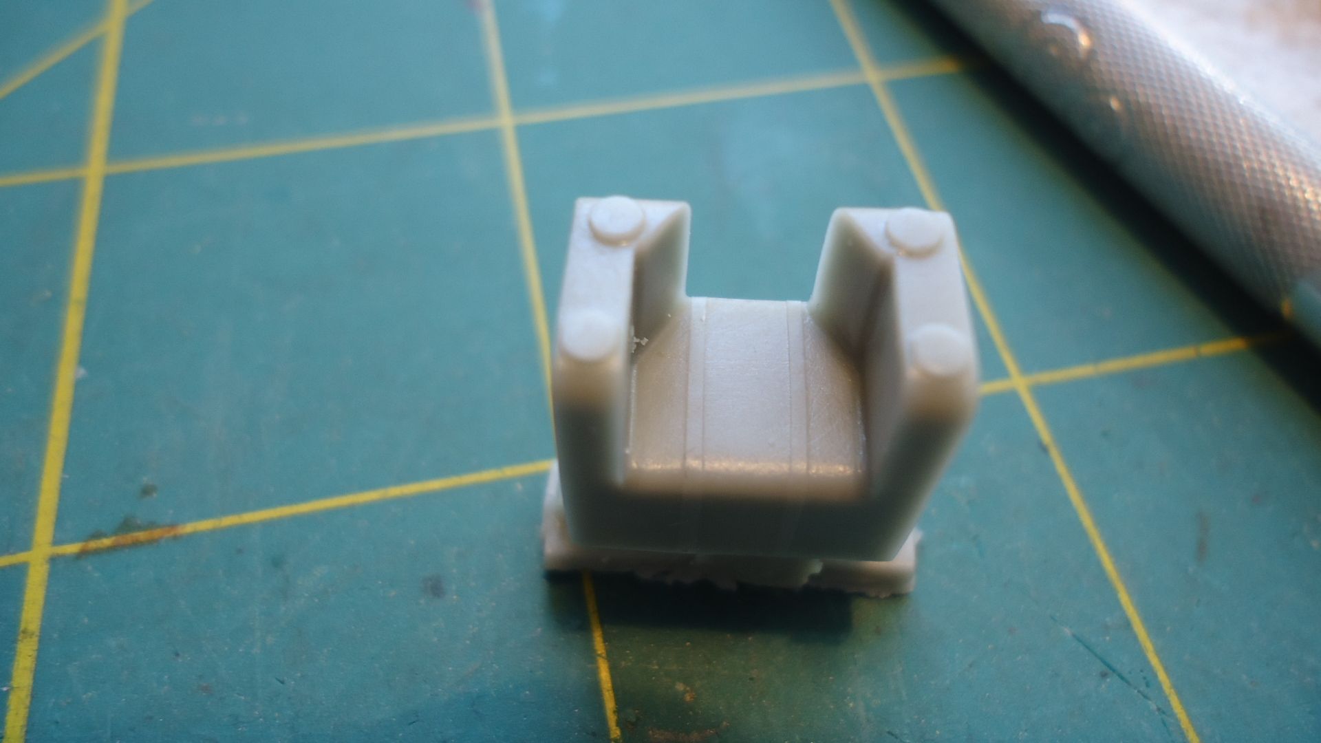

For the Pilot's seat, this is pretty much all ya get.  No padding, or auxiliary tank.

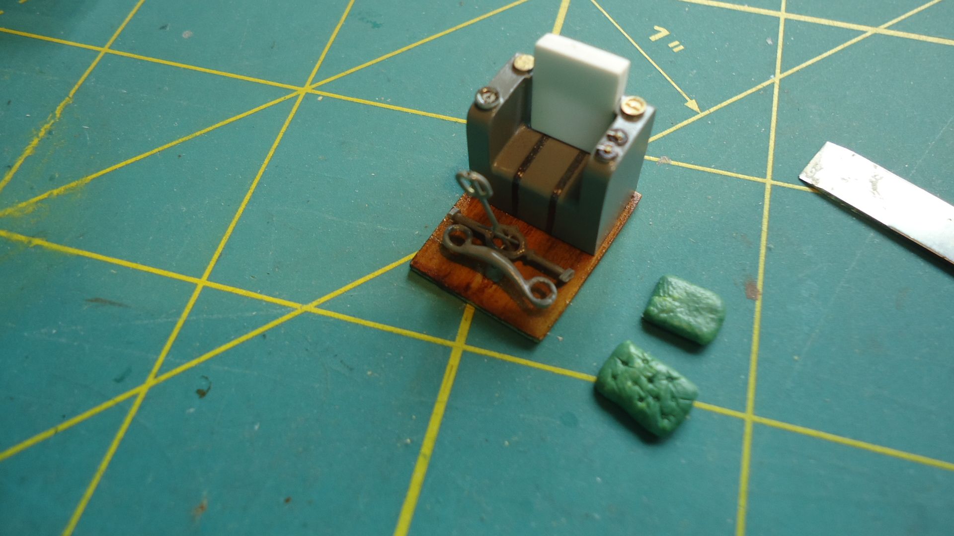

Had to make a few modifications.

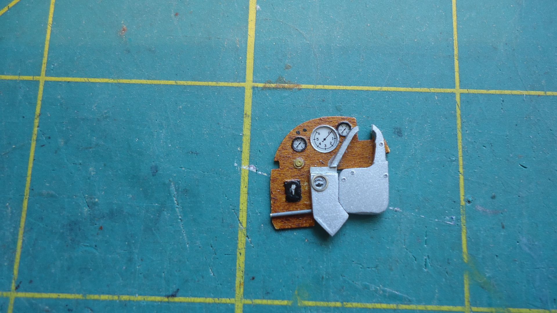

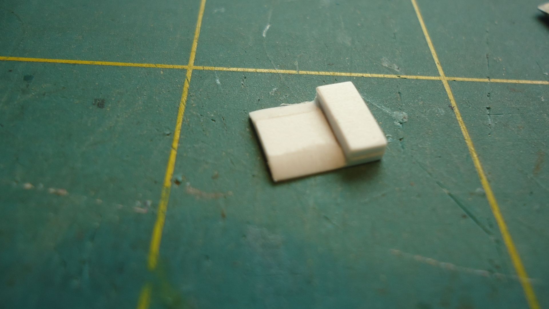

The kit instrument panel is okay, but there are no ammo cans, so I made some.
Not crazy about it, but it'll do, I s'pose.

Nice work on the control column Bud, and the instrument panel is excellent.

Thanks, Des!  It ain't WNW, but not a bad kit for 1/48 scale resin.  Beats the hell out of Omega, right?  By the way, the guys that did the Karaya 1/48 resin kits are now Silver Wings, making some very cool but very expensive "between the wars" stuff in 1/32 scale.  There's a teaser on their website hinting at a WWI subject in the future.  Fingers crossed.

Great work on the interior bits, Bud! Good moves to replace/enhance the kit parts. It is going ot be a stunner, I am sure.
