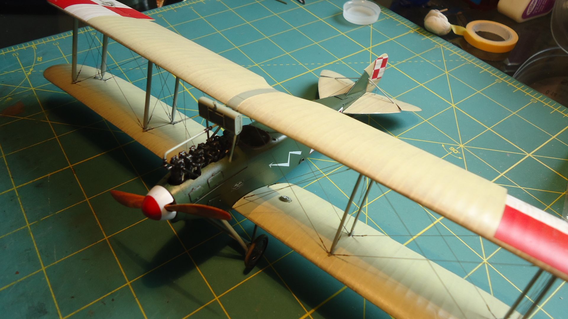

Looking good, looks like you have the turnbuckles aligned perfectly with the "wires"
Re: DFW C.V Late, Karaya 1/48 scale
« Reply #121 on: February 04, 2016, 09:49:06 AM »
Beautiful job with the top wing and the rigging Bud, this is turning into a superb looking model.
« Reply #122 on: February 04, 2016, 10:05:24 AM »
Thanks, Ed!  With the C type buckles, it was easy.  I simply wired an eyelet into one end, giving it flexibility.  With the A and B types, I had to do a lot of measuring and pre-alignment.  I had planned on using all C's.  Thought I had 60 on hand, plenty for this job.  Turned out one of the packs of 30 were 1/32 scale, so I just used what I had.  Ordered more, but by the time they got here, I was nearly finished rigging.  I recommend C types for all rigging because pulling the line tight pulls them into alignment.
Thanks, Des!  I'm using Przemo's beautiful model as a guide, so if it turns out okay, I owe it to his guidance and inspiration.

   Do you mean you made your own eyelets attached to one end of a "C" Type Buckle or actually attached one of Bob's eyelets to the Buckle? Whatever you've done you have certainly solved the alignment problem. Nicely done!
« Reply #128 on: February 11, 2016, 05:41:00 AM »
Thanks, Sasho and Lance!
Lance, on the C type turnbuckles, I run a piece of fine wire through one end of the turnbuckle, fold it at the center, pinch the ends together in a hemostat, hold the buckle with my left finger tips and spin the hemostat with my right hand until I have an eyelet.  I clip off the end leaving about a 16th of an inch, then glue it into the hole.  The turnbuckle will just flop around until you apply tension.  I hope that makes sense.  If not, I'll try to take pictures.

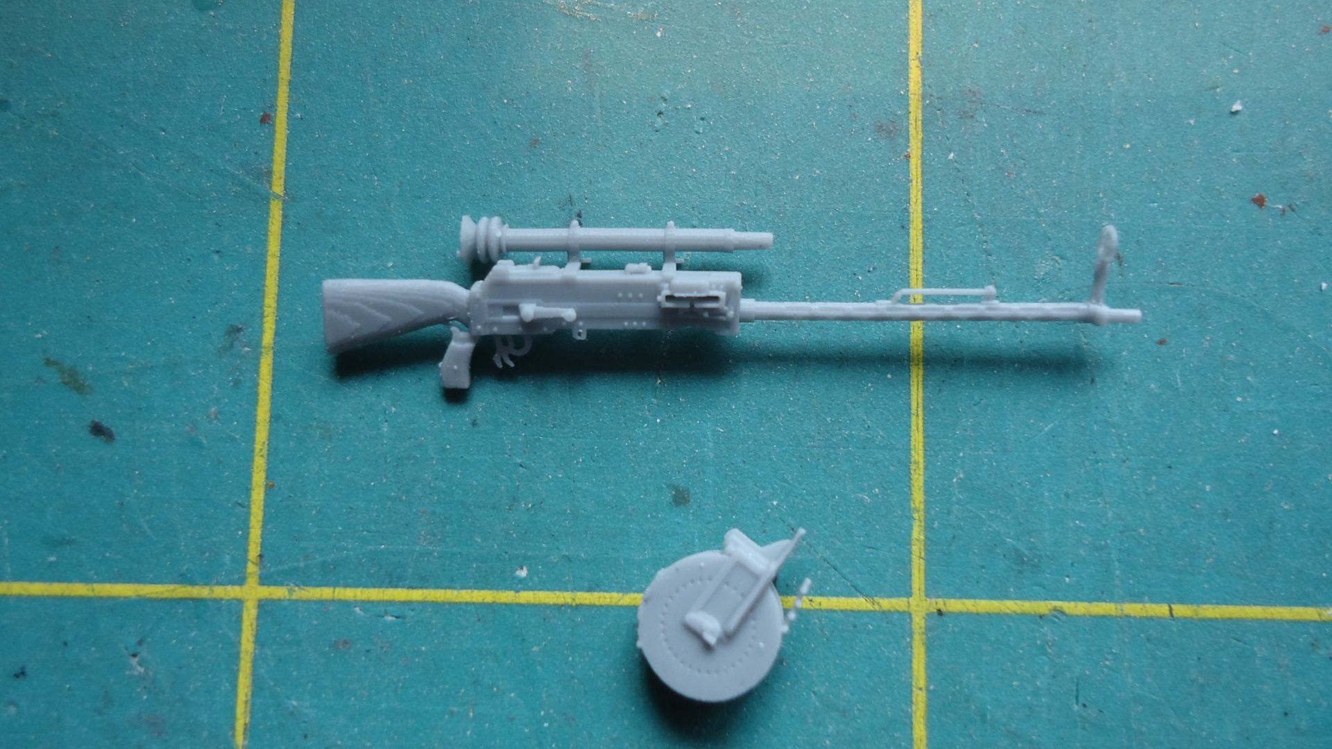

She's almost finished now.  All that remain are the exhaust and the Parabellum.  The exhaust will be a challenge since I have to build it from scratch.  The Parabellum will be a breeze since I'm using the new Gaspatch offering.

Awesome Bud! The Gaspatch MG looks great. I am sure you will nail the exhausts! I am looking forward to the completed Model Photos!
