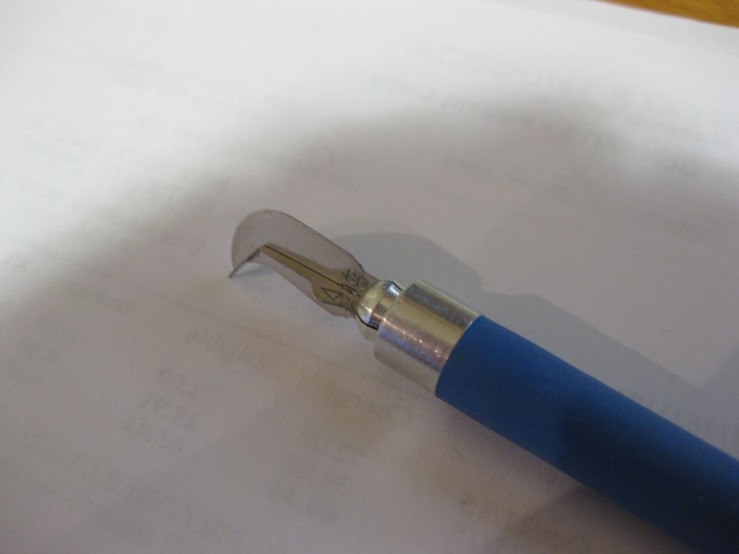

   -Chris, I'm using two coats of Tamiya Surface Primer; the real key is the scribing tool, RB Industries one shown below. It's a goofy looking little tool but I've never got the results that it provides, it's inexpensive, and as long as you take your time it does a really great job. It's Photo etch and just slips into a standard hobby knife as you see. Highly recommended!

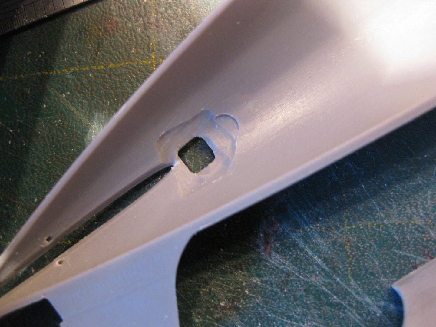

   A small update, I got back to the misaligned hand holds and they worked out just fine. The surrounding areas were ground out with the trusty Mototool and the outlines trimmed to match the panel lines. I don't use this tool often but when it's required it's a great little gadget.
   The fuselage stringers used as handles on the three openings (Evergreen Strips again) were then CA'ed into place the results look much better then the original kit examples.
