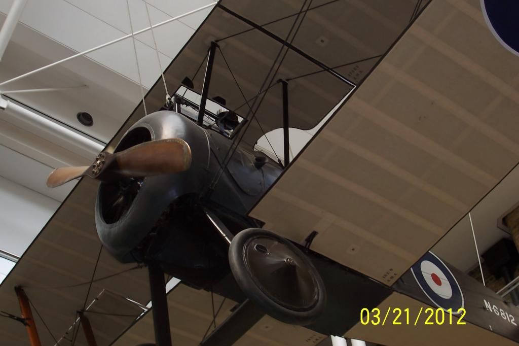

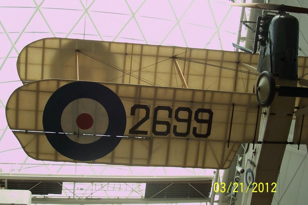

Roundels weren't visible through the PC10. Here are a couple of pics of a Camel and BE2 in the IWM, Lambeth. Both are in the same lighting conditions....
Notice that the under wing rib tapes appear lighter with no shadows, when the upper surface is doped PC10, and darker with shadows, with the natural linen finish.

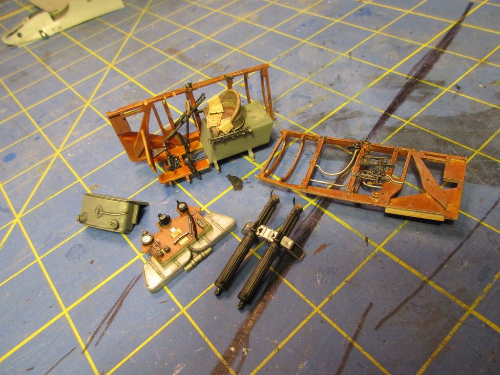

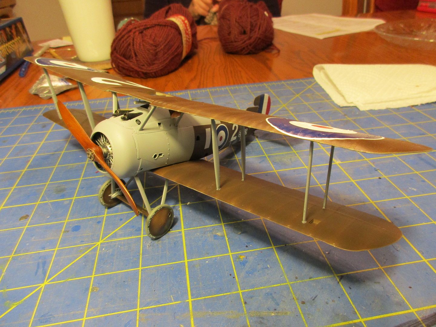

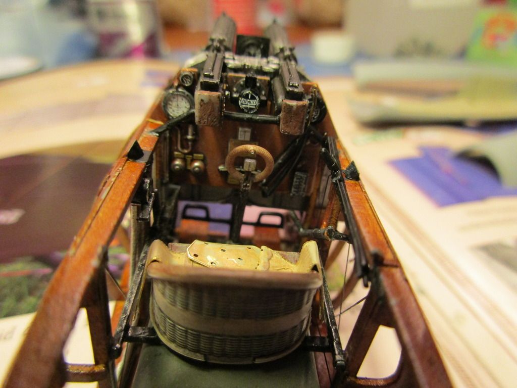

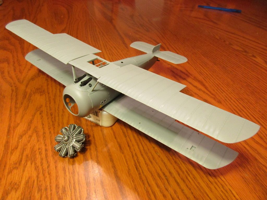

Excellent first progress my friend. I can truly appreciate the work you've done on her wings.I'm looking forward to following this outstanding thread. Since there aren't a lot of these wonderful kit being I'll take the liberty of sharing a link to my Camel from 5 years ago following first stroke.Mine's still not finish yet but hoping to some day.

Ian B - my thanks for these two pics which answers my question completely as well as providing good reference for the future.
