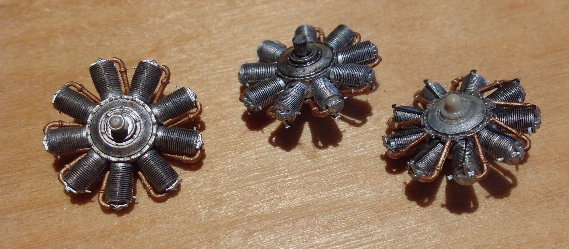

Thanks again, everyone.  Martin, I saw those decals after I had painted!  I lightened up the turquoise slightly with a very thin overcoat of white.
Progress has slowed, but I did get the motors finished.  Added a bit of extra detail.
Drew
« Reply #66 on: September 27, 2015, 04:57:43 AM »
Very beautiful engines, Drew.
« Reply #67 on: September 27, 2015, 06:07:09 AM »
Your engines look TERRIFIC!
« Reply #68 on: September 27, 2015, 08:04:17 AM »
You are moving along really well with this triple build, the engines turned out excellent.

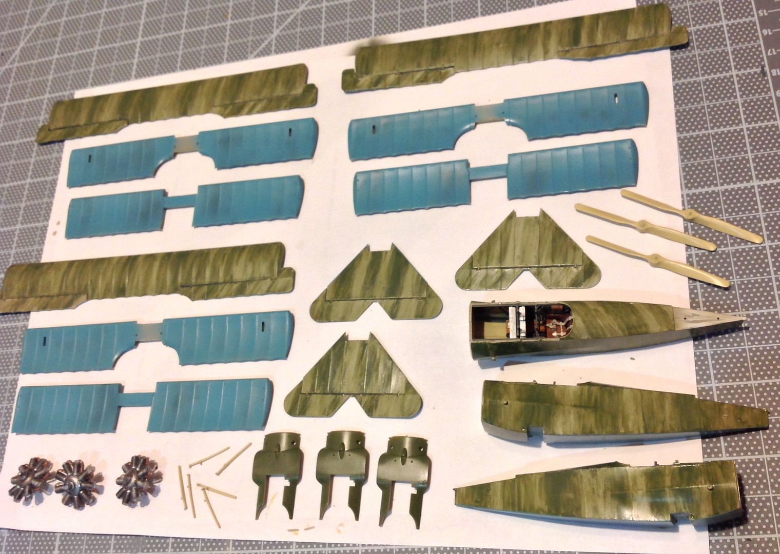

« Reply #73 on: October 05, 2015, 09:36:21 AM »
Small progress, but the streaking is now done on all surfaces. I also shaded the lower ribs; masking all those wings with .5 mm tape was not fun!  The upper wing, left middle, and tailplane, rightmost will get the black and white stripes, so I wasn't too careful with them.  The props and wing skids also have the buff base in preparation for woodgraining.  Next step is to block out the cross positions. I'm going to use slightly different shades of olive and turquoise, figuring field colors would not match factory painting too closely.  I decided to use one set of asymmetrical ailerons for 149/17, since it seems to have been in the batch that had them fitted.
Drew
« Reply #74 on: October 05, 2015, 10:24:50 AM »
Everything is looking fantastic Drew, all your colour choices are excellent, looking forward to seeing these three beauties assembled.
