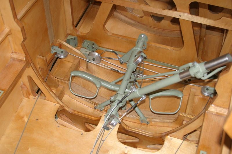

P.S. A little call for help: can anyone provide a description or drawing of how the rudder cabling was attached to the rudder-bar assembly, please? The two figures in the Albatros Special for the D.1/D.II (and presumably D.III as well) - a reproduction from a spares manual and a sketch- conflict with regard to the transverse cabling to the two pulleys - how did the cables run back to the tail area? The WNW instructions are not much more help as they conflict with the Special figures - showing two transverse levers rather than a single forward-directed lever.

« Reply #3 on: May 07, 2015, 03:12:12 PM »
Graham.
This is a repro DIII by th incedibly skillful Koloman Meyrhofer (apologies to Koloman if I spelt that wrong.)
He works fastidiously to get his aircraft correct so I see no reason to doubt this is accurately done.
As you see there is considerable difference between DII & DIII control layouts. (He did DII's too.)
Hope this helps you.
Keith

« Reply #4 on: May 07, 2015, 03:42:48 PM »
Thanks Keith - this is extremely useful. Quite different for the Alb D.I/II drawings. I'll have a good look and work out what is happening - hoping it's not too late for what I've put together so far.

keith that looks like an oeffag d.iii interior, the floor notches show this. is all that hardware identical in the albatros built d.iii?

I have not sacrificed a whole WNW Albatros for this project - just obtained individual DVa sprues A, B and D from WNW. Quite a  lot of this apart from the better quality WNW wings and tail-plane can be used to replace inferior Roden parts and to allow the DIII to be built (DVa-like rather than DV because of the aileron-control set-up). The only thing that I was unsure of - and I've already built the 'wrong' control column outfit (DI/II style)- was the rudder operation. It seems, if this III OEF interior was really similar to that of German airframes, that the DIII was DVa-like rather than DI/II because of the narrower lower wing.

Yeah I was going to suggest the same thing as Keith -- pore over KMs build log on the aerodrome, I think you will find nearly all questions are answered in pictures there.

Its not OEF, I know Kolomar specialises in OEF but this was a set of 2 Albatros DII &  1 DIII's he was building a while back.

Though period photo's of either DII or DIII interiors are rarer than hens teeth there appears in the Windosck DIII special two images of DIII(OAW) 2479/17 that has broke its back on impact with the ground. If you look closely at the top image taken from the left you will see a panel on the floor beneath that has the same unmistakable cut outs as in the image above.
Doug Bauman first alerted me to the fact that Roden, Eduard and Windsock have failed to pick the fact up with a comment on my then Roden DIII(OAW) build. Some heated debates persued on Aeroscale when I first put forward the suggestion.  ;)

i was looking at the floor, not really speculating on what koloman builds(yes usually oef) .i could be wrong but i thought that the german d.iii had the bottom deck as solid and the oef had the 2 "D" shaped notches in the front of the floor where it attaches to the former. i assume these notches are so the rudder bar wont hit when it swings o the extreme left or right. i may be wrong but thats what i understood.
