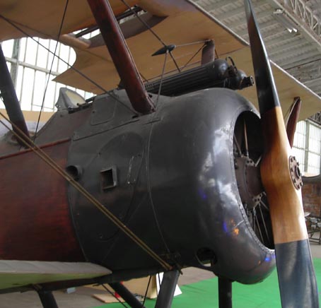

I'm sure it came off all the way. I think the fastening method was two short metal straps on each side, top and bottom...
Not the greatest picture but you can make them out here:
