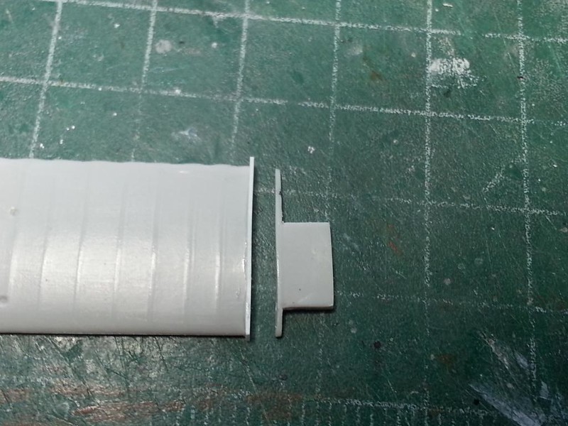

I got a bit more done today, mainly starting on the lower wing mountings.
 I started by cutting off a little under 1mm from the inboard end of each wing, along with the mounts, and replaced the lost width with a piece of plastic strip.
The fuselage was modified by adding strips of .010" card to lower the wing, and making a small cutout at the front to enable the parts removed from the wing to be fitted flush to the sides.
The pieces that had been removed were then modified by drilling a hole on the front spar for the locking pin and reshaping the front and rear ends.
 The modified parts were then fitted to the fuselage and the gaps filled.
 Tomorrow I'll tidy it up and maybe make a start on painting and preshading.
