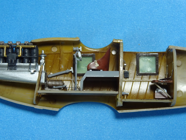

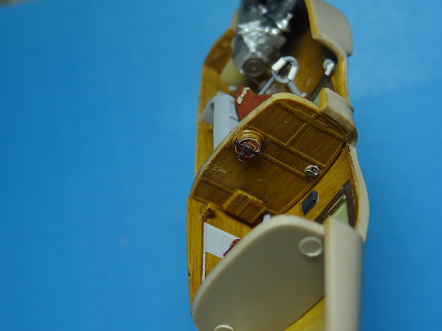

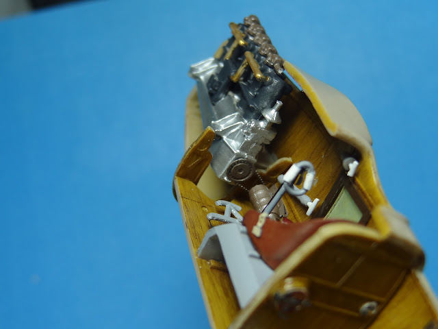

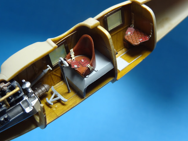

Interior photos.
http://4.bp.blogspot.com/-QCPvT0moKmQ/T9XOuPxYlyI/AAAAAAAABAc/ScQGtfAWwxk/s640/DSC03244.JPG[/img]
Everything is painted with Vallejo. Wood effects done with oil paint.
All PE come from the box (it´s a Profipack version).
« Last Edit: June 11, 2012, 09:25:56 PM by Marco »

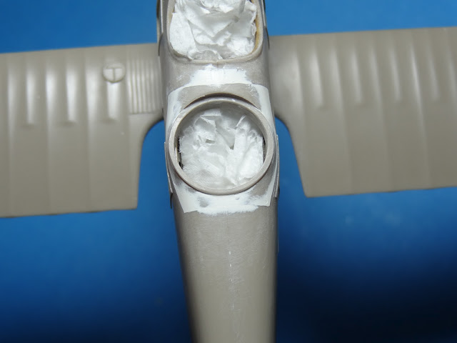

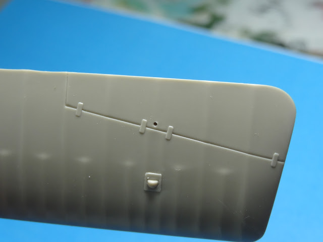

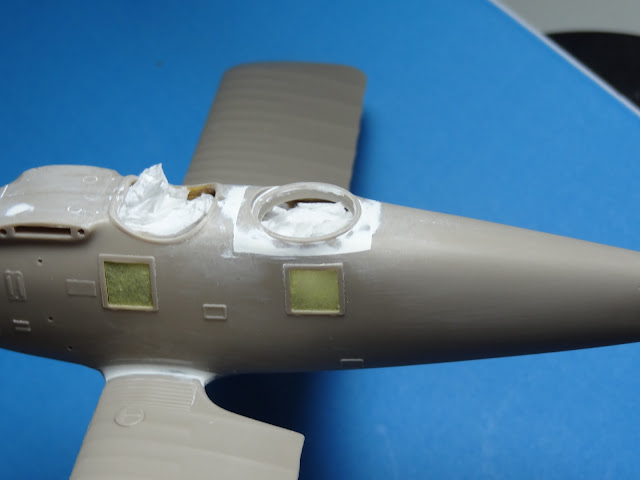

More stuff:

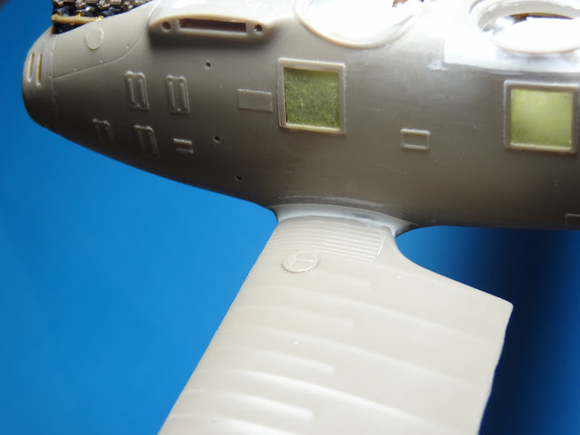

The halves were joined. The fit isn´t perfect but quite easy to do once you get the instrument panel to the right size (it gets in the way). The cover over the gunner´s cabin required adjustment with putty.
The under wing fit had to be worked on. Lots of sanding and putty. The phot shows what looks like a gap in the fit but actually its just a dark line where I covered the gap with CA glue.
There was an ugly sink mark just ahead of the pilot cabin.
This is how it looks at the moment.

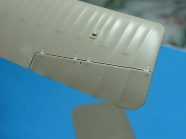

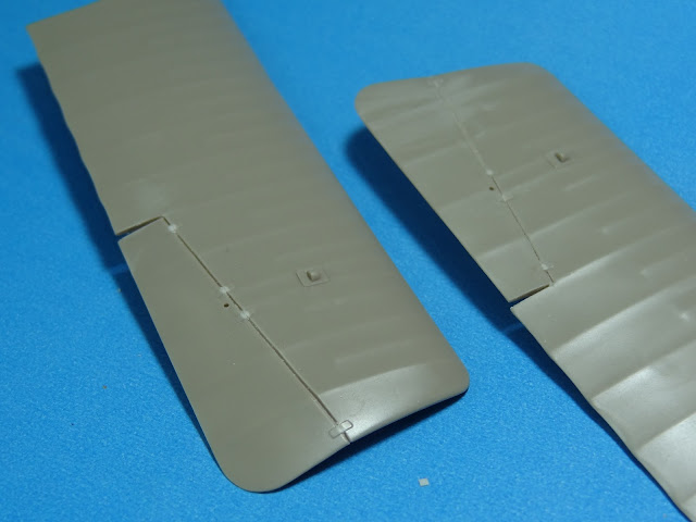

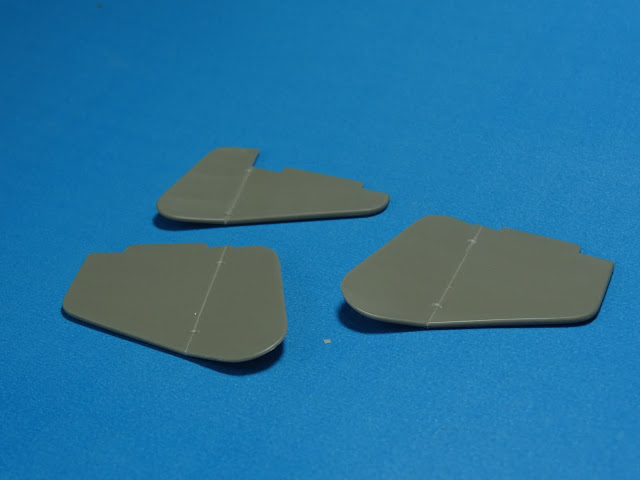

Didn´t do much yesterday. Only worked on flaps, aleirons and rudder.
The flaps and wings com in one piece:
Using a small saw and a scriber I managed to move the flaps without taking them off:
One goes up; the other goes down:
Tail pieces were repositioned too:
