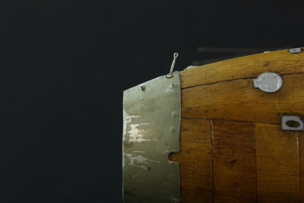

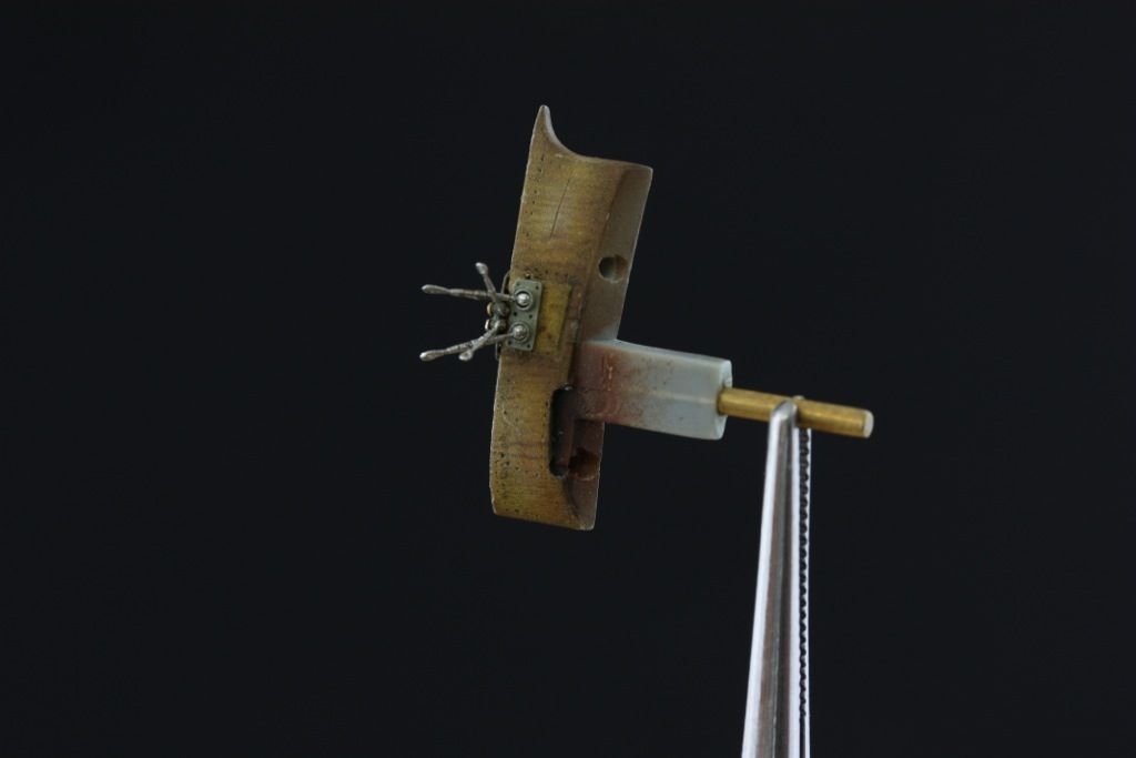

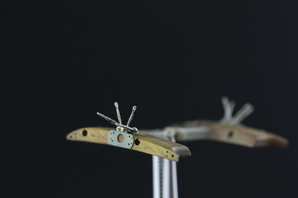

Keep in mind aircraft typically had many different sized turnbuckles; they were sized for cable size and load. I have only closely studied Albatros and Fokker applications; in these instances the 1/32 turnbuckles are appropriate only for the largest load wires and still maybe a bit oversize.
To solve the orientation issue and to try and mimic the gimbel action of the Albatros turnbuckles, I made functioning ball and socket joints. Time will tell if it works out ;)
