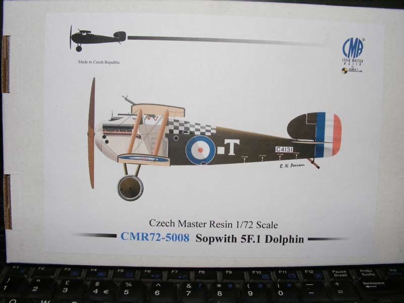

Evening chaps.
I've only recently bought this one but it's jumped the queue in the pile because I think I'm ready to have a go at my first resin kit.
I've had a look inside the box and it's all rather different to the usual injection-moulded plastic kits - no sprues, just parts on blocks of resin, some of which look rather fragile.  ???
Any advice before I dive in?
