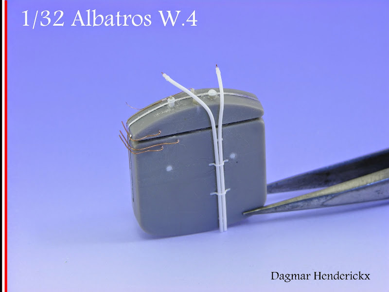

« Reply #14 on: July 12, 2014, 09:34:53 PM »
Hello dear colleagues,
Fiddled along a bit this week and continued with the interior.
Trying to upgrade the control column with Evergreen rod and little bits from the PART Albatros D.I photo etch set...
Accentuating the borders of the ammunition boxes with stretched sprue and adding a bit more detail with Evergreen and copper wire...
Same thing with the fuel and oil tank...
Till next time,
Dagmar
