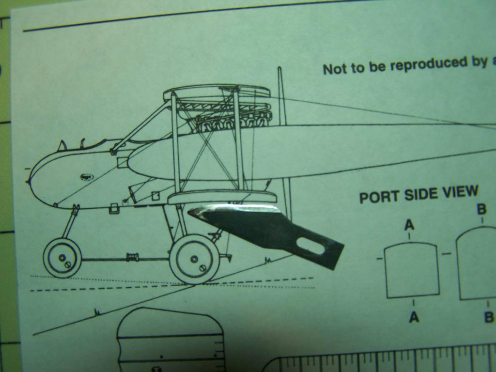

With the aide of a Windsock Datafile, I have pretty much decided I have what I need to get started. After printing the drawing from my scanner and checking it for scale, the fun was about to begin.

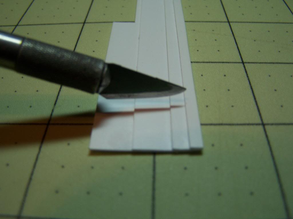

Using the laminating method I've used before in making wings, I started by layering various widths of 0.020" sheet styrene to create the rough shape of the wing in profile.
Once assembled, I then began the shaping of the wing. Here I've already started rounding over the leading edge:

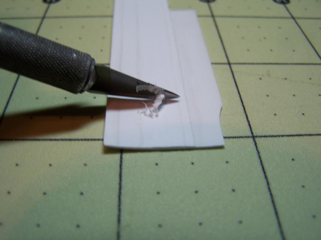

In order to shape the wing, I will need to remove those edges from the layered strips on the underside. To do this, I used an old exacto blade that I reshaped and sharpened.
With the point of the #11 blade ground away, I can now safely scrape the unwanted styrene away from the underside of the wing.
With the majority of the removal done, we have this:
