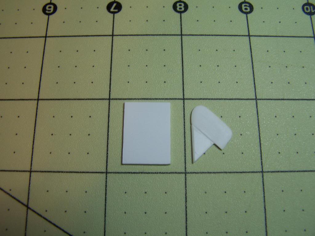

So, to continue, the making of the tail parts.
  I actually started with the rudders since they're small and are a good way to jump into the project giving a quick result for the effort.

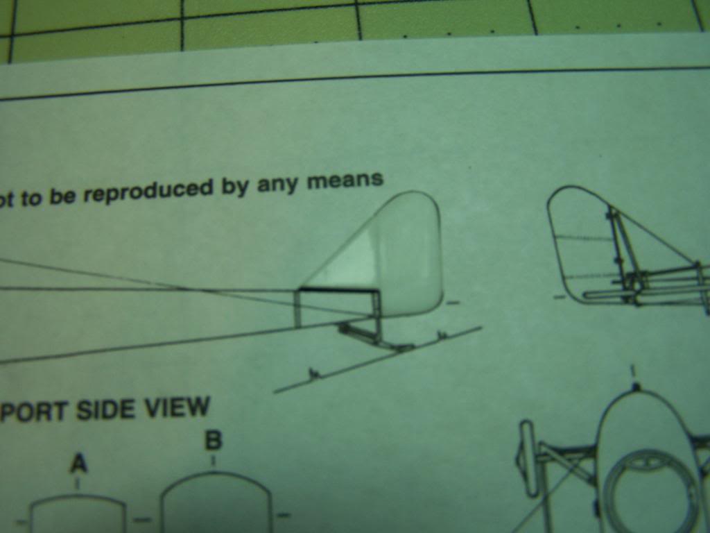

Cutting blanks from sheet stock, I shaped one of the rudders to the outside profile using the drawing as a guide.
Then a second one was needed to complete the pair.
Posted prematurely, I will continue...

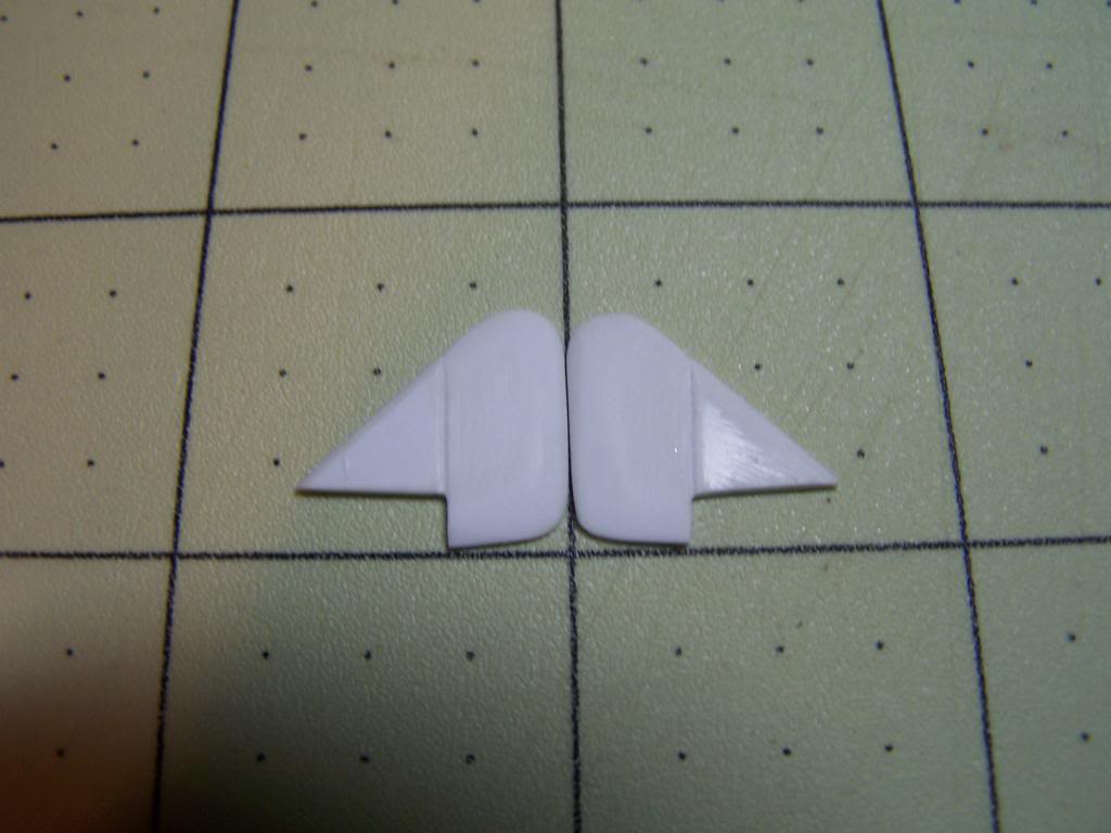

After both rudders were shaped to my liking, the ribs were added.
