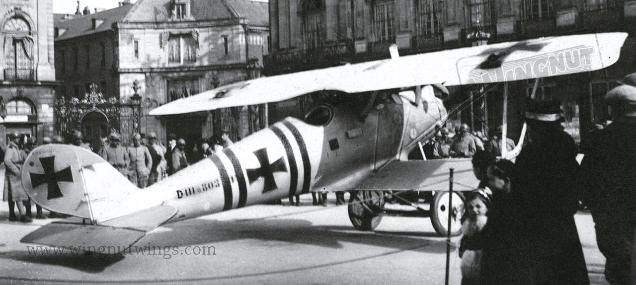

Re: WNW Pfalz DIII
« Reply #12 on: June 02, 2014, 03:14:22 AM »
Hi Al,
A picture paints a thousand words - do you have any photos or drawings to illustrate your points?
this is what he's talking about... even more obvious from a straight rear aspect, WNW doesn't have such a photo on their site, but look in the Herris book for several examples:
compare to this lovely build (hope vB doesn't mind):
