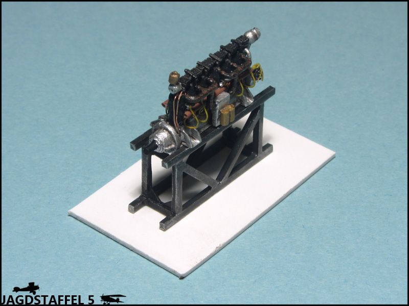

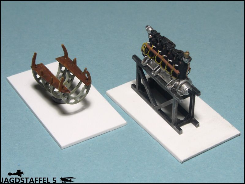

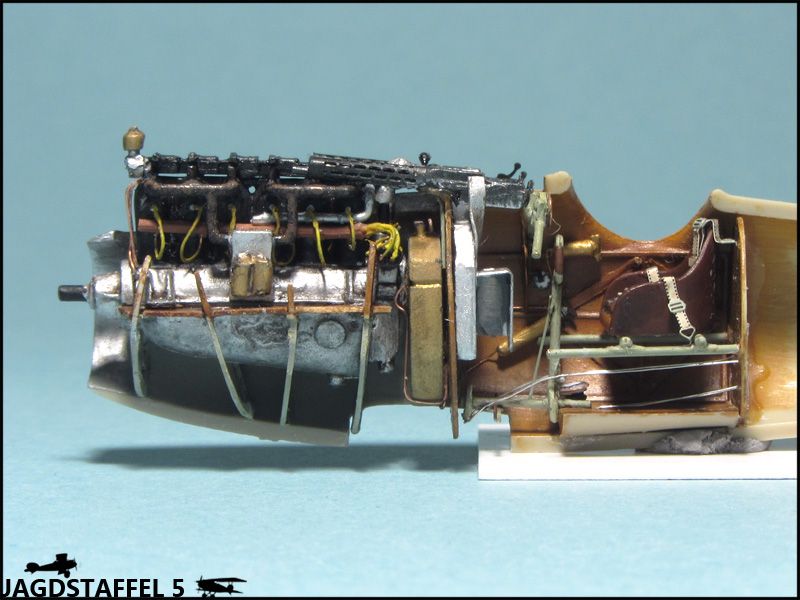

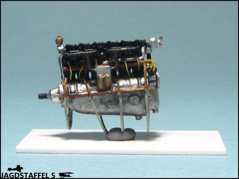

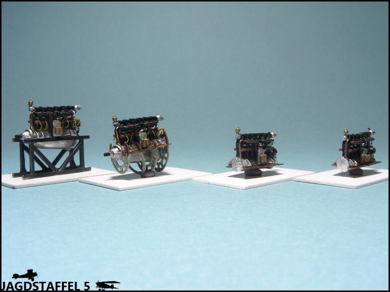

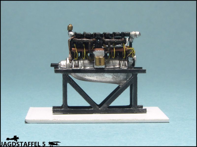

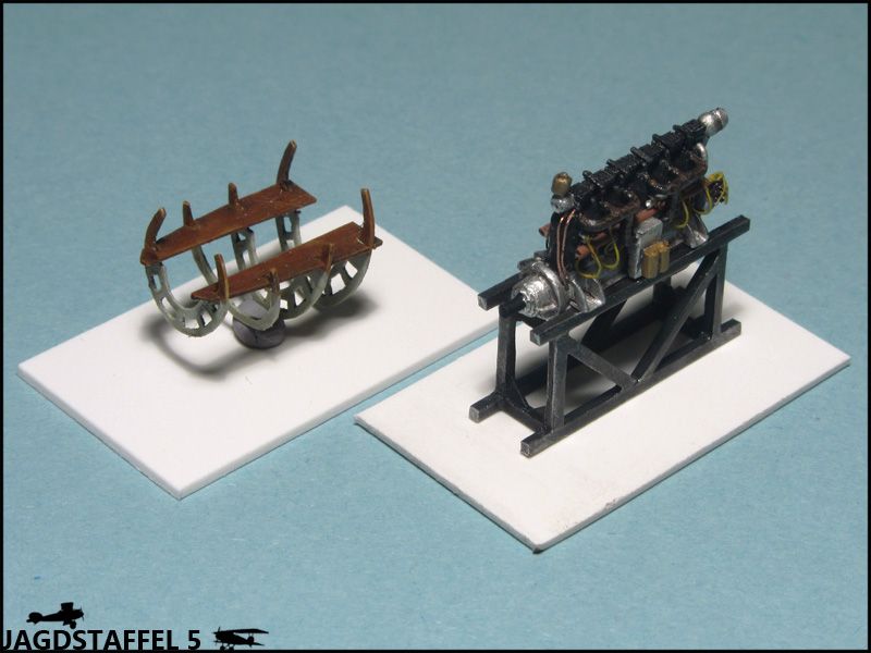

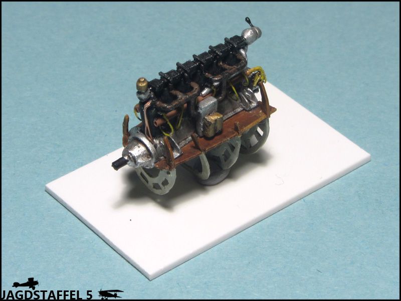

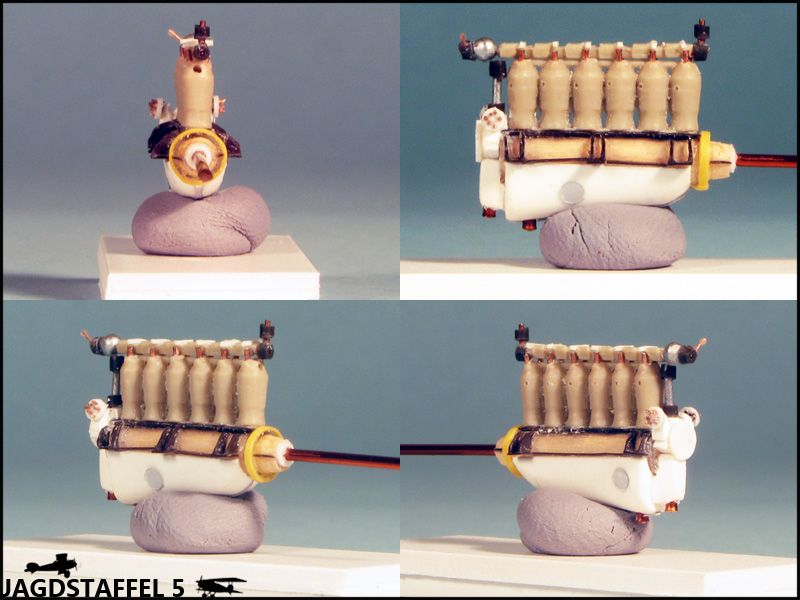

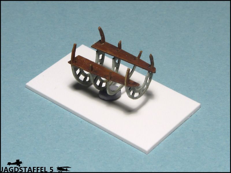

Hello everyone,

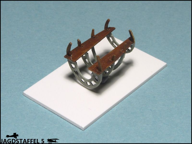

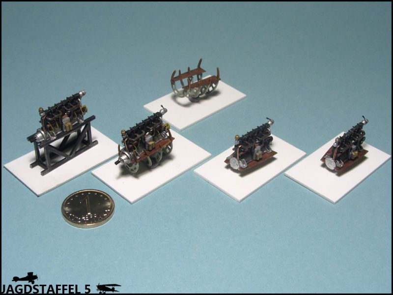

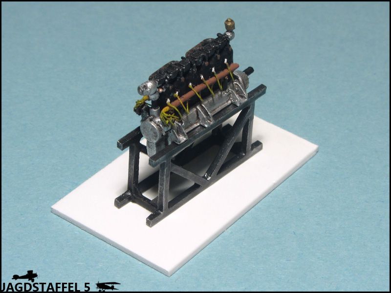

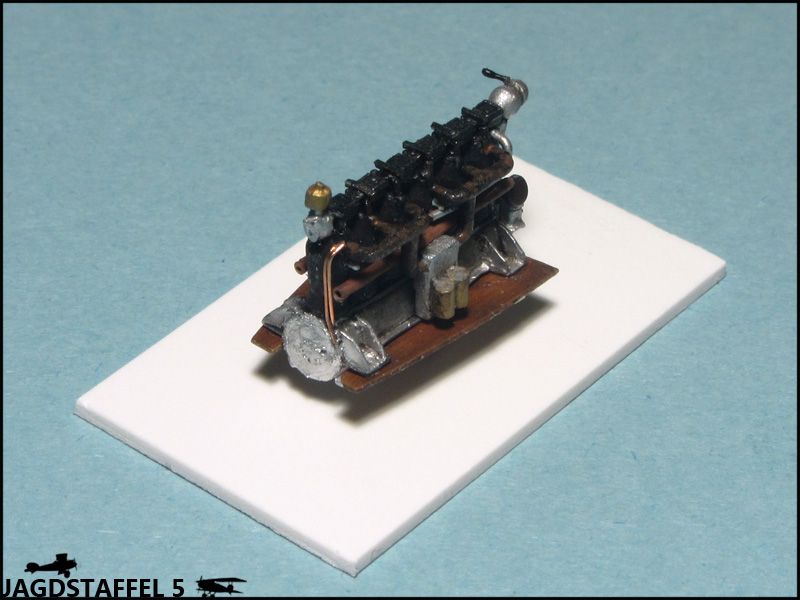

I finished work on the engines. By EDUARD have included only a few details for this part, which is quite a bit less, so I decided to deepen and produce miss you. I used to manufacture improvised: plastic sheets, wires and hoses. Used for painting paints Gunze Mr. Metal Color and Aquoreos Hobby Color.
So:

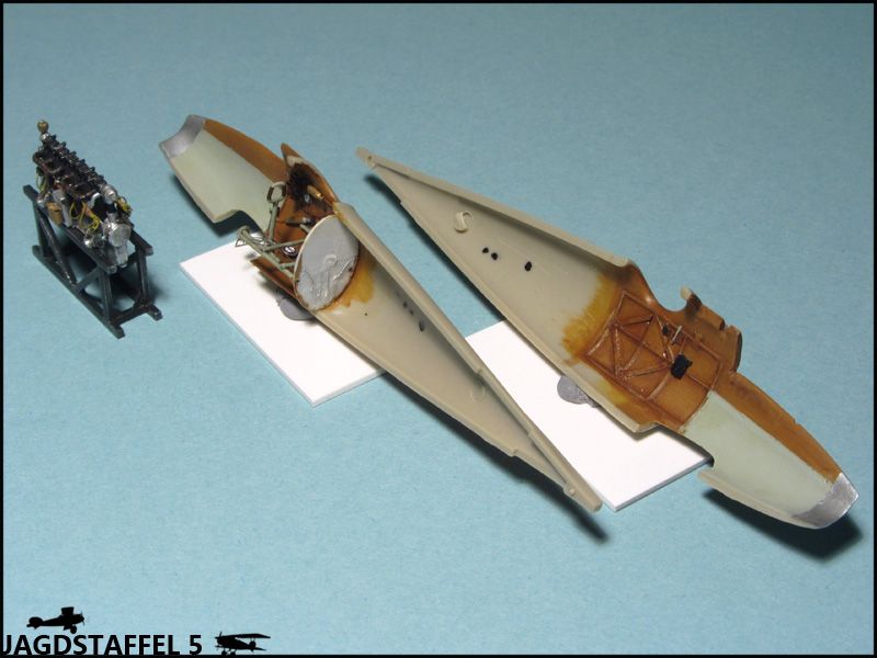

First plane: This plane I thought to participate in the diorama as disassembled and prepared for repair. For this purpose, the engine will be removed and placed on a stand. I worked for him and wooden frame inside the fuselage. In the production of wires to the spark plugs were a little long and may be a problem with the starting the engine  :P

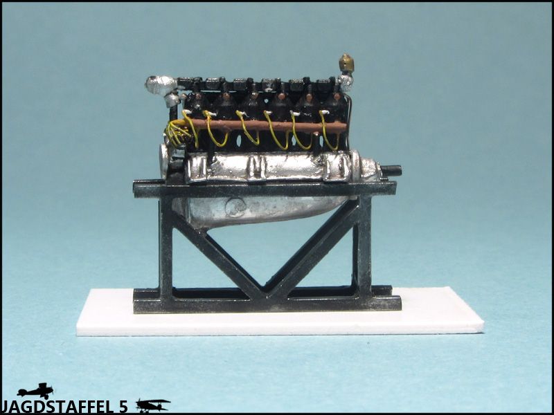

Scratch build details:
Finished engine:

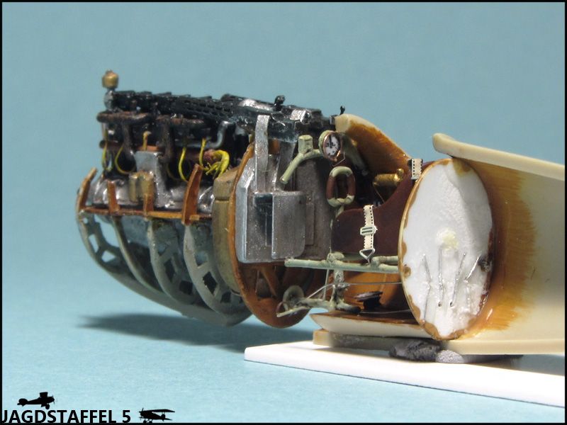

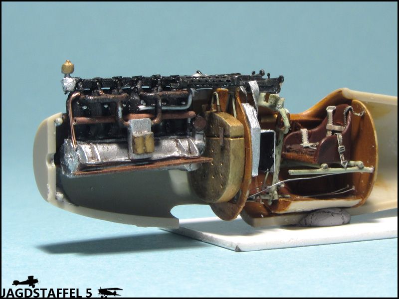

Second Plane: This I think is shucked fin and lid open:

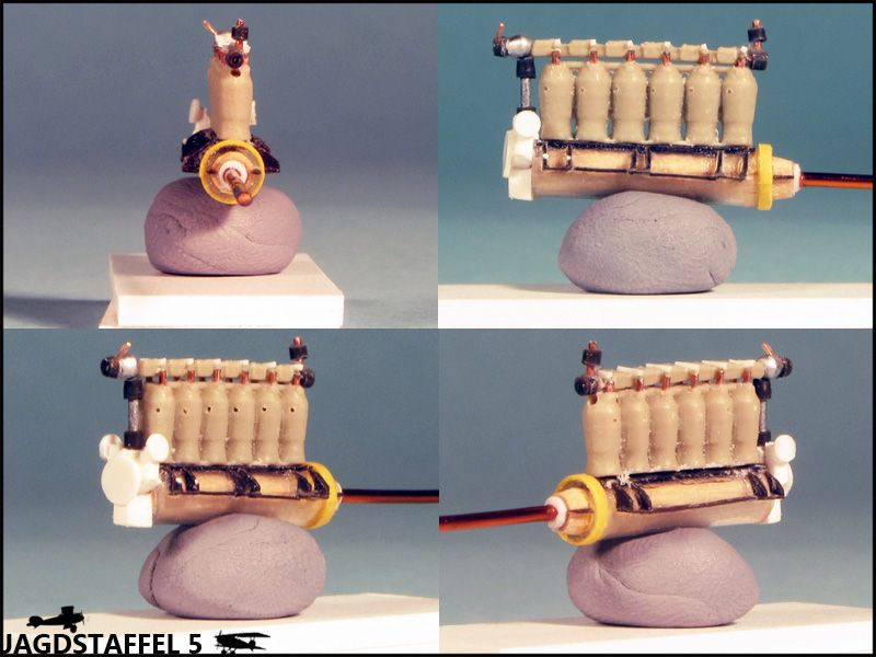

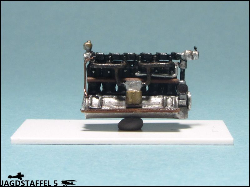

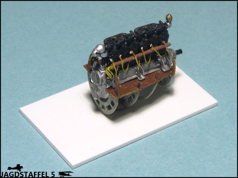

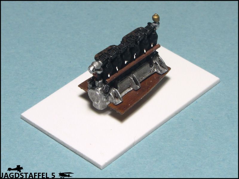

Third and fourth aircrafts: These shuttered and May have seen nothing of them, but anyway ;):
Finished engines:
And all together:
That's it for now. It should collect everything in the fuselages.
Best Regards
Hristo

The engines definitely don't have enough details in 1/72 Eduard kits, and it's even worse in MAC Distribution ones. I have made a silicon print of both sides of a Roden Mercedes D-III in order to cast copies for further kits.
You have added everything that is possible to add on those engines, congratulations. I just love the scratchbuilt wooden frames and the perfect fit with the engine!

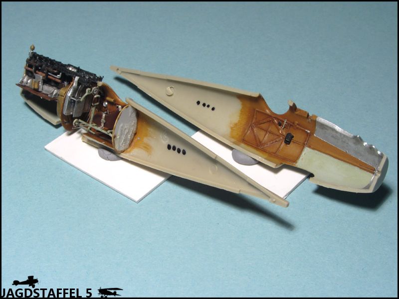

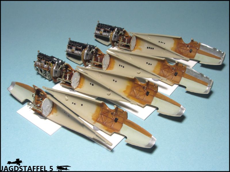

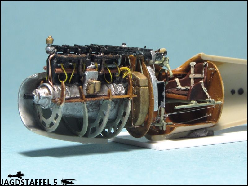

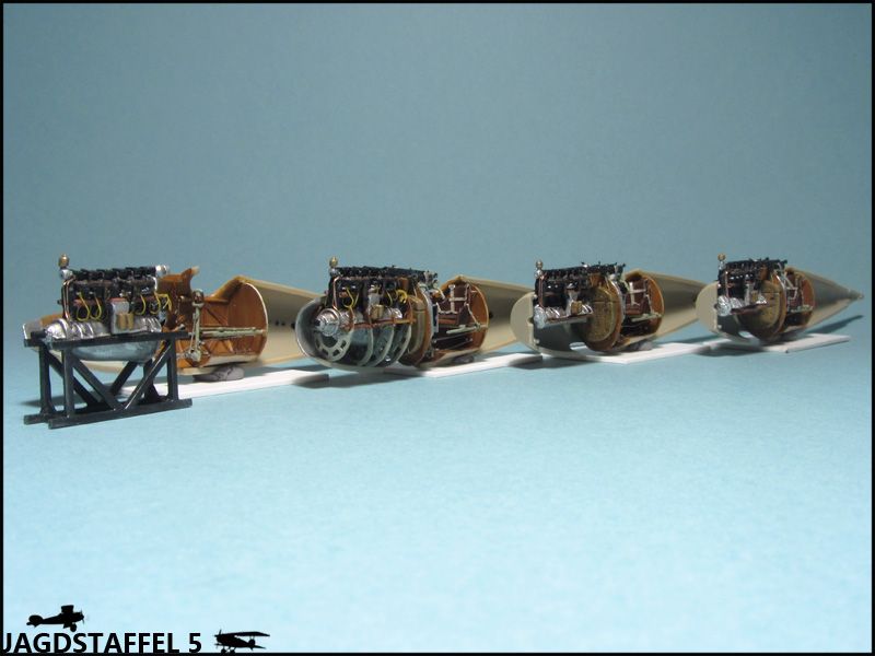

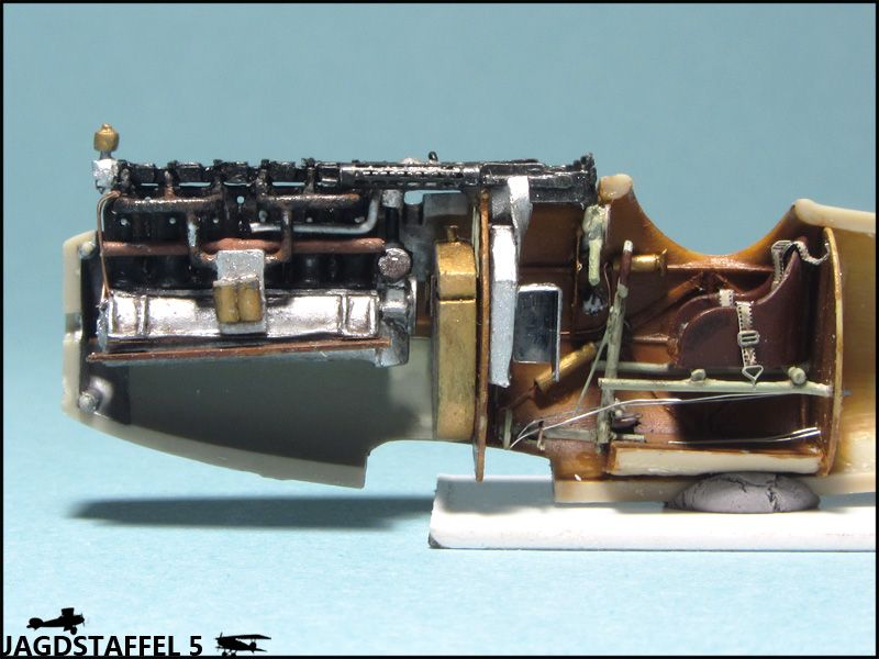

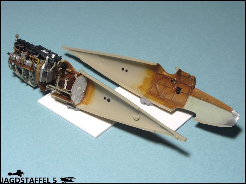

Hello everyone,

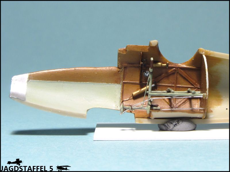

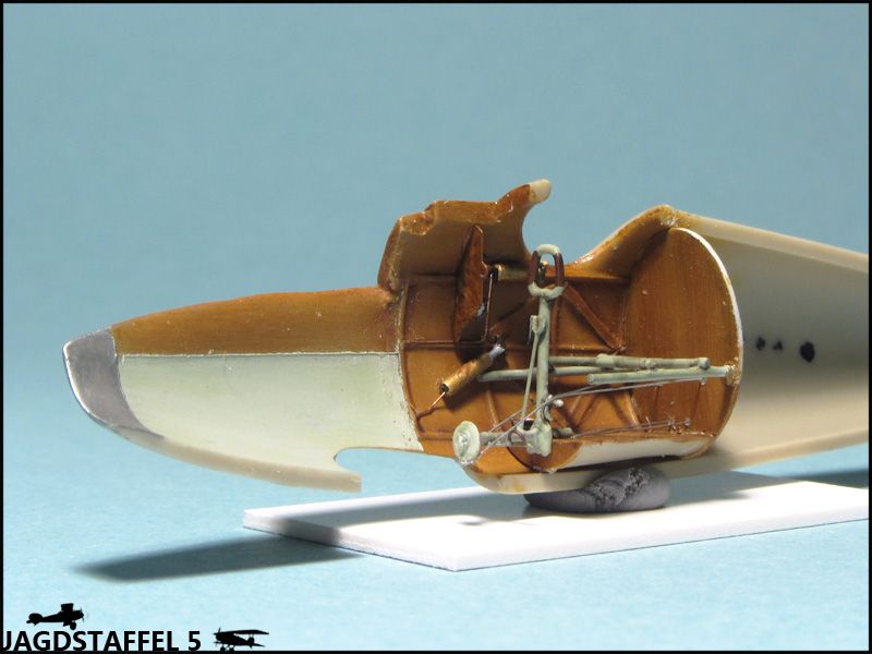

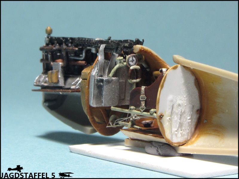

I gathered all the parts in the fuselages.
In airplanes one, three and four not met many problems, but in the second, it appeared that the frame of the engine is higher and the axis of the propeller is not in the axis of the opening.
So, I'm lost in Scratch :P.
Anyway I will try to take it off and adjust the gap.
In the installation of other details no special problems.
First airplane:
Second airplane:
Third and fourth airplanes:
And all together:
Next step is closing fuselages, assembling bottom wings, stabilizers and cuting the elevators.
Best Regards
Hristo
