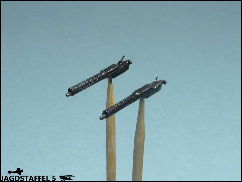

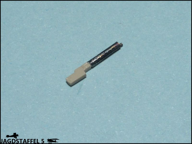

Hello everyone,
I finished work on machine guns. I removed the plastic part of the cooling rack and then swapped to PE from kit.
For the preparation of the tubes used medical needles.
Base color painting with 36M of Agama, then with a dry brush moved MC 218 Gunze Mr.Metal Color.
Finished and the controls, levers and pumps in the cabin.
Continue to struggle with the engines ...
Best Regards
Hristo

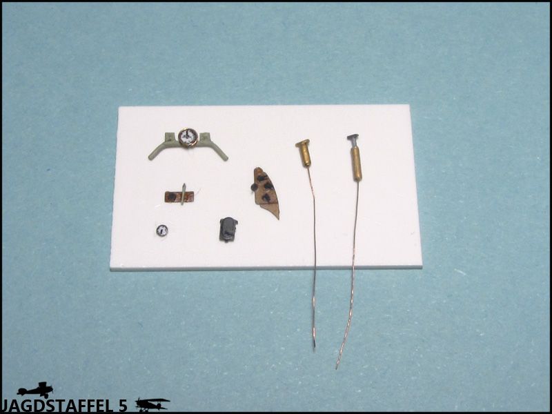

« Reply #20 on: May 16, 2014, 03:24:19 AM »
Outstanding modelling especially the parts for the cockpit. Are they PE and transfers? Whatever they are they are really very good indeed. (x4)
Offline frame
  • Posts: 60
Re: Jagdstaffel 5 - july 1917 - Albatros D.V - 1:72
« Reply #21 on: May 16, 2014, 04:33:26 AM »
Hi lone modeler
Pumps and control equipment with holder are scratch builds, the rest is PE.
They are made ​​from materials at hand - needles, copper wires and appliances are printed.
The water pump greaser is slightly larger than it actually is, but at this scale it's kind of hard to work out the actual size
Best Regards
Hristo

« Reply #23 on: May 16, 2014, 08:42:30 PM »
Very nice detailing. I had to do the same on the weapons of my own 1/72 D-V. I only kept the original breeches and rebuilt the rest from PE and scratch.
Quote
Glad to see I'm not the only one to have this problem with 1/72 kits...Eventually, I consider this is part of their "charm": the fact that some of the smallest details have to be slightly oversized so they can be handled and remain visible.
« Last Edit: May 17, 2014, 07:46:34 AM by vincentm »

Yes, WWI birds in 1/72 scale are even more difficult than I had thought. I'm impressed with the amount of details you made on your kits. What kind of paint do you use to get so realistic effects on metal parts?
Offline frame
  • Posts: 60
« Reply #28 on: May 17, 2014, 09:44:16 PM »
Hi vincentm,
For the metal parts I used Gunze MR. Metal Color paints.
Before laying them painted with black paint, preferably glossy, but and Matt is good for small details.
I work with a brush and work with these paints requires little training.
Otherwise work with airbrush far as I know are perfect.
When dry, I make oil wash.
Well it is, I hope I've been helpful.
Best Regards
Hristo
