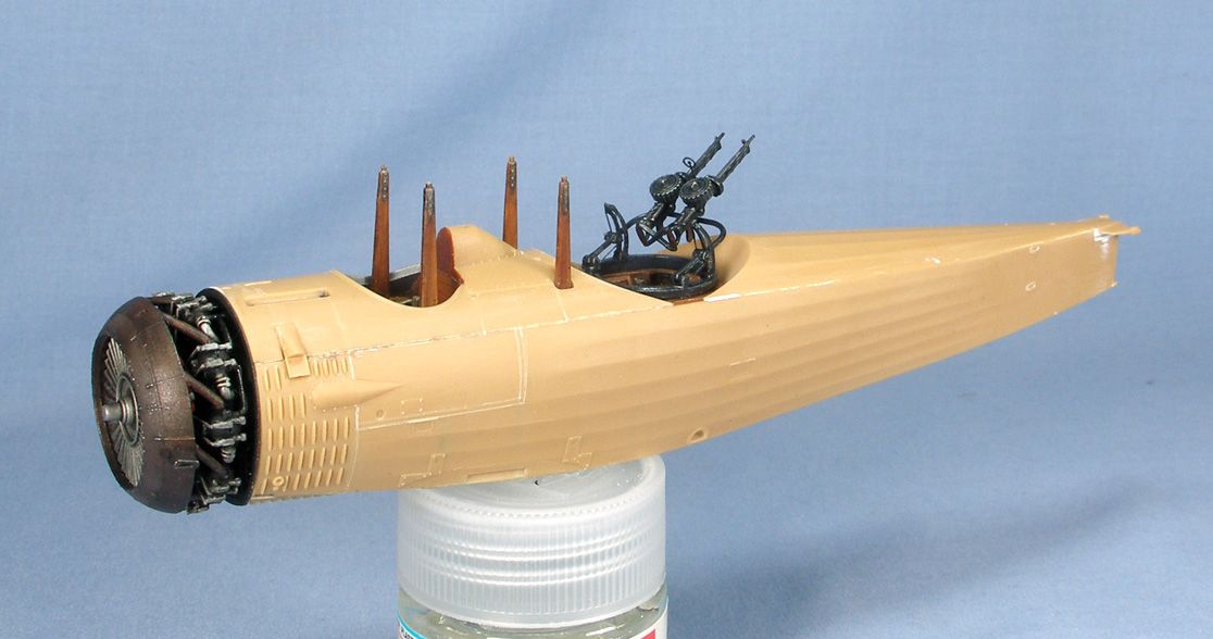

I now have the fuselage closed up.
The interior is a tight squeeze - the easiest way I found in the end was to glue the two fuselage halves together first to minimise the gaps for clean up, then slot the centre part in afterwards.  This was also tricky as the struts need to slot into the correct position without snagging on any of the wires or other interior components. The camera extends past the back end of the floor piece, and the whole lot needs to slide backwards once it's roughly in place (if I build this model again I will add the camera in after the fuselage sides and floor is in).  It took me a few goes and a few broken bits of rigging later to get it into the correct place.  The mating edges of the centre floor piece to the fuselage sides is angled to a knife edge right at the bottom edge of the fuselage, which means you need to use glue sparingly. It's also tricky to get the floor flush with the fuselage sides and underside, so I found a little filler was needed here (though not too much).  The upper decking "shelf" in the cockpit also needs to slide around the struts and the forward cockpit components. It was also a tight squeeze so I needed to do some trimming here and there to get the shelf to sit flush.  Likewise the upper fuselage parts needed to slide around the struts, and took some persuasion to get in the right spot and a little filler here and there, but again nothing too dramatic.

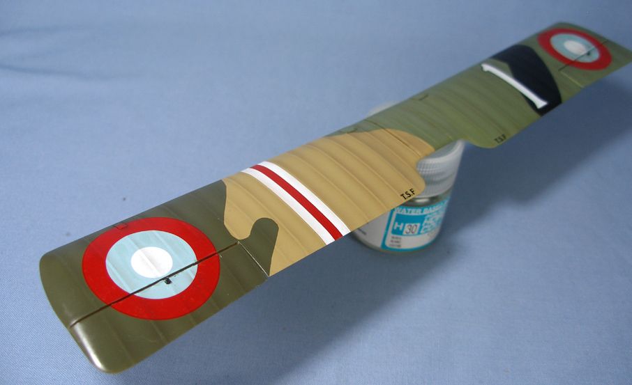

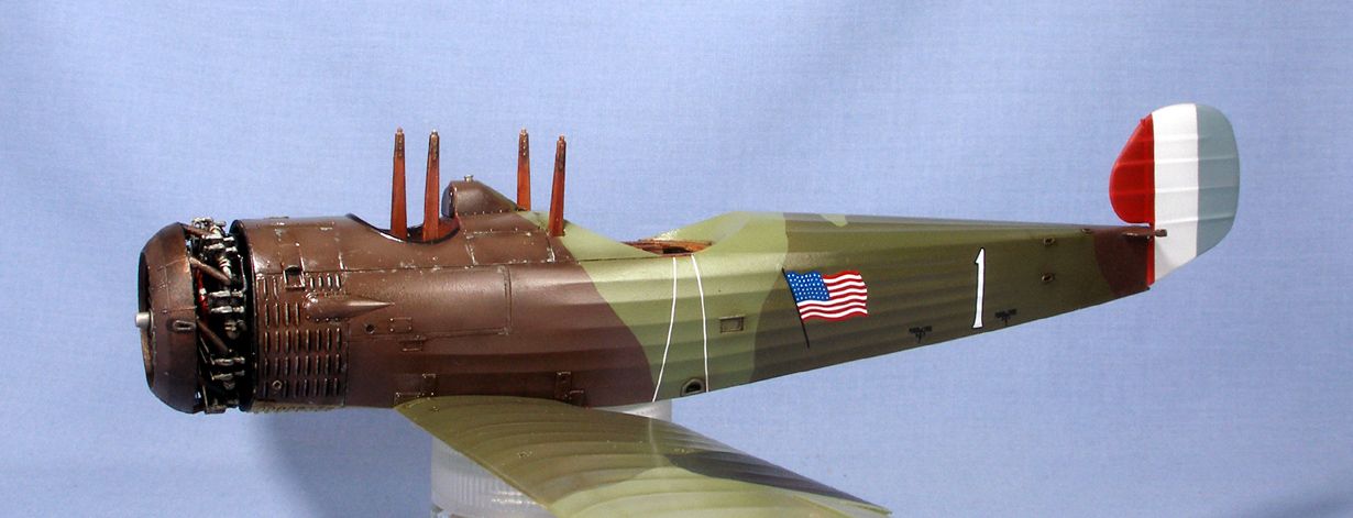

« Reply #36 on: June 01, 2014, 06:37:17 PM »

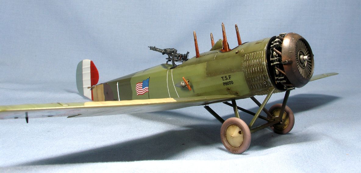

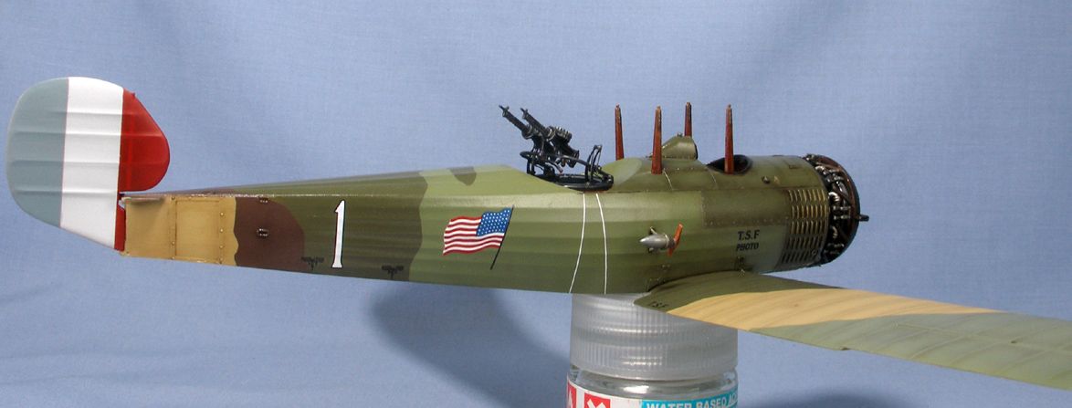

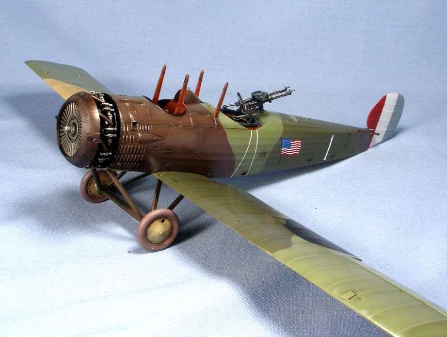

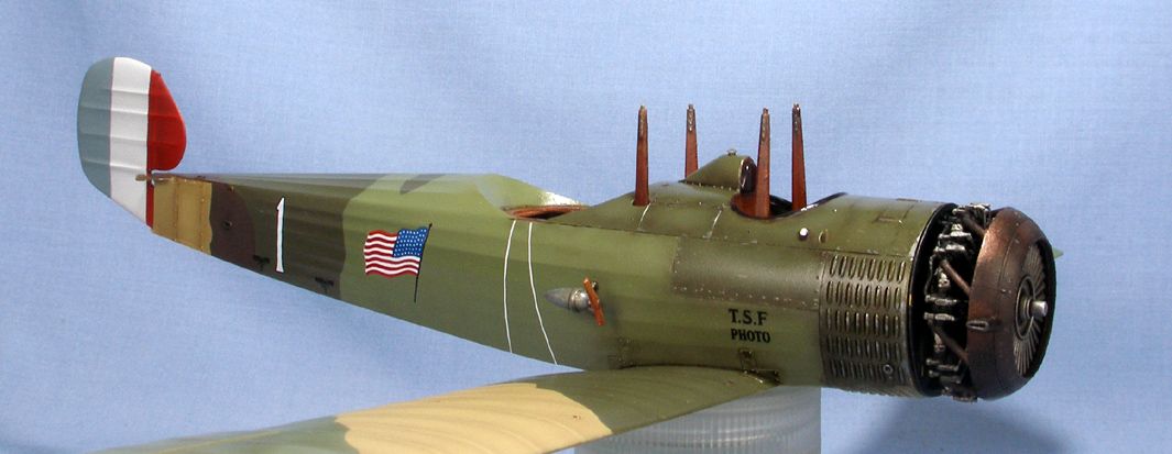

Very, very, very slow going.... have some paint on her now.  I went with the OOB markings for the USAS 1st Aero Squadron.  Kit decals were very nice, but were difficult to move when I tried to position them.  If you're going to use the kit decals, float them onto the model with plenty of water.

« Reply #37 on: June 01, 2014, 07:24:51 PM »
Looking absolutely superb Brad and your painting is faultless, this is shaping up to be a real stunner.
