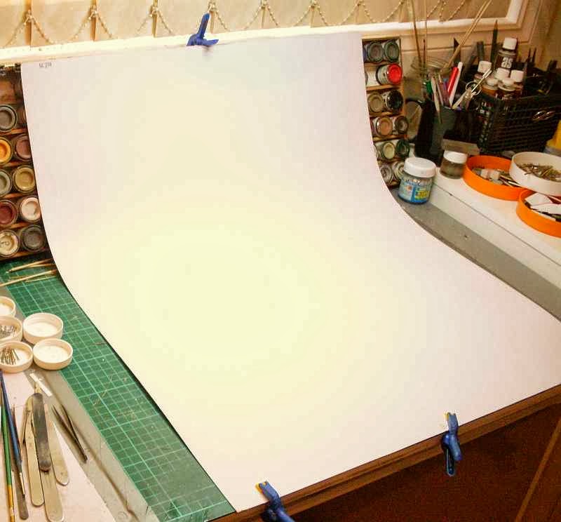

I don't have any fancy or expensive photographic equipment just a very basic Samsung digital camera, a sheet of white card and a light. I place the 500mm x 730mm white card on my bench and allow it to run up the back creating a smooth curved surface. I use plastic clamps to hold the card to my bench. The photos show how simple and very inexpensive it is to make a photo backdrop for taking photos of my models and the photo results are usually pretty good.
The resulting photos show nothing more than the image I am wanting to portray, there is no seam in the backdrop and no clutter in the photo, the person viewing the photo can concentrate solely on the model.

« Reply #1 on: October 09, 2013, 08:25:46 AM »
I use a roll of lining paper as mine  then the kids use it for drawing.
Re: Seamless backdrop.
« Reply #2 on: October 09, 2013, 09:55:15 AM »
Same great results Dave, no seams, it makes for a very attractive photo  :)

« Reply #5 on: October 09, 2013, 04:20:39 PM »
Guy, the only lighting I use is a bench mounted fully adjustable arm circular fluorescent light. The circular fluorescent tube is Tri-Phospher, 215mm, 22w, 1350lm, colour temperature 8000K Day Light, it is rated as long life 10,000hrs.
Being on a fully adjustable arm means I can position the light in any position, the head also swivels so I can angle the light so it shines under the model if need be. When taking the photos above I had the light approx 12 inches above the model and slightly forward, this seems to work well for me.

Using the white card has the added effect of reflecting the light back up to the undersurfaces of the model. If you have a look at my Snipe photos you will see that even though the light was directly above the model the underside of the wings are quite clear and detail can be seen.
