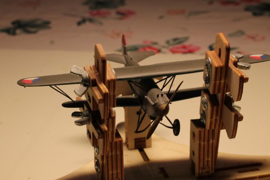

Just to show my ideas about using this jig. I dated my purchase back to 2008, but as said before I didn't really use it yet (I haven't been building much biplanes).
Here you see a Fokker C.V sitting on the jig showing how it can be used:

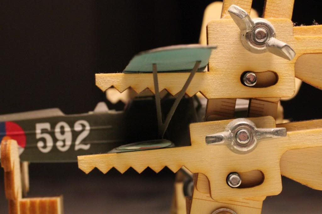

The idea behind this jig is that you can position the wings correctly above each other and then glue the wing struts and cabane struts in between. The support behind helps in positioning the fuselage at the correct angle to the bottom wing. All supports can be adjusted and there are scales on the parts to put them at the correct angles:

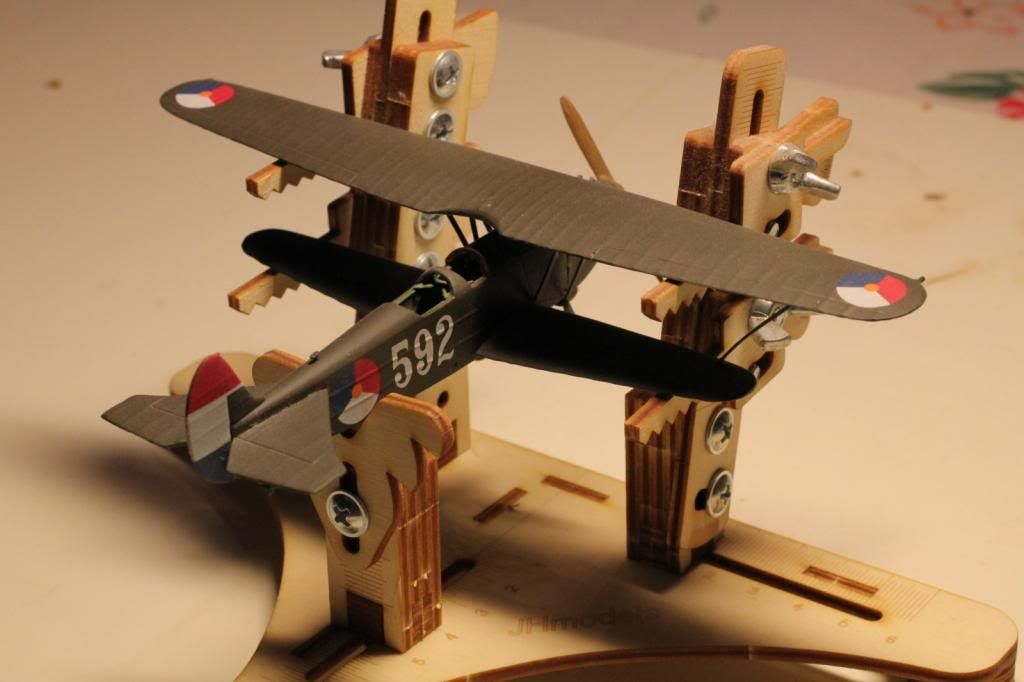

The vertical wing supports at both sides of the fuselage can be put at the right angle allowing the leading edges of the wings to positioned correctly to eachother. Then the angle of attack on each wing can be set as desired. If you have positioned the back support correctly now you can glue the fuselage to the bottom wing and after that glue the top wing to the cabane and wing struts. You can then leave all glued joints to dry as long as you wish having all parts in the correct postion. This is all theory, but this is how it should work.

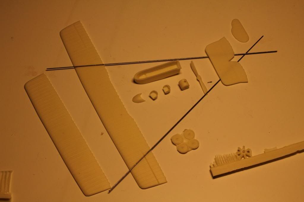

Now onto my ideas for using this jig on the Farman HF 20:
The kit comes in a lot of resin parts and 2 steel rods to connect the wings to the elevator and rudder (similar to the DH2)

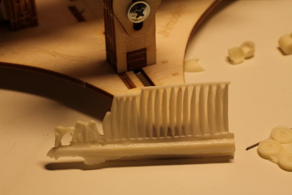

You also see a rather poorly detailed fuselage, but as far as I can judge this the shape is correct. On the internet I found some really helpful 3D drawings made by DraganSaler (copyright 2004 and 2007) (follow this link) These drawings will help me put some detail on the inside of the fuselage. There is a replica of the HF 20 in the Luchtmacht Museum in Soesterberg, but at present they are moving and have stored this plane. Besides that I expect that compromises will have been made.

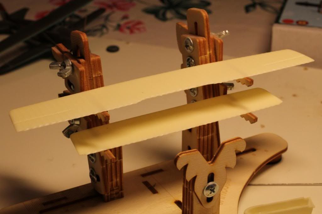

But back to the jig:
I plan to first position the wings correctly above eachother and then glue all struts in between:
I am not particularly pleased with resin struts as I expect them to be rather fragile, but because there are so many I hope it will be enough.
Then the fuselage can be glued to the bottom wing and the elevator should be positioned correctly on the back support.
Then the 4 steel rods between the wing assembly and the elevator can be attached. After that it is just painting, decalling and rigging  ;)
