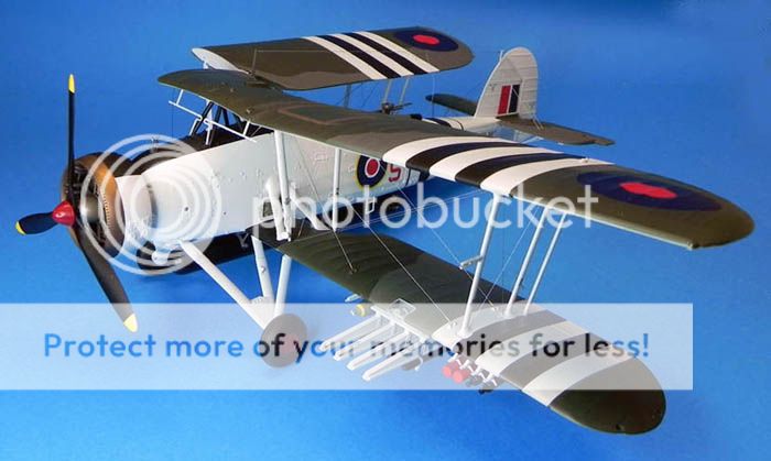

I haven't built the Tamiya Swordfish yet but this is my Trumpeter 1:32 kit where I used monofilament and brass tubing.
I was very pleased with the look of the monofilament and of course, you always get the benefit of increased structural integrity when using it too. In 1:48 scale it will look even that much better. Frankly, I dismissed the idea of using the PE lines for the same reasons as laid out by PrzemoL.
