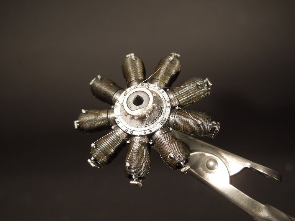

« Reply #54 on: April 14, 2013, 05:23:29 AM »
Hi friends,
after a very pleasant week in La Palma, Canary Island, iI am back and almost finished my work on the Oberursel engine. As references I used the very useful Fokker E III walkaround from the Science Museum, London that I found here: http://www.primeportal.net/hangar/mark_hayward/fokker_eiii/
First, I painted the Enine and the cylinder in XF-1 Flat Black.
While cutting from the sprue, the ring that is part of the egnition distributur got  damaged and had to be restored.
The next step was to paint the cylinder block in Alclad Chrome, using a template for airbrushing. The coat was polished and treated with MIG Metal Pigments later on. I am sorry, but only a little of the shiny effect is visible on the pictures.
« Last Edit: April 14, 2013, 05:55:35 AM by dirk »
Offline dirk
  • Posts: 246
Re: Fokker E.II 69/15 Kurt von Crailsheim
« Reply #55 on: April 14, 2013, 05:30:26 AM »
The next step was to treat the cylinders with MIG Metal pigments, rubbed into the surface with my fingertip.
Agama Burnt Metal paste was added to the base/mounting of the cylinders for some contrast.
The effect after some polishing:
Valve levers were painted with Alclad Polished aluminum and Chrome for the bars/handles.
« Last Edit: April 14, 2013, 05:56:59 AM by dirk »
Offline dirk
  • Posts: 246
« Reply #56 on: April 14, 2013, 05:39:22 AM »
While watching the cylibnders on the walkaround, I had the idea to simulate the burned coloured effect by using yellow and Red Oil Paints. To create a more subtile effect, the paints were blended by using white spirit later on.
Valve levers were mounted and receive some brass by using "decanded" Alclad Pale Gold by brush.
Ignition cable were added by using 0,05 copper wire, by using clamps, gravity helps to keep them under tension while glue sets.
« Last Edit: April 14, 2013, 05:57:54 AM by dirk »
Offline dirk
  • Posts: 246
« Reply #57 on: April 14, 2013, 05:43:00 AM »
The last step was to add the decal and some washing with brown and black high diluted oil paints.
With greeting from Germany,
Dirk
« Last Edit: April 14, 2013, 05:59:14 AM by dirk »

« Reply #58 on: April 14, 2013, 08:20:25 AM »
Dirk awesome work on the motor. Thanks for the step by step. The subtle weathering is very impressive and hits the mark perfectly!!

« Reply #59 on: April 14, 2013, 10:11:55 AM »
I promise I'll try to feel bad as I shamelessly steal every bit of that engine detailing technique!  ;D
Thanks for the great tutorial, Dirk.
