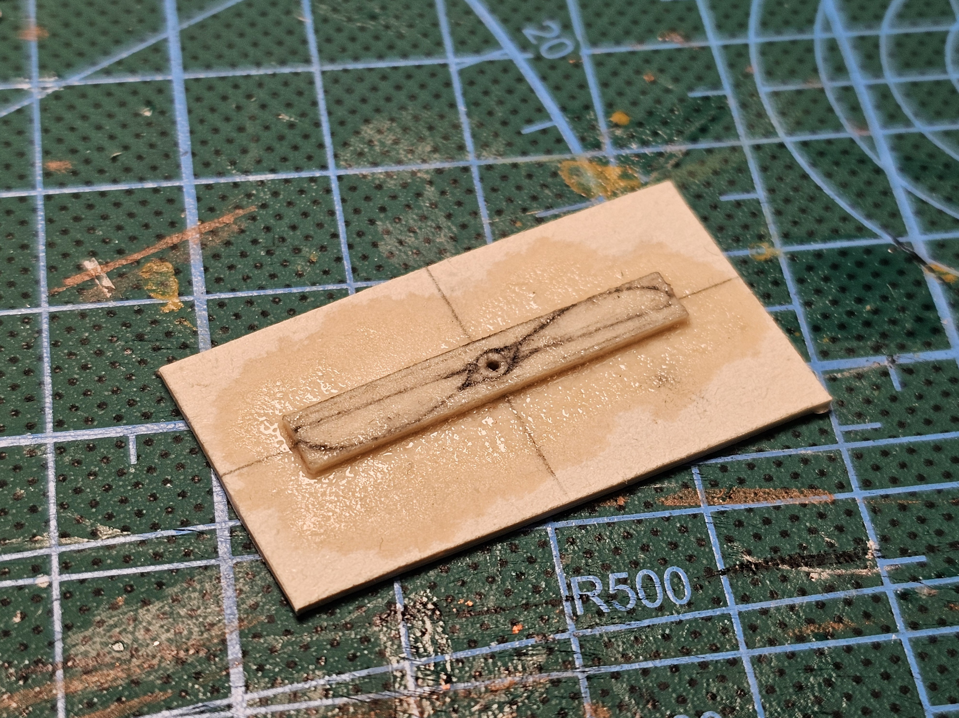

Some work-in-progress photos below

I looked more closely at the pictures of the wing being made.
Do you use two pieces of paper - one for the upper and one for the bottom of the wing with a built up inner structure?
It looks that way but the pictures of the finished model show a very thin delicate wing. The internal structure must be quite thin itself. Does it provide enough stiffness that it provides the curvature to the wing or is that a result of careful alignment after the CA is applied but before it hardens?

Indeed, beautiful and eye appealing.
cheers, Graham
Yes you're right, that's two pieces of paper, I adjusted the thickness of paper to control the strenth and the translucency of the "fabric cover".
You should shape the paper parts before apply the super glue.
Although I used super glue to bond the upper cover with the super-glue-hardened lower cover and wing ribs to raise the translucency of the whole wing part, in this case super glue is used mostly as a "stiffener", not as an "adhesive".
EDITTED ERRATA
It's not built up inner structure. The wing ribs are bonded with the lower wing cover.
Bai

Is that prop glue-hardened paper?
And can you post a picture of the alcohol based UHU you mentioned?
Joachim
Sorry I forgot to reply you Joachim! UHU in your picture is the UHU glue I mentioned, I found that UHU is more efficient than white glue. UHU glue has a low water content, so it hardly causes paper to absorb moisture and warp when applied. Now I mainly use UHU for card models now.
Yes the propeller is made of glue-hardened paper card. When it was hardened I used a knife to carve it into the shape of propeller, then sand it. It's really hard and tough to carve,but it's also very strong once finished.
